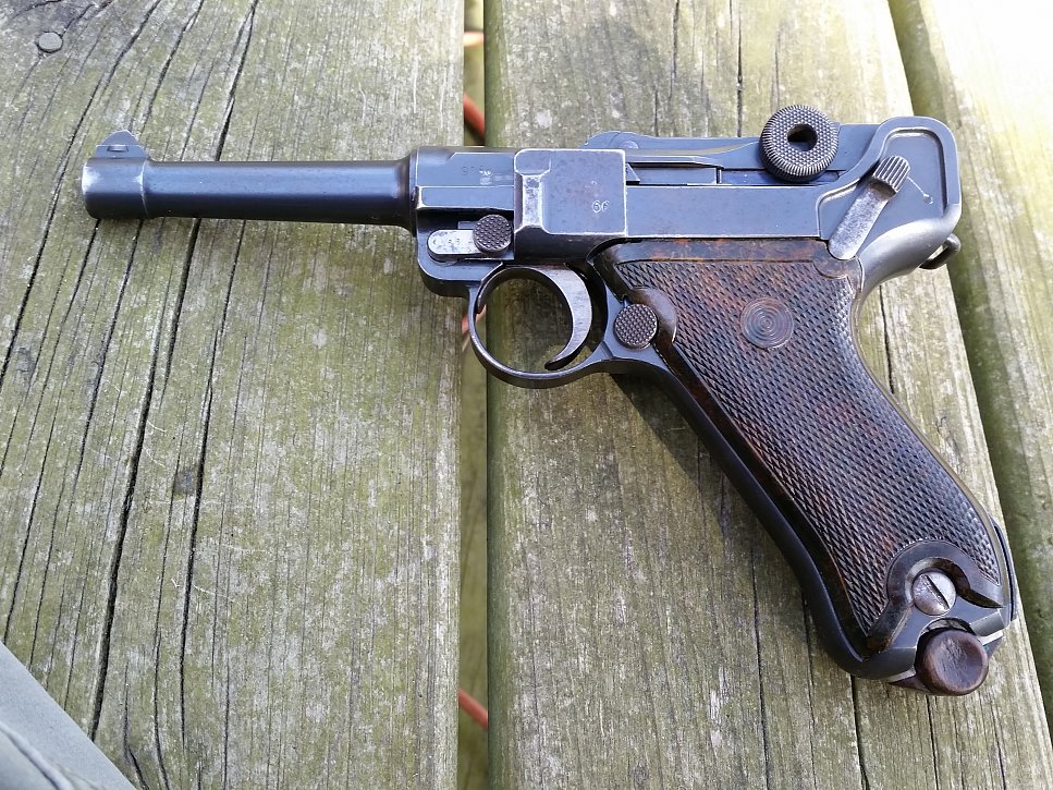

Unread 03-26-2018, 06:25 PM   #16
kurusu
Join Date: Sep 2007
Posts: 1,225
Thanks: 2,679
This is a 3-handed job. (BY all means, keep that baby pointed downrange!) Didn't John Martz invent something for this? Anyway, a 1916 should have a relieved sear bar, which allows manipulation of the action while the safety is on.
Can be done with two hands. Learned how to do it to clear this type of jam while competing.
1 open the action the usual away.
2 use your right hand to keep the action open like on photo.
3 your left hand is now free. You can push the cartridge back into the magazine with your index and release the magazine with your thumb. You can now easily remove the spent cartridge from the chamber.
Once in a while I had this type of jam. Not because of stovepiping but because the extractor released the case early leaving it halfway out the chamber(it was ammo related).
First time it ocurred was in a match. I had to declare an alibi, that cost me 2 points penalty, in a 5 minute 5 shot string because I couldn't clear it alone.
When I got home I decided it wouldn't happen again. So I developed this method.
The following 8 members says Thank You to kurusu for your post:
