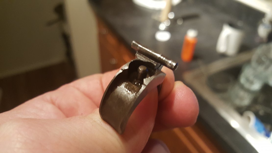

The trigger on a Luger should not be moving sideways once the spring is seated, and the side plate is installed. What does your trigger return spring look like?? Sound like your spring has been replaced, as std. Luger trigger return springs apply a good bit of forward tension to the trigger.
What does the trigger look like out of the gun?? I am wondering if yours has an inordinate amount of wear. Remove the side plate, the trigger and return spring, and give us a photo of the parts, and the area where they install. Perhaps we can find the problem.
Lugerdoc(Tom) has trigger return springs I believe. I fear that there is more to your problem than a return spring, but the photos will help decide.

Ok gentleman, I am back from being out of town with a video of the trigger issue I'm having on my 1918 dwm and a few pictures, not sure if those will help. Anway, brief overview: I get this weird clicking when I pull the trigger but it doesn't seem to happen when I have it all the way pushed in. It's a little sloppy and slides around a little (as seen in the video) but it was a little better when I put my BYF spring onto this one... so I definitely need a new spring... but I'm still having trouble figuring out what's causing it to be so loose and what the clicking is from. I put the DWM side plate on my BYF and no clicking, so I don't think it's that. Anyway, here they are:
