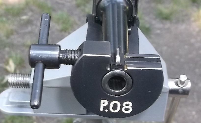

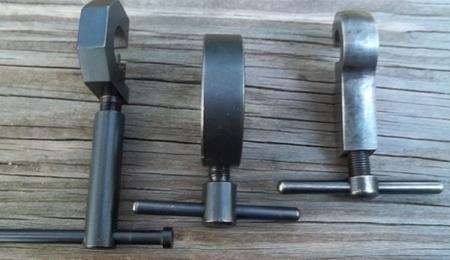

These are three P.08 sight adjust tools I have collected over the years.

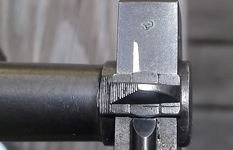

Yes, the left one has a very small Swiss Cross on on top near the blade pusher. I will try and get a photo of it tomorrow if I have time after work. The right one is unmarked and fits the slim taper barrels. ie. GRN & M2
I will also try and show the fit of each around the pistol barrel bands.

Each tool is specific to a style of barrel band and sight block. A tool for the pencil tapered 7.65 mm barrels would not admit a larger barrel band from a P.08.

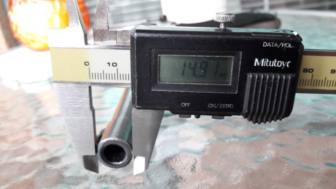

I have a 9mm x 120mm Tikkakoski [don't call it a 'Tikka'!] Luger barrel in front of me, with the 'square' sight blade. The front band measures .5990" or 15.22mm perpendicular to the blade. Vernier measurement, and the band tapers slightly so that is an aggregate measurement.

Mario - I commend you on your restraint!
Interesting. I just measured my 2 Mauser P.08. .587 and .586. The inside of my P.08 sight pusher is .590.
Can I bother you to measure from the bottom of the barrel band to the beginning of the sight dovetail? In the P.08 it's around .611(hard to measure ).
The tool measures .618 from the bottom of the hole to the base of the pusher.

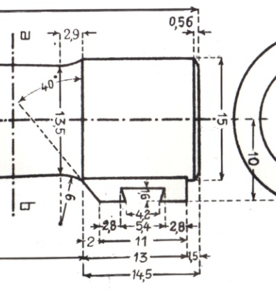

All, the front sight band and dovetail notch dimensions are clearly dimensioned on the P.08 blueprints.
The measurement from the bottom of the barrel band is 17.5mm to the top of the front sight ramp, and the notch is 1.6mm deep. The top of the dovetail notch is 4.2mm front to back and the bottom of the dovetail is 5.4mm.
I suggest you buy a copy of the blueprints (shameless plug) and they will come in handy for discussions and projects like this one.
You can PM me for purchase instructions or see the Blueprint CD thread in the FOR SALE forum.
Here is an extract of the barrel blueprint as an example
