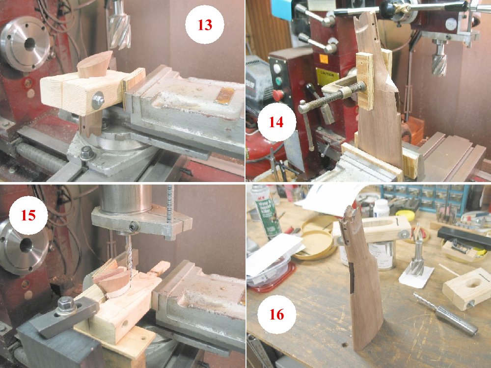

Waiting for new end mills, cutters, and other miscellaneous tooling, so I'm switching over to the rear sight modifications.

I'm using the M24/30 FN Mauser carbine rear sight but I'm going to shorten the sight leaf. I found out the hard way that it is hardened. Anyway, after cleaning up pieces of broken end mills, I managed to use a Carbide end mill to mill the end and pivot slot of the sight leaf.

(14) Clamping stock pieces together to mark gooseneck for slot.
(15) Milling 3/8" slot in gooseneck.
(16) Pieces slotted and stacked to admire.
The slots have been milled at different angles, so the filler piece cab be wedge-shaped. Maked fitting easier.
