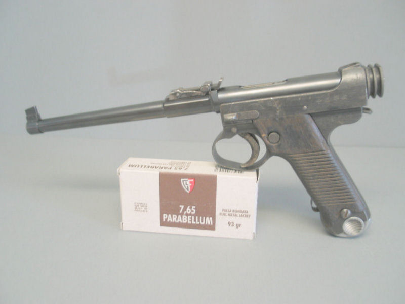

I got the barrel assemblies back yesterday and this morning I tried to take some pics. Hazy overcast, but too windy. Couldn't stand anything up for pics, so I moved inside. Crappy pics but if I can get good outdoor weather I'll replace these later.
I tried to find some light colored background material in ~ 2' x 3' sizing; Wal-Mart had nothing, Office Max only had gray foamboard. I bought a 2-pack of that, but it is not a good background. The guns fall over occasionally while shooting the images, and leave a white dent.
The refinishing turned out pretty good. Not quite how I'd wanted it, but beggars can't be choosers.
I left the original receiver 'sights' [notches really] on both pistols, as the uppers are swappable with the OEM ~4" barrel/receiver assemblies. The Nambu as mentioned on pg 1 is in 7.65 Parabellum caliber as that cartridge has approximately the same characteristics of the 8mm Nambu. The Lahti is in 9mm Parabellum and is fitted with the accelerator. Both are fitted with artillery Luger rear sights.
An amusing exercise in fantasy fabrication.

Tried two more shots, pistols lying flat on gray foamboard...Too late in the morning, the clouds are reflected in the flat surfaces...

It's not about garnishing applause. It's about showing what can be done on a budget by a moron with a milling machine. A cheap-ass Chinese piece of sh*t actually. (The mill...not the moron)...
I'm trying to motivate others to roll their own.
I'm surprised you weren't temped to either slot or add a stock lug to the Nambu ...
One model of the Nambu (not the Type 14) used a Mauser-like stock-holster with a telescoping attachment. But the backstrap on the Type 14 is too thin (~.165") to mill a slot like the C96 has. Something could be brazed or welded on but that would destroy the profile and be even more uncomfortable to handle and shoot. So I ditched that idea.
But a Walther P38 could have a backstrap made that would hold the mainspring & guide and have a straight slot. Martz did exactly that with his P38 carbine conversions. I may try that, sometime in the future.
I have about a dozen unfinished projects sitting on my shelves, waiting for stock, or tooling, or just plain money. The Nambu can sit for a while...Maybe years...
