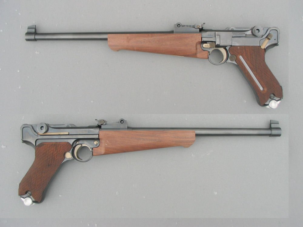

This is the latest in my series of Gonzo long barreled military handguns. The previous two being based on the profile, dimensions, and rear sight of the LP-08 'Artillery' Luger pistol. This one is actually based on the P08 Luger, but the barrel will be longer than the 'artillery' model, and the rear sight selection is still undecided.
This particular project was inspired by a 'prototype' 7.63 C96 Mauser-chambered conversion done by Herbert Werle some time back and sold on Hermann-Historica. It uses a shortened 7.65 caliber Mauser rifle barrel with OEM front and rear rifle sights, adapted to the Luger frame, and re-chambered. I kind of liked the idea, but the sights are a bit too big for me, and I'm not fond of stepped barrels.
Here's two pics of Werle's excellent conversion -
I'm going to emulate his idea, but slightly different.

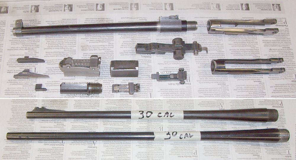

First pic is of some of the available parts I have on hand.
Two barrels are Remington 700 30-06 cal barrels; one is a Winchester 30-06 Mod 70. The resulting long barrel Luger will be chambered in 7.65 Parabellum [30 Luger]. The top [Winchester] barrel has already been fitted with several rear sight assemblies. The top pic has an 1891 Argentine Mauser carbine rear sight fitted. The front sight and band is from the 1891 Mauser carbine as well. Shown below that barrel is an FN M24/30 Mauser carbine rear sight, a Luger artillery rear sight with two different dovetail mounts, and a Martini Cadet rear sight.
The [Winchester] barrel shown with the 1891 Carbine sights mounted has already been chambered for 7.65 Parabellum and threaded to fit the Luger P-08 receiver pictured.
Next pic is of the above mentioned barrel with the 1891 carbine rear sight mounted [top] and the FN rear sight [below]
Both will fit (22mm barrel) as will the dovetail mount in the pic above this one. At this point, I am leaning toward the 1891 Carbine sight but the FN Carbine sight is more attractive and quite similar to the Luger Artillery rear sight in construction. I'm considering shortening both the sight leaf and the mount and utilizing that sight.

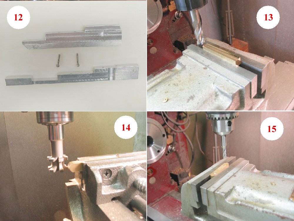

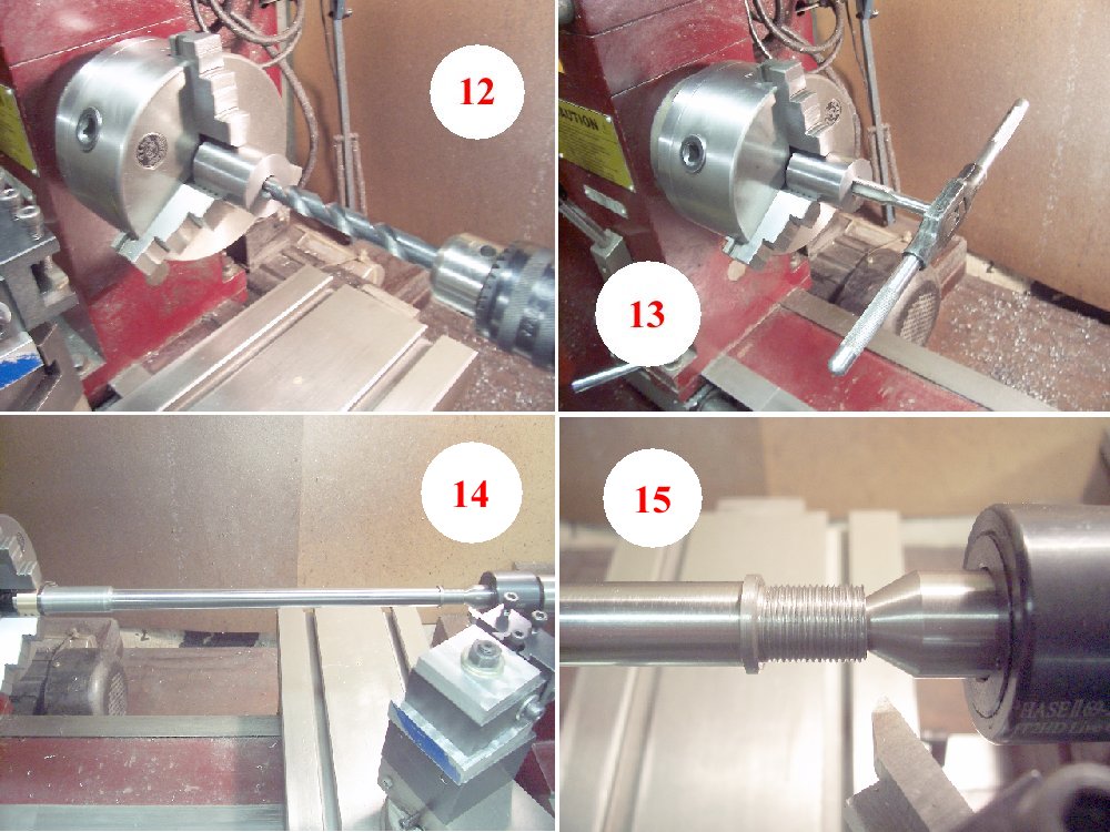

(12) Drilling out sight base blank.
(13) Tapping sight base blank to 1/2" x 28tpi.
(14) Threading muzzle tip to 1/2" x 28tpi. Bevel linking barrel taper to rear sight base is also cut (10º).
(15) Completed thread.

Side view of how it might look...If I don't screw it up...

Got all my long-barrel pieces assembled, and doing a trial fit of the forearm. It still needs work (or maybe a whole new forearm) but it seems to be coming along...
I'm not a woodworker, so it's definitely rough. However, the pic shows my Gonzo cartridge-counter grips and modified magazine, the scalloped toggle knobs, the Tomek magazine bottom, the strawed parts, and the new blueing. It started to snow while I took these pics, so I didn't have time to wipe off oily fingerprints...
Modified Remington M700 30-06 barrel chambered in 7.65 Parabellum, shortened FN/Mauser carbine rear sight, custom front sight.

(13) Milling brass inlay to size.
(14) Rounding ends of inlay.
(15) Drilling & counterboring inlay for attaching screws.
(16) Finished forearm and brass inlay.

Here's a pic taken in the early hours of an April morning, outdoors, of the assembled finished 'carbine' with attached stock. All Gonzo - scalloped toggle knobs, 'cartridge counter' grips & modified Tomek magazines, Mauser rifle rear sight, and generally rough barn-job fabricating.
7.65 Parabellum caliber. I have no idea if it will even shoot. And I don't care.
