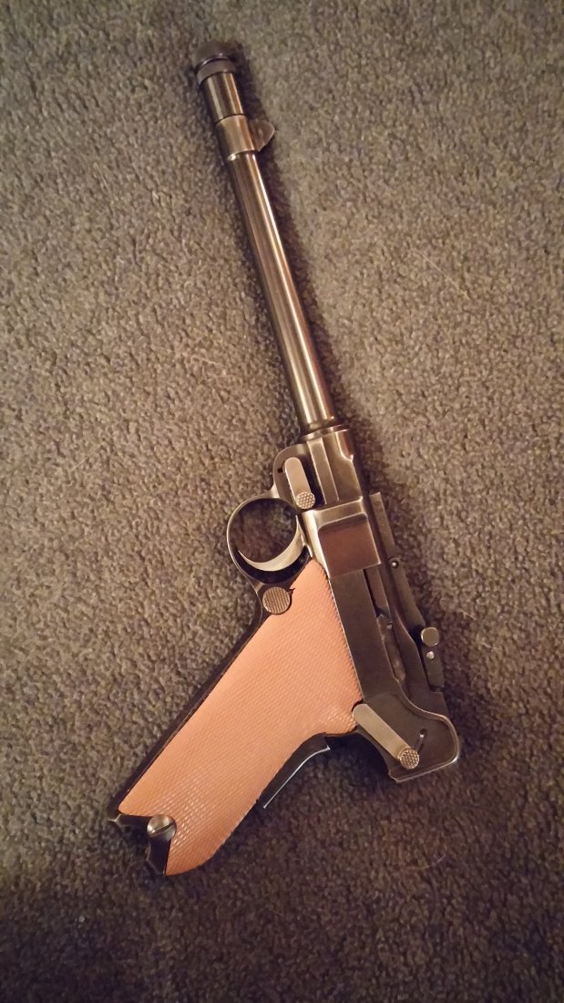

Here's a pic of mine. The other pic is my Ibanez P-bass knock-off, finally complete. It was missing the "ashtray" covers when I bought it 20 some years ago. The frets were literally falling out, and I installed new ones and leveled them, then had the Ithaca Guitar Works crown them and do the final setup. I had looked for replacement covers back then, to no avail, at the local shops--one even specialized in vintage stuff, and the Ibanez dealer couldn't help either. The internet makes such searches a lot easier, and I was able to come up with a OEM set by Fender for twenty bucks shipped, in about ten minutes.

Without the adapter sleeve my liner would fit a barrel around 7" long, stopping short of being OK for an Arty barrel.
