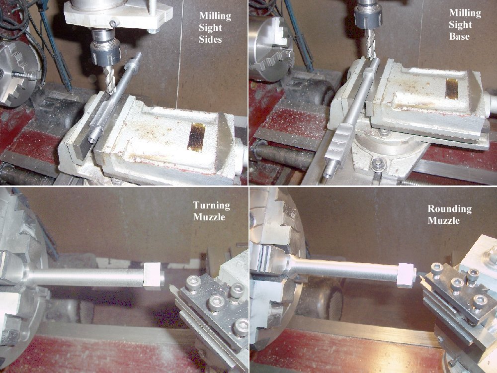

Sometimes you get ahead of yourself...Which is what I did here...I left the muzzle nice & long to chuck it, but forgot that I needed to finish the muzzle [turn to dia, round, and crown] before milling the sight bases round...So I had to cut the excess off and finish the muzzle...
I used a 4-jaw chuck. Took about a half-hour to get the barrel centered.
I don't recommend this setup; I don't like the end being unsupported while it is being turned, but due to CRS it turned out this way. I took very small cuts and slow manual feed, and it turned out OK.
The centering in the 4-jaw is a PITA. It has taken me an hour in the past, to get it down to +- .001". This time I clamped a 7.6mm ground pin in my tailstock Jacob's chuck and hung the barrel on that, and ran the jaws of the lathe chuck up to the barrel for a rough centering. Then it was just all trial & error with the dial indicator to get it 'just right'...

Finishing up the muzzle. Clamping the barreled action in the mill and cutting the base, cutting the dovetail, and fitting the rear sight base. Worked out pretty well, I think. I'm using a Luger artillery rear sight. Doesn't look too bad.

First pic is just a mockup of artillery sight on blank; next is trimming back the excess metal where the sight mounts; third is cutting the barrel taper, a long tedious manual task, fourth is the tapered barrel, lightly polished, with sight mounted to see how it looks...
I am not a metal finisher, so there will be rough machined surfaces. These should blend in well with the rough Japanese machining...
Other pic is the polished taper...Compare with pic in previous post...
It's getting there...

I'm using the rotary indexing head now. Cutting the front sight base, cutting the rear sight base major diameter. Very tedious work. 4º cut at a time. (One rev of the indexing crank).
I'm not happy having to set the indexing head & chuck on one end of the barrel and do my cutting at the other end. But there's no room behind the work table, and the indexing head only has right-hand crank.

Here I'm cutting the muzzle back 3/32", crowning, facing, and chamfering. Then it's on to the barrel vise. I had to stop and make a different vise insert, with a tapered hole, and modify my previous vise insert by milling 1 1/4" flats on the sides to fit the receiver. I put a 'notch' on the Nambu receiver to facilitate alignment. Finally, looking at the mounted barrel.
Still mulling over milling 'flutes' on the sides of the rear sight base. Front sight base has to be milled down .050" for the front sight blade, and a dovetail cut.

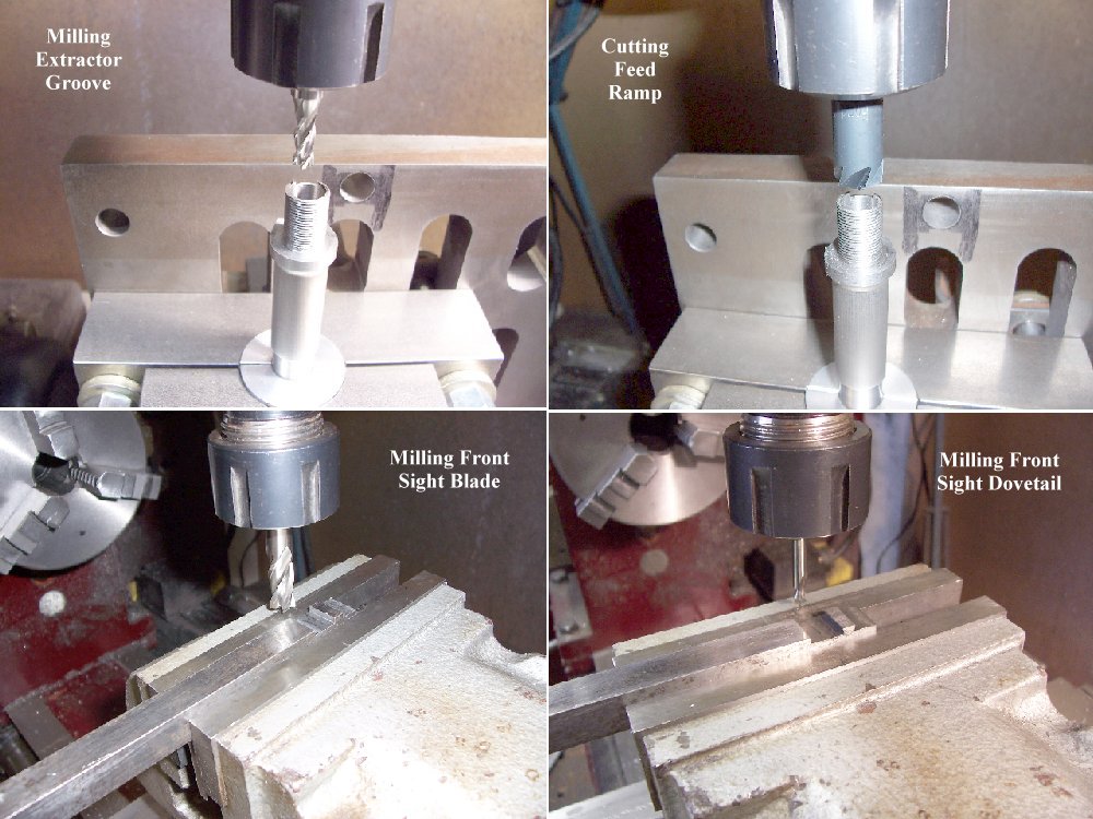

I had an eBay vendor renege on a sale, so I had to hunt down some parts I need elsewhere...I'm waiting for parts from three eBay/GB vendors, a Brownell's order, a Numrich order, and a Travers tooling order. Backorders galore!
I managed to get the front sight dovetail cut, and milled the 'scallops' for the rear sight. Not quite like the Luger artillery, but 'good enough'...
Next I need to drill out the Luger rear sight blade & base for an inch pin (no Metric available) and drill a dimple for the re-drilled base setscrew (inch again, no Metric available).
For all practical purposes, the barrel itself is done. I do need to mill a front sight blade and press it in place, and then mill it to shape. That will come next.

Although I had said the barrel was 'finished', I forgot about the extractor notch and the feed ramp...I finally got the chamfering cutter I wanted to cut feed ramps with...
Machining the front sight blade and pressing it in place and final machining is shown in next pic...

Continuing to machine the front sight blade in place...
Blade height fixed & milled; squared off front sight blade; milling the 'ramp' on the blade.
Second set of pics is the finished faux front sight blade. I set the height of the front blade equal to the height of the rear sight, as that is how my Luger artillery rear/front sights measure up. I assembled some of the special tools I had to make for this project. Finally, a shot of the barrel being torqued in place in the Nambu receiver [barrel extension], using three of the special tools.

- Nambu receiver/barrel extension has a 2.5mm x 8mm flat milled next to barrel shoulder for alignment purposes (second pic)
- 120º chamfer cutter used to cut feed ramp
- 40º Harvey dovetail cutter used for front sight blade; 60º dovetail cutter used for rear sight base
