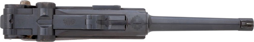

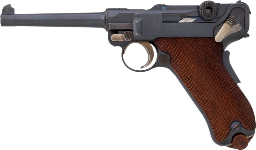

Hello friends,
I am looking at a 1906 DWM Swiss Commercial SN 48877, BUG proofed on barrel, BU proofed on left side, short frame, 7.65, unmarked wood mag, with what appears to be all original finish. I believe the SN falls in the correct 35000-55000 range for this scarce pistol (only about 1000 were made)?
I am thinking of trying to buy this. I know about WWI guns, but not so much about 1900-1906 models, so I need some expert opinion on some areas of concern. Basically I need to know if it looks all original (I know you can't always tell from pics, but I think it is).
1. The barrel has a second SN stamp (173xx) - what is this?
I have seen this on some other 1906 Swiss - was it done when they put the BUG proofs on it?
2. I did not think a commercial gun should have barrel SN halos - am I wrong? The pistol SN on the barrel has halos (the other number does too, but if that was part of the BUG proof, then it makes sense that it would have halo).
3. The safety area that is ground white looks fat and short to me. Most of the other ones I've seen are a little narrower and extend up past the dimple in the frame. But it is rusted/tarnished in that area so it appears old.
4. Grip safety looks very clean with almost no wear, but the bore is very good too.
5. The holster is definitely not original, but what is it? Late 1920s commercial?
Thanks,
- Geo

http://historical.ha.com/c/item.zx?s...05&lotNo=32250
BU proof stampings look very light on the left side. might be a redo.
pin thru toggle knob looks blued. might be a redo.
the 173,xx is the old way of indicating the barrel is in 7.65 caliber.
since the gun is a civilian gun and not military, the holster in the photo may be one for a civilian buyer. military holsters have swiss proof markings, under the closing flap.

So that's what he second number is on the barrel. It really fooled me because it is 5 digits like the SN and it is above the SN (all military Lugers I have seen have the bore dimension under the SN).
It might be a redo, but -
The toggle retaining pin does not look blued to me. Don't you think that could be dirt or rust in the groove? Do you think someone would file the pin down and not scrape the blue out of the cracks?
And there are halos on the numbers under the barrel. Doesn't that show it is original?
It says there are no markings on the holster, so I assume it is commercial or a repro - the holster looks new so it could be a repro.

The one good thing about "that auction site" is that they provide big enough pictures to make good determinations about their pistols. For instance, if you know how to see you can tell that the really interesting bargain commercial Lugers are long-ago refinish jobs--very nice ones--and will probably bring what they are worth.
Be very cautions about the Weimar navy Ostsee gun.

Dwight - So are you saying this one is a long ago refinish? And do you like it?
"Diplomacy is the art of saying nice doggie, until you can find a rock."
- Will Rogers
Unread 12-02-2013, 11:26 PM   #11
Yes. And kinda, but I am not in the market for a refinished Luger.

Lugerdoc -
Were the Commercial Lugers regularly refinished as well?
In other words, could this gun have been professionally arsenal refinished, in your opinion?
- Will Rogers
Unread 12-05-2013, 07:08 AM   #17
Apoligies for stealing Tom's question--Commercial Lugers are dealt with as any given owner might like. "...professionally arsenal refinished..." is a rather meaningless term here. Anyone who would do the work for hire would be a "professional," regardless of their knowledge or skill level. "Arsenal refinish" is a too-broad term under any circumstances, and has no relevence to a civilian firearm.
Refinished is just refinished.
