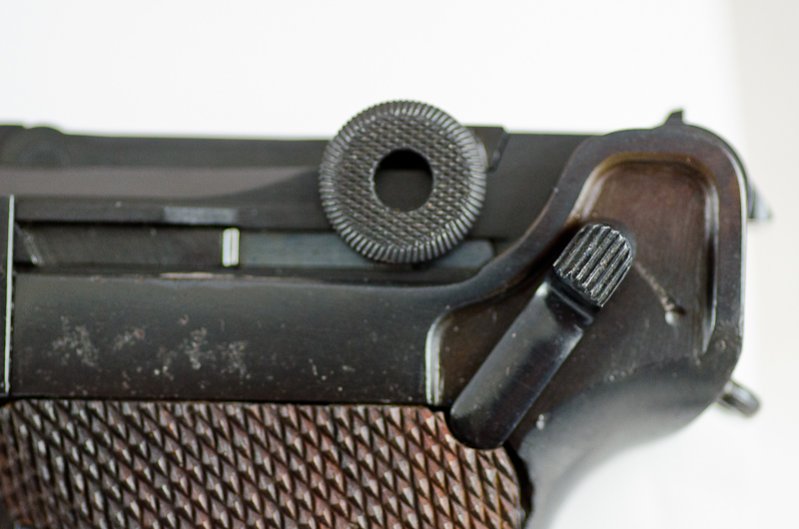

Unread 02-23-2013, 01:15 PM   #7
trekster
trekster's Avatar
Posts: 8
Got some pictures taken of my P08. This first one is a close-up of the "mark" I would like to identify. There is also another "mark" to the lower left of it, but it is almost incomplete.

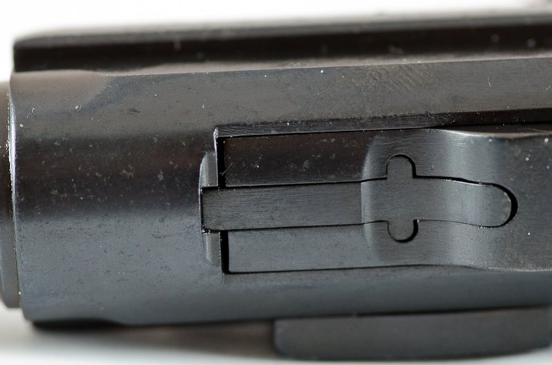

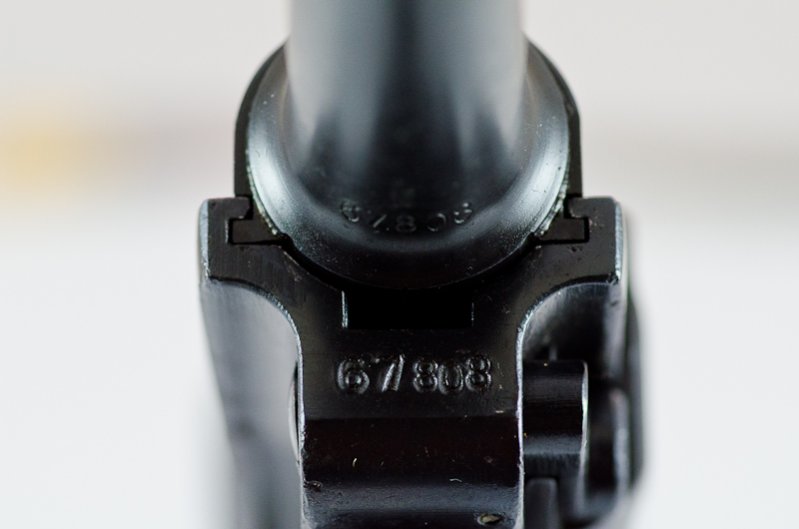

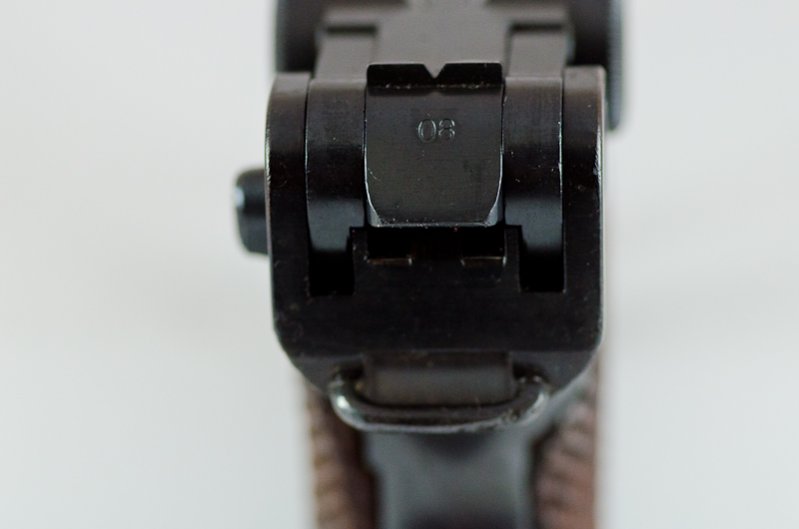

Unread 02-23-2013, 01:22 PM   #8
trekster
trekster's Avatar
Posts: 8
Here are additional photos of this item. I really look forward to hearing from those who might be able to give me some information about this particular piece.

Unread 02-23-2013, 03:31 PM   #10
Wilhelm
Wilhelm's Avatar
Join Date: Oct 2007
Location: Maryland
Posts: 368
Thanks: 49
Thanked 140 Times in 61 Posts
East German rework imported by Sarco back in the very early 90's. Nice! I would bet that someone changed out both the grips and magazine on yours somewhere along the line. It also looks like they tried to obliterate the importer stamp and cold blued over it. IIRC, they sold for $475. I bought one and have loved it since!

Unread 02-23-2013, 03:55 PM   #11
trekster
trekster's Avatar
Posts: 8
Thanks for the info, appreciate you taking the time to look it over. Of course as you might imagine, your info sparks more questions in my mind.
1) Could you tell me a little more about what you mean by "East German rework"? What manufacturing plant, or who might have done the work? Did they always start with commercial pieces? What sort of rework would they have done?
2) If it was imported by Sarco, is it safe to say that it could NOT be a "WWII bring back"? What tipped you off that it was imported into this country by Sarco?
3) I was pretty certain the magazine and grips were added by someone. Also, it appears it was probably reblued at some point. Is this the type or "rework" that was typical to occur before it was imported, or after it was imported?
4) The bore is pretty good; about what you would expect for a piece this old. Given that the numbers match with the exception of the magazine, grips and the one safety piece - what would be a range for retail value, in today's market?
trekster is offline   Reply With Quote
Unread 02-23-2013, 04:04 PM   #12
lugersrkewl
Join Date: Feb 2012
Location: Ussr
Posts: 425
Thanks: 198
Thanked 75 Times in 58 Posts
the sunburst is a vopo mark and the other is a rampant lion.....Bulgaria and Spain and England use them but I am unclear as to the origins, uses , and explanation of rampant lions.
shooter grade 400-700 if its 30 luger lower end, should have had the bbl changed to 9mm if east German reworked.
