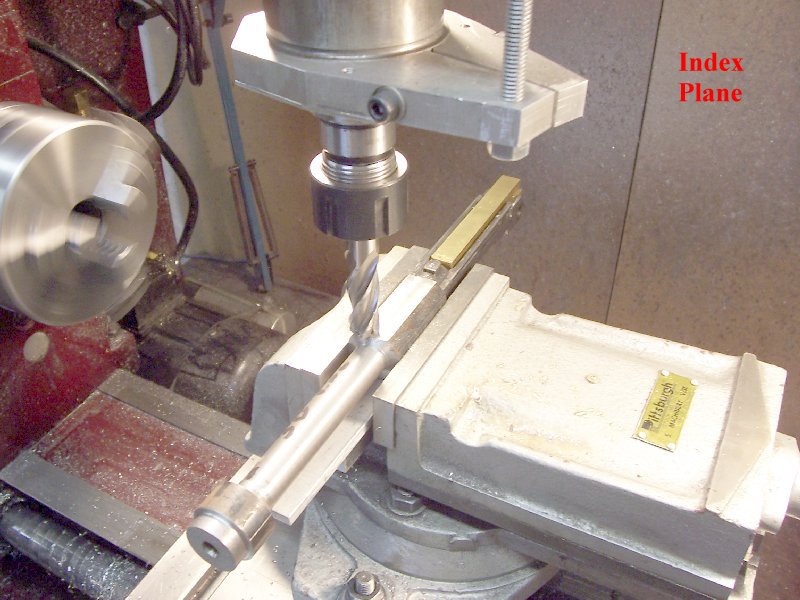

OK, I burned a vacation day...Not finished yet, but I'm starting to feel groggy...9+ hours on this...
Unread 03-26-2011, 08:41 PM   #8
This won't be an exact clone...I'm going to use a Broomhandle rear sight (shortened 3/8") and I like the Luger 1900 front sight base with a Finnish style front sight blade.. .

A bit more today...
Unread 03-27-2011, 05:38 PM   #12
More...

Originally Posted by TennBill2 View Post
Anxious to see how you finish reaming with the receiver on. I'm about at the same point, don't really want to spend $40 or so for a one off. Upside down 3/8 extension too big.
Clymer's sold an extension, fits between that floating reamer holder in the pic and the, er, reamer...but as you pointed out, it won't fit in the Luger extension...So I bought a 6" Craftsman 3/8" extension and turned it down to fit...(Carbide cutter)...
