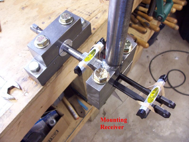

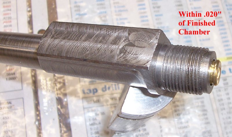

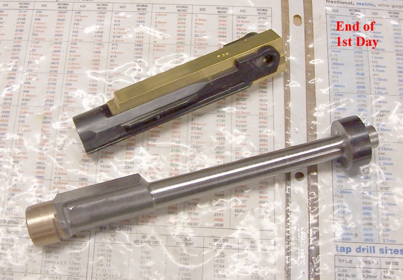

OK, I burned a vacation day...Not finished yet, but I'm starting to feel groggy...9+ hours on this...

This won't be an exact clone...I'm going to use a Broomhandle rear sight (shortened 3/8") and I like the Luger 1900 front sight base with a Finnish style front sight blade.. .
