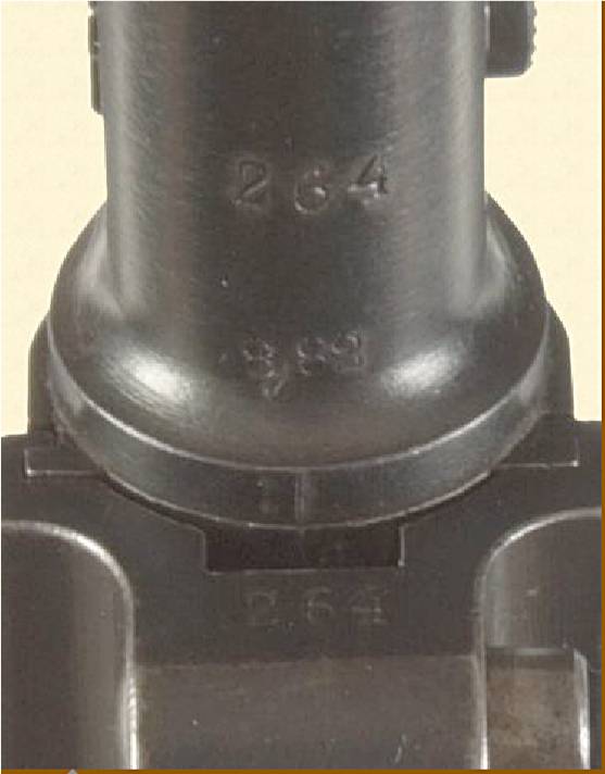

Jerry,
The blue looks original to me. The barrel S/N halo is there. The straw is weak, but appears to be present. The photo of the top shows high edge wear on the sight and barrel extension.

I have to go with Ron on this one. Some of the photos are a bit dark, showing the blue to be a bit more blackish than it really is. The lines are crisp and clear, halos are present and the overall wear seems to be consistant with age.
The takedown lever looks dark indeed, almost as if it was blued but this can also be a result of reflections (had the same problem trying to photograph pistols with small parts that had no strawing left).
The grips look like late war beech versions to me.
Of course, one has to inspect a pistol up close and personal to be sure, but it looks good to me.

'Fraid I have to go with Ron's assessment also. Looks like just a real nice gun with correct beech (Buchenholz) grips. I have found that these late war light colored grips can be numbered to the gun, have only misc. Imperial/inspector's markings, or no marks at all.

Lately, the photos on Simpson's site have been underexposed. I lightened up a couple of them for this rig.

I think that not only the thumb safety but also the magazine release also has been blued. The pictures are just too dark to check out the rest of this artillery Luger. Dons lightened pictures of the front of the receiver and under the barrel look good though. But $3450 for this arty? I think not.
