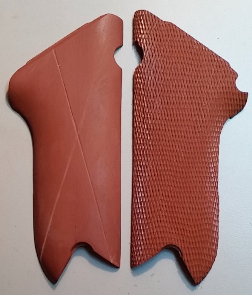

Same deal with the 29/70 Swiss style frame I bought a while ago. It's like gripping a rough cut 2" X 4" and the checkered pattern was embossed into the web of my hand after a few shots! I sent them to a place that does cast urethane grips and had them reproduced in that material. The outfit will make you a set for free if you send in grips that they don't already have molds for.
I reduced the thickness of the repros and re-checkered them 20 lpi, and they're comfy to use for shooting, while preserving the originals. I even had them take a shot at matching the color of original "red Swiss" grips, and they came pretty close.
I doubt they have molds for the 06/73, so somebody who's the first one to send some could probably get the same deal. Unfortunately, you'll have to resurrect contact info for the cast grip place since I've lost track of it. IIRC, it's in Florida and run by a woman.

Yes, it's true about their flat profile. But since the original Mauser grips are extra thick on the frame, there's plenty of meat there to round them, as I did with my repro urethane ones.
