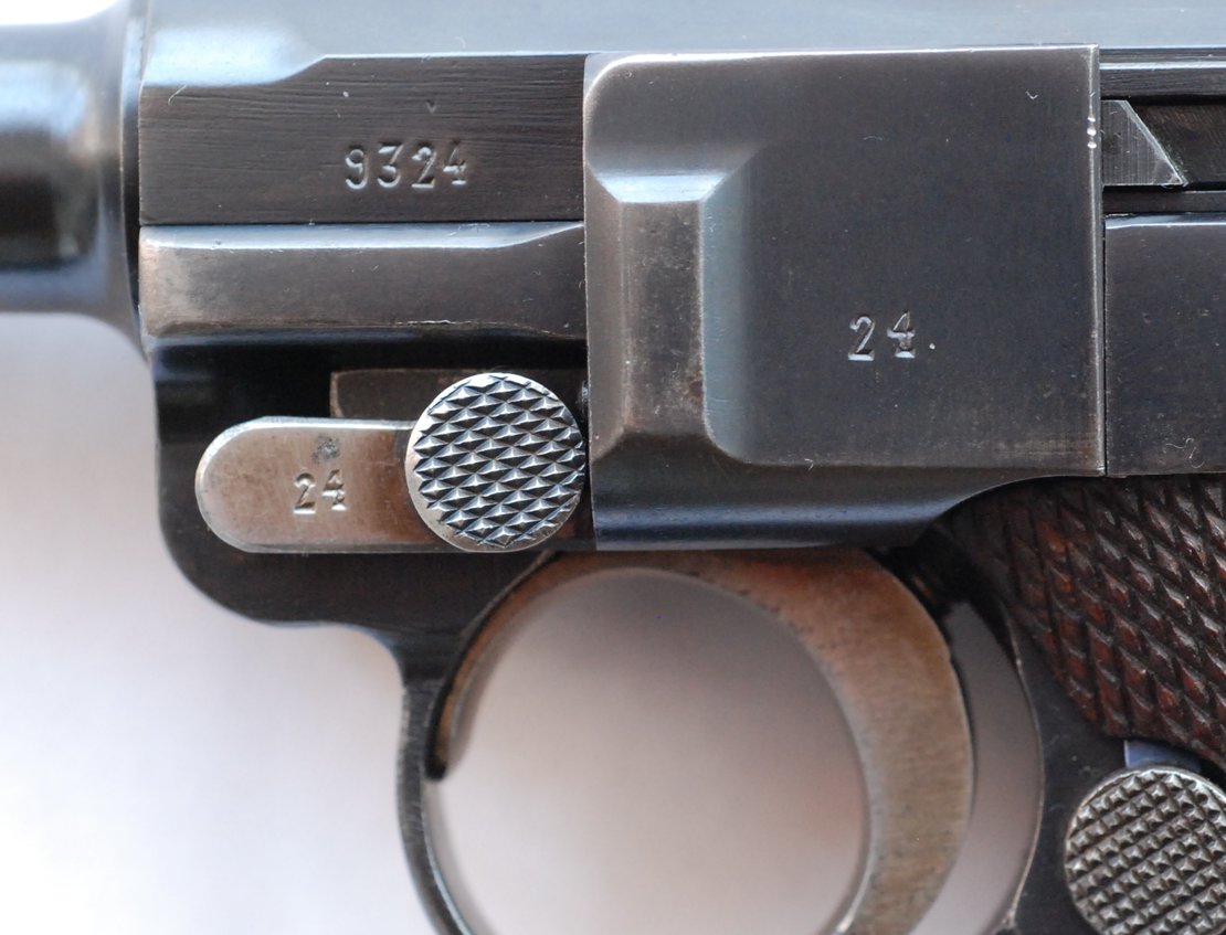

Hi Westin,
The side-plate seems to be the part most frequently replaced and most experienced collectors scrutinize this part. On Mauser Lugers the side-plate will be numbered internally as well, with the first two digits of the serial plus 1. The top left corner should be rounded over, see photo. I'm sorry to have to tell you that a replaced side-plate is a real value killer and the gun is relegated to "shooter " status.
Norm

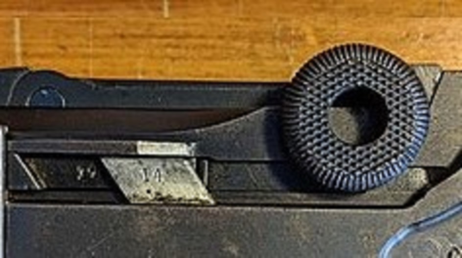

I'm also of the opinion that the side plate is a later replacement.
There's a number on the sear just in front of the safety bar. I can't make out the number but it doesn't look like 14 to me. If it's not 14, than the sear is also a replacement.
Attached is a blow up of the sear # looks like 79
