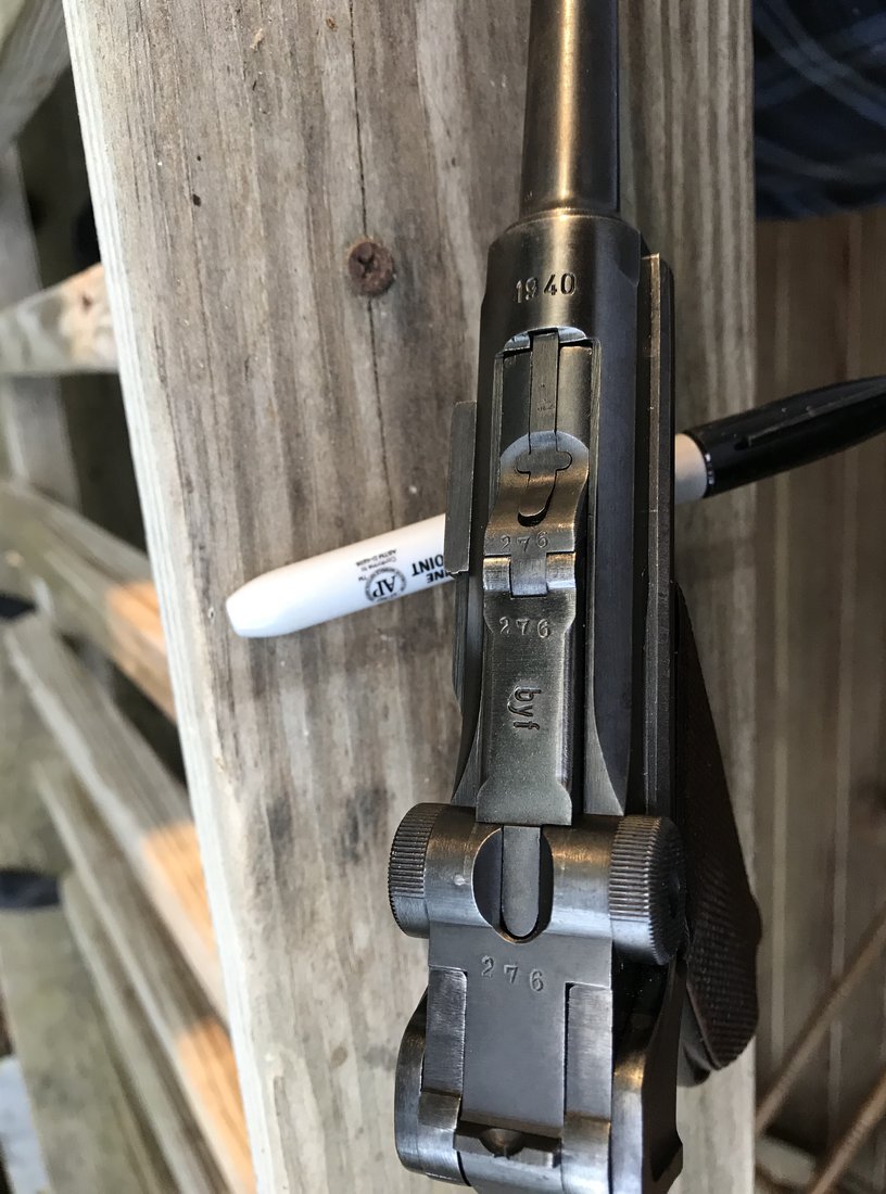

Posted this one on another forum , thought I would share here for a little more info on assembly (where and when, etc) included more photos. It’s marked very similar to a 1940 byf pg. 261 The Mauser Parabellum 1930-1946
Thanks for your time
schoolbd is offline   Reply With Quote
The following member says Thank You to schoolbd for your post:
Unread 05-06-2020, 10:24 AM   #8

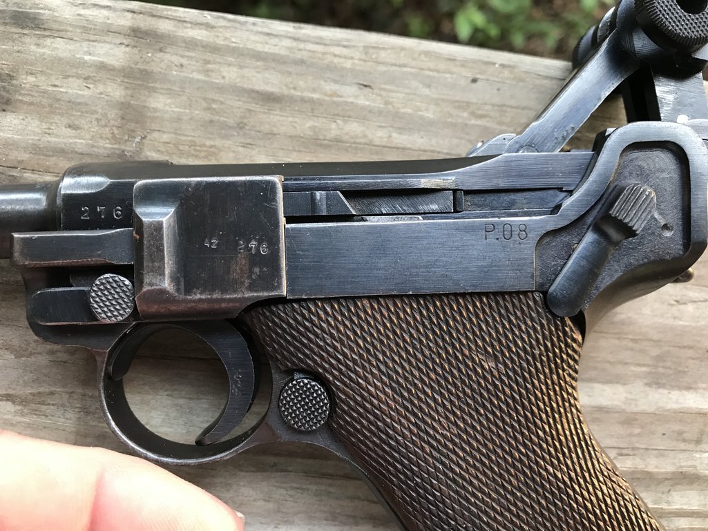

Your second Luger is rebuilt with parts from a number of different Lugers and arsenal rebuild replacement parts.
The "byf" prefix didn't start being used until 1941 (the Mauser concealment code was "42" until 1941 - so all 1940 made Mauser Lugers will have "42" on the toggle).
The side plate is an arsenal replacement part shipped from Mauser as a spare part.
The "byf" toggle is marked in a non-standard way. It's original serial number marking at the rear was removed.
I don't recognize the form of the eagle stamps on the barrel. I'm not sure that the replacement barrel was done by an arsenal or field replacement workshop.

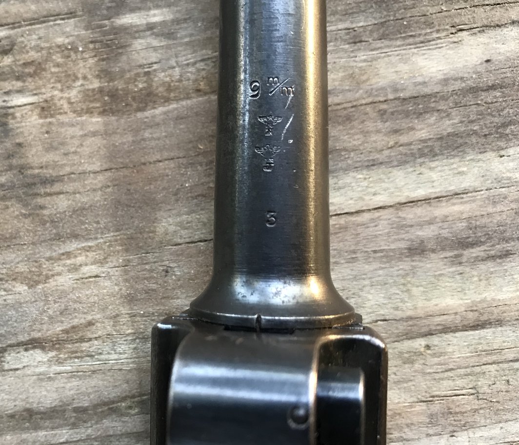

Same Luger with the Simson mark on the barrel, eagle markings on barrel appear to be eagle n as well as the one on the frame and toggle
Unread 05-06-2020, 11:15 AM   #10
The barrel was originally made by Simson- likely in 1923 from the "3" seen on the barrel.
It was added to the 1940 luger by a third party and proofed as a "repaired" pistol as indicated by the
added 9mm, E/N, and E/J .
The E/N is a proof mark, and the E/J indicates repaired (in this case likely the barrel replacement and perhaps other small parts).
Repair is also noted by the non-standard numbering on the replacement(42 code) side plate, and rear toggle. The HZa marked extractor is also a replacement.

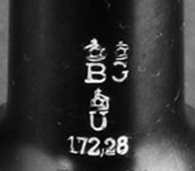

The E/N & E/J are IAW the 1939 proof laws and, as noted, are civilian/commercial proofs.
The picture below shows the barrel proofs on a pistol rebuilt by Frankenschloss during the same time frame.
