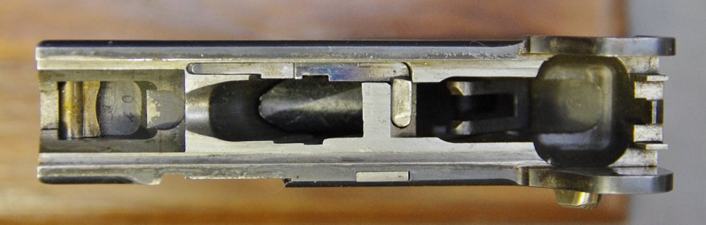

Yes, it can be in "improved" condition. The original color was a result of "drawing" a previously heated , quenched or air cooled part, which was hardened- to a lower temperature to relieve stress and impart some property to it.
The straw on small parts at a low 430 degrees, still leaves them hard- but stress relieved. The "blue" of the small springs, like the sear spring and the mag spring is there due to the part being heated to a higher temperature to "make" the spring.
If you look at a clean early hold open, you will see a spot of stress relief by heating which shows a rainbow of color in about 1/4"- from yellow to brown/red to bright blue- then on the other side of the blue, back through the brown/red to the yellow straw. This leaves the major part of the hold open hard but tempers the heated area to relieve stress and prevent cracking.
The color is/was originally a consequence of the need to draw and not for decoration.
