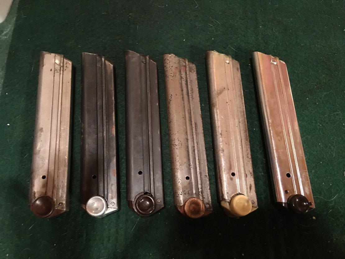

How about a photo of the magazines?

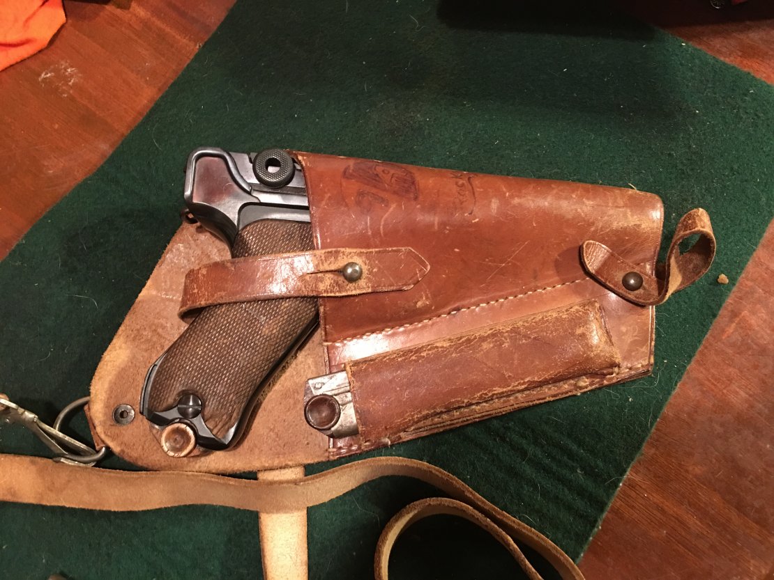

Thanks for all of the information guys and as far as the mags go I'll I've to take pictures of them tonight when I get home I ran out of time last night . The pitting looks far worse in the pictures than it does in real life . Can you guys see the markings enough to give me a little more information on them?

Ok here are the mag pictures.. And I tried to put a p38 magazine in the holster it wouldn't fit it's too wide

Now this is what it looks like with a mag and the Luger in the holster ... It fits like a glove

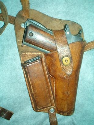

The holster is a GI private purchase. The RZM marked clasp was added to it later, as the original design adjustment buckle made it harder to remove the holster with gear on. I agree that it is an SA dagger hanger clasp.
This is not an issue item and should not be priced as such. Between the pistol, holster and the yet to be seen magazines, you paid in the high end of retail, but you weren't seriously hurt.
