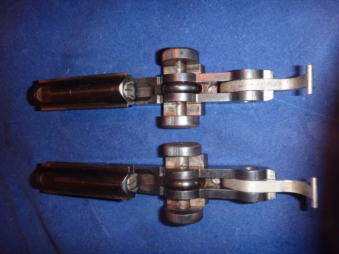

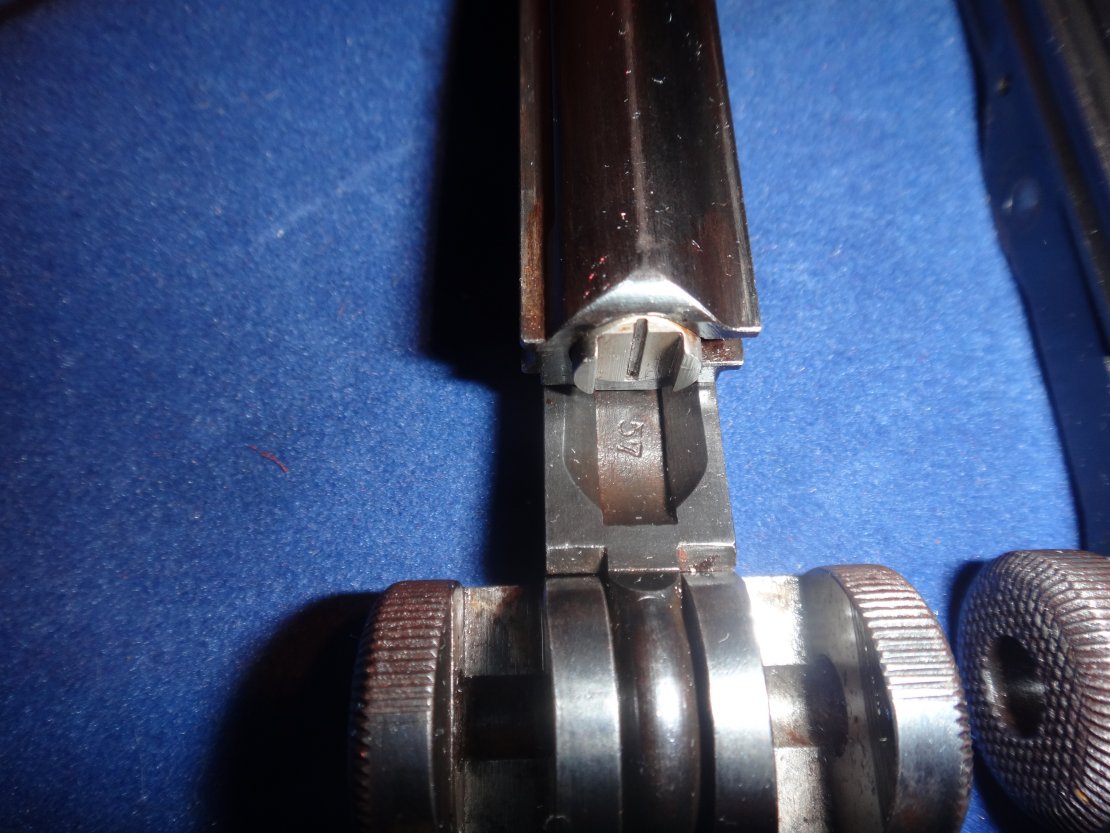

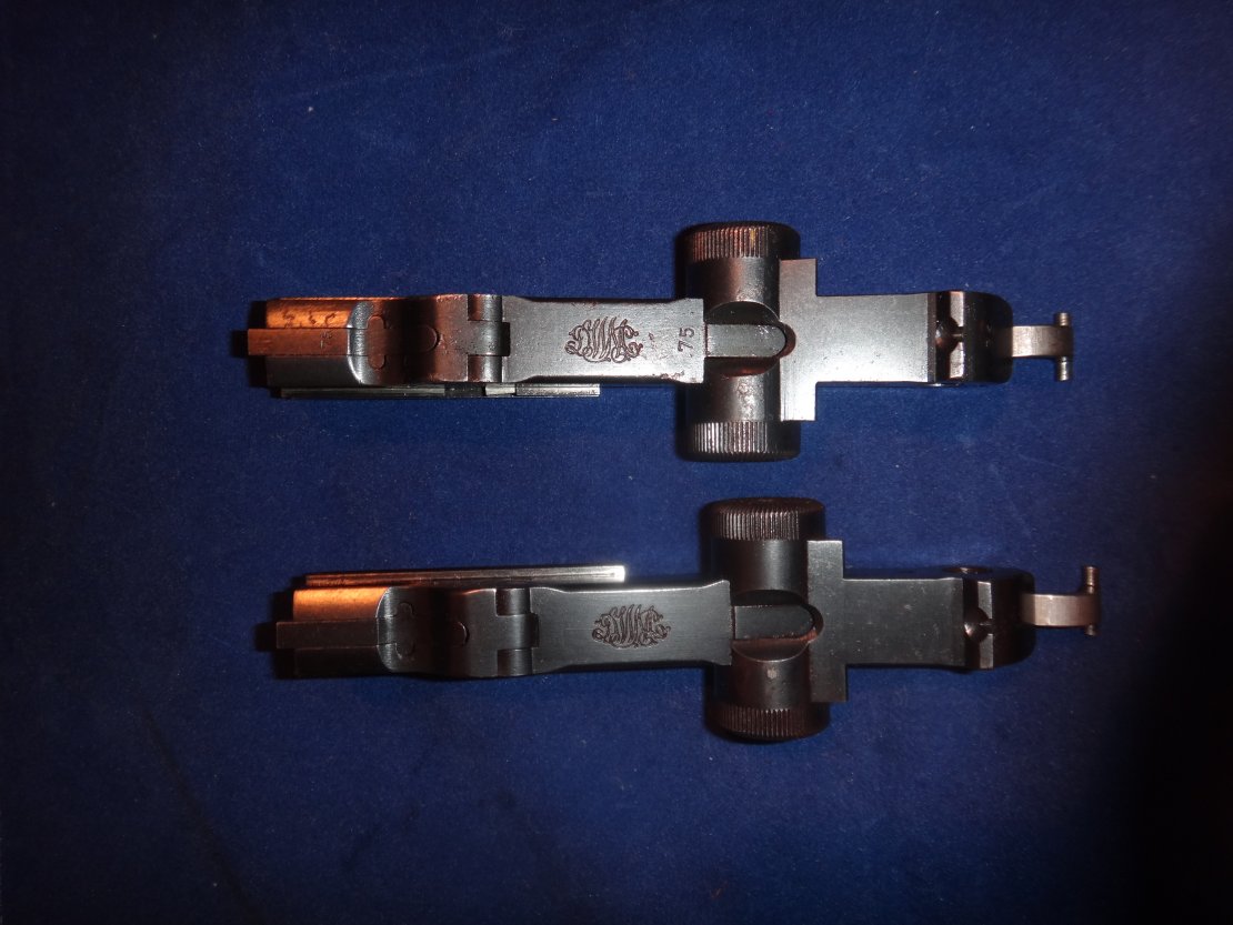

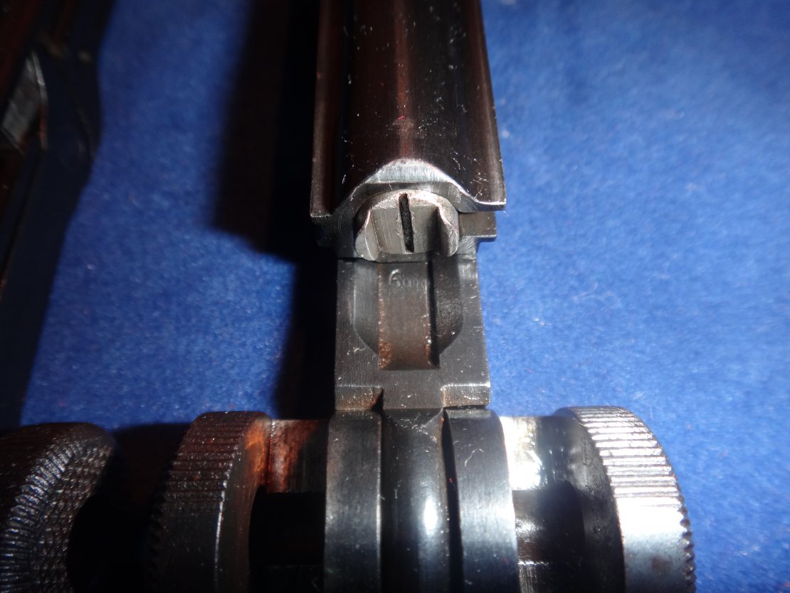

Just as reference
Top pic- Military type SN on toggle from a 1912 (Upper Toggle in pic)
Commercial style placement from a unit marked 1910 (Lower toggle in pic)
2nd pic - undersides of toggles with the commercial SN digits hidden on the 1910
3 and 4th pucs close ups of the recessed areas showing the last two of the serial number on the 1910
