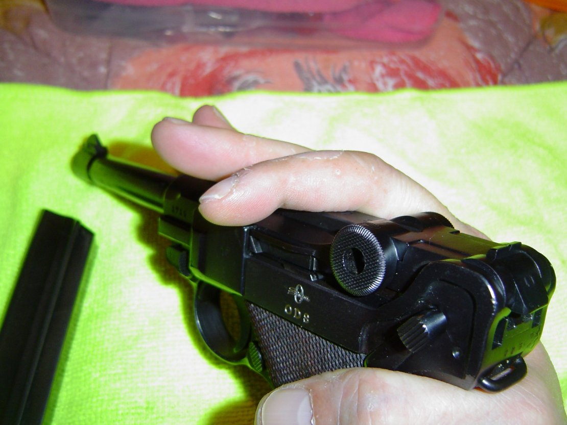

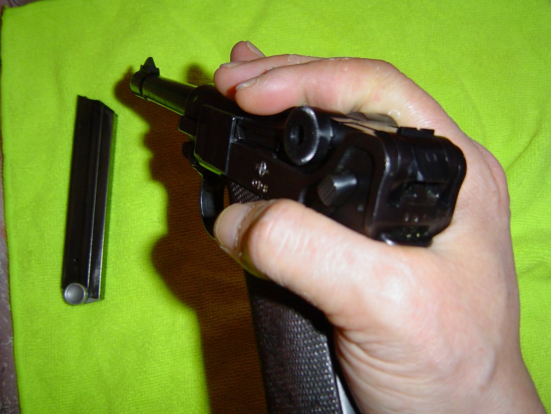

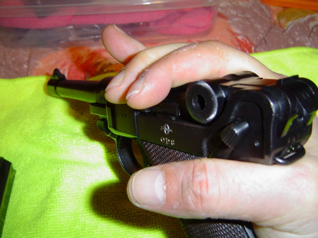

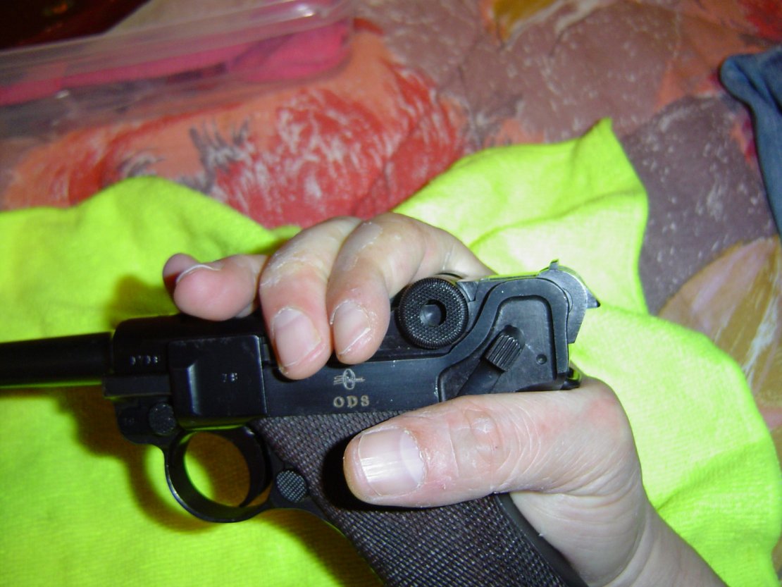

There are better ways. By far the easiest has been divulged, if I remember correctly, by Ithacaartist. After checking that chamber is clear, insert an empty magazine pull the action open until it locks, remove magazine and then rotate disassembly lever. It's easy effective and doesn't involve external hard surfaces.
Now if you want to impress your friends, you can do it the old Army way:
First step, hold your Luger with your right hand like this (2 pictures provided)
Second step, (no pictures, sorry) while holding the pistol in step one position, press the barrel back with your left hand.
Third step, making pressure with your index finger on the right toggle knob keep the barrel into retracted position (again 2 pictures)
Fourth step, while maintaining 3rd step rotate down disassembly lever.
You'll find that practice maketh perfect.

Hi,
You have recreated what is told us in the original DWM Owners' Manual.
Sieger

As illustrated in the manual, I use my right hand, just squeeze and the barrel extension will retract ~3/8", which is enough to twist the takedown lever down with the left hand, remove the sideplate, and pull the cannon assembly off.
