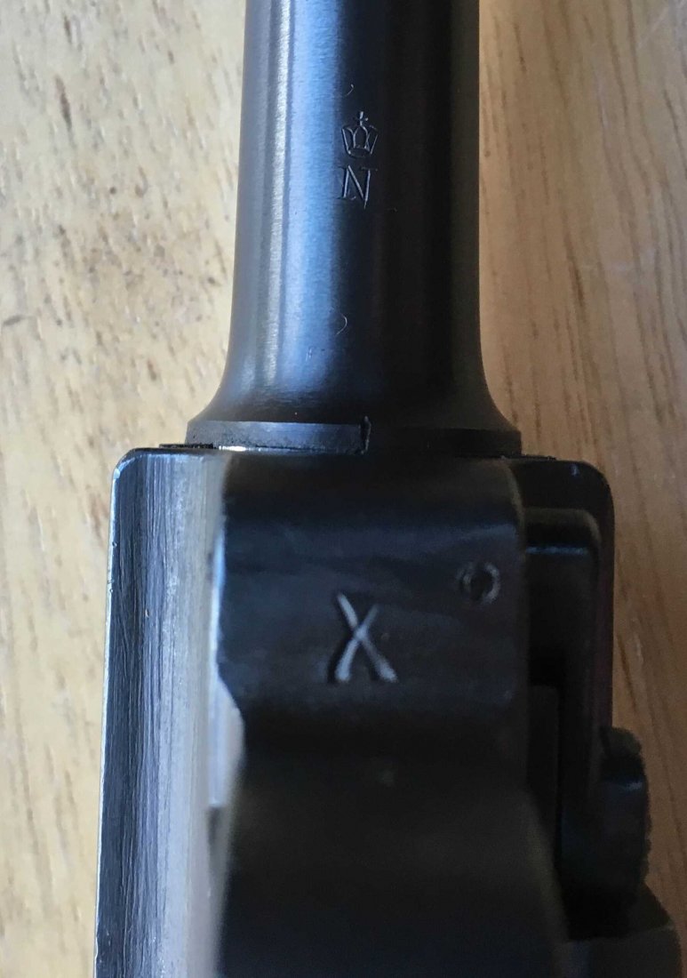

While I think I know the reason, I have yet to find any factual evidence as to why the "X" was stamped on Russian Capture (RC) and Volkspolizei (VoPo) Lugers.
I can think of two logical explanations.
The first (which I think is most likely) is similar to the logic behind the Weimar "1920" property mark. Everything after the war that was captured or turned in to the Russians got marked to prevent the gun being turned in a second time for a reward, and to indicate that it now was Russian property.
The second explanation is that the large "X" was added after the firearm had been through the Russian rework program.
Does anyone have a factual source to confirm why the large "X" was stamped on these guns? At a minimum Lugers and K98 rifles have this mark.
Thanks, Marc

I would not combine RC and Vopo with respect to the "X".
Many Vopo lugers do not have an "X".
I see the X most often on the RC "dipped" weapons, lugers, P 38s and K98s.
I've never seen an explanation of why the "X" was applied; I'm pretty happy just knowing that it appears on RC's.
If I had to choose an explanation, I'd choose door # 2, "x" after refurb, before dip. The ones I've seen are under the finish.
JMHO.

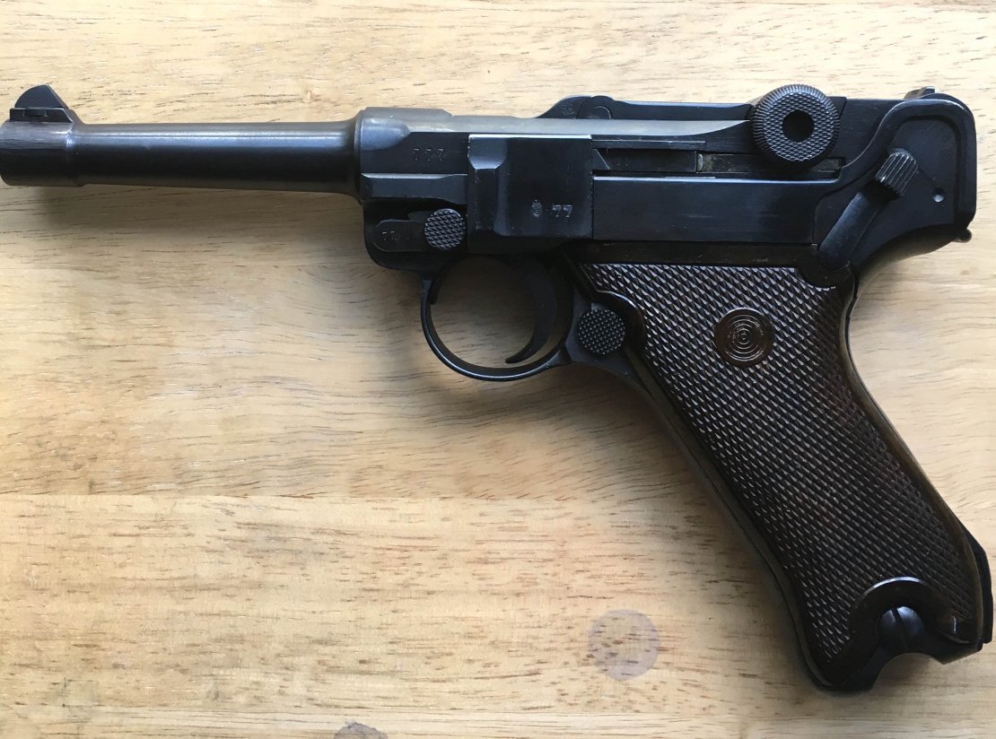

I have only heard rumours, and they usually go like this;
1. The 'X' is put there to represent Mosin Rifles (and as said above, they are seen on russian capture).
2. The 'X' represents that it went through acceptance into the Russian storage or that it showed it was okay to SELL and was actually placed there AFTER its long storage.
I do believe some russian captures ended up as Vopo - I need to look again in Marshall's book, but in the East, I think sometimes they issued some back from storage.
This is a Vopo for sure that I bought and although the 'X' is not on the side or front of the frame (where I have seen them the most), it is an 'X'

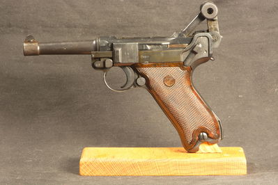

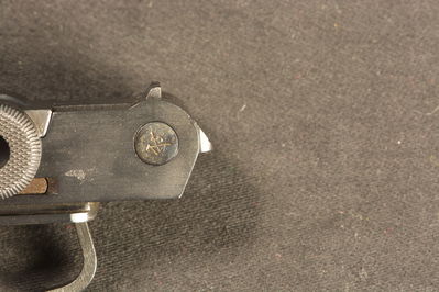

My VoPo (re-barrelled 1921; unused since rework, with bullseye grips) has the big "X" on the axle pin... (which is also a mismatch, so it could be for indicating that). This one is under the refinish too...
I would not call the axle X a typical "X" that I thought you were questioning.
I think you are correct that that particular x is just a cancellation mark.
