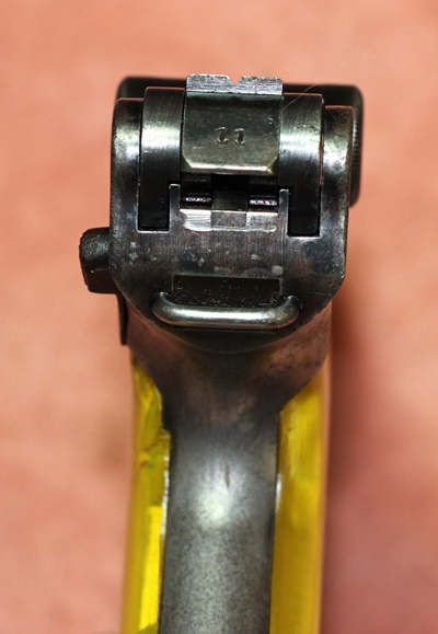

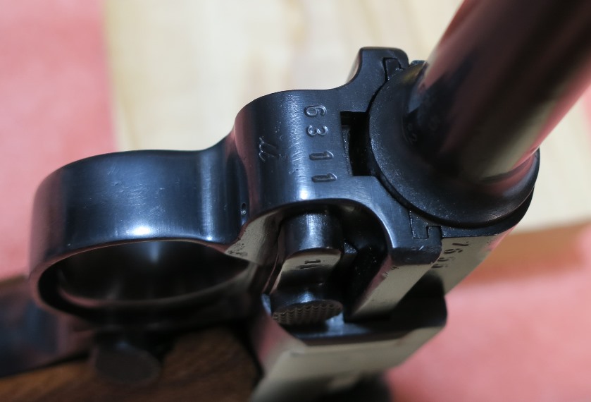

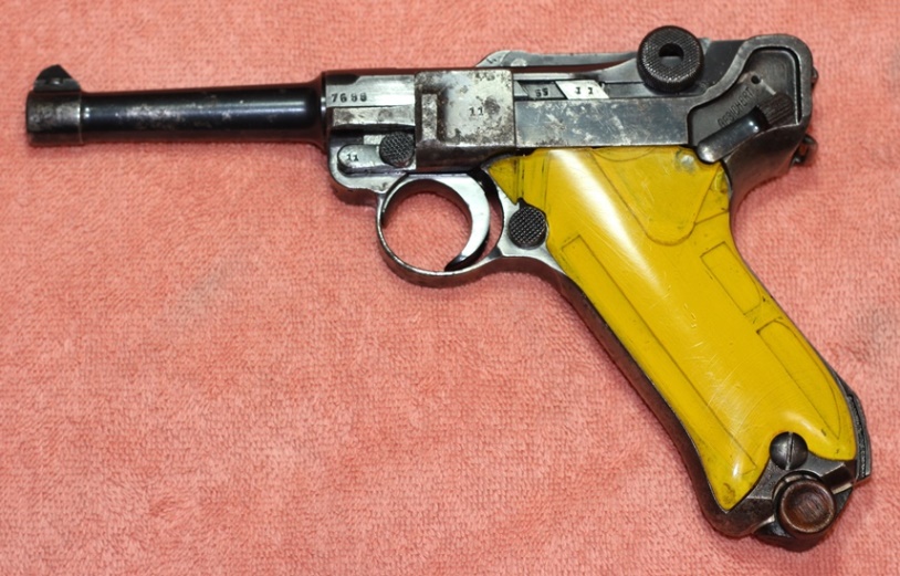

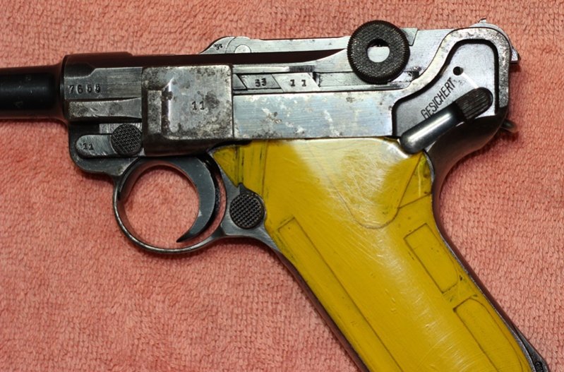

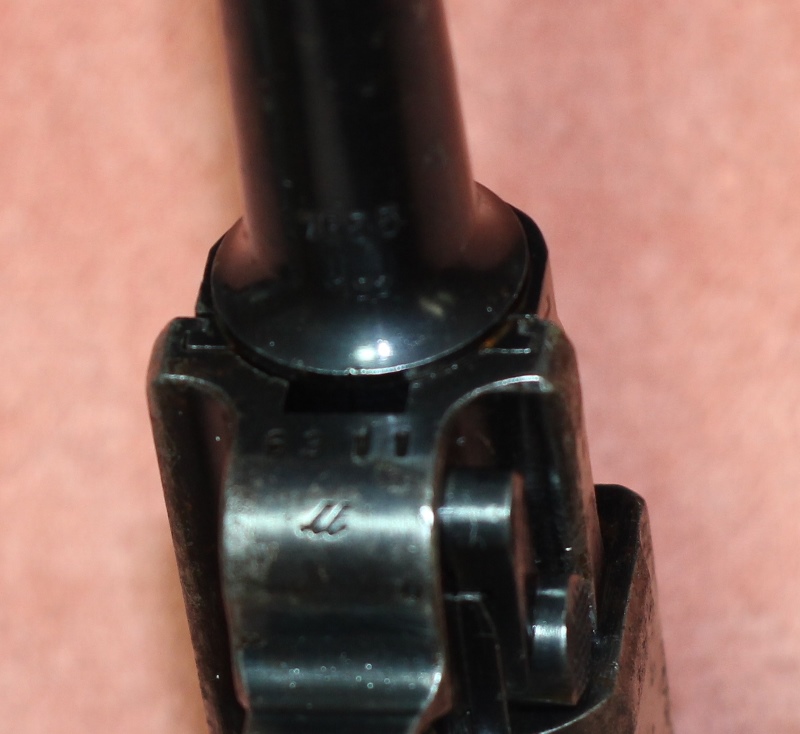

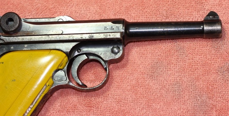

First time poster. I also posted about this gun at "the Firing Line" forum, so if you are a regular there too, you've probably seen this already.
Barrel is 1941, serial number 7655.
Rest of the gun is "6311 u". Grips are ugly or cool yellow plexiglass.
Magazine is not matching.
Much pitting on the piece above the trigger, and in some other spots.
Worn black leather holster is dated 1916.
So, it's an old, worn mutt, I know.
Can anyone give me an idea on the date of manufacture for the bottom part of the gun "6311 u", or any other info on it?
I've read that the plexiglass grips could have been GI made "trench art", or possibly made by German POWs. Any educated guesses?
Any other thoughts or opinions on this gun?
I'm thinking of getting wood or plastic grips ( I think the yellow is sort of ugly).
Thanks.

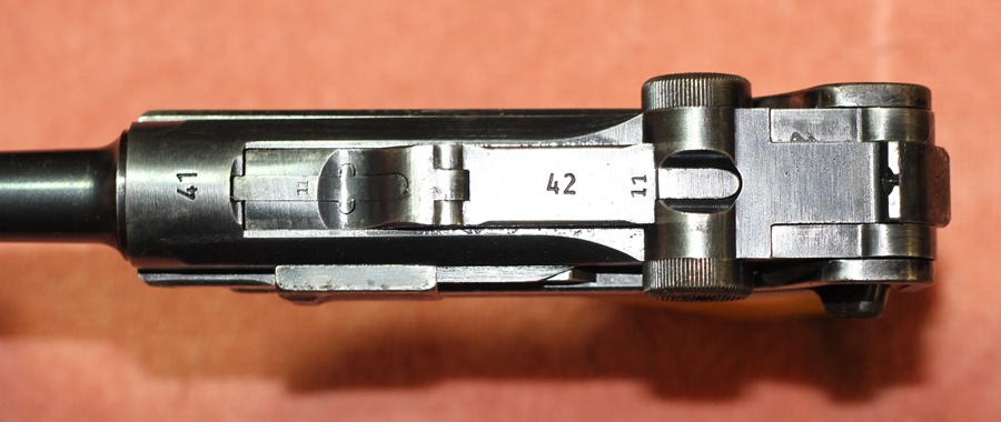

Unread 12-29-2015, 07:05 PM   #2
Welcome to the forum!
It is a 1941 (41) made by Mauser (42) upper that is on top of an unknown lower. I do not think it has the Mauser hump (see the FAQ for side by side pictures) - which means the lower could be DWM from WW1 to around 1934 when Mauser took over production. You can narrow it down to what years made a 'U' suffix, but other than that, it can be hard to tell.
The grips, I assume they are clear with yellow behind them? If actually yellow, then I would say post-war grips, as the GI made ones were made from aircraft Plexiglas and not colored Plexiglas, although who knows where they got it, if no story its just a guess. I have heard of German gun makers making things for GI's or holsters, etc, not usually German POW's as the story
Unread 06-09-2016, 04:31 PM   #3
derf0018
Join Date: Feb 2012
Location: Anderson, Indiana
Posts: 35
Thanks: 372
Thanked 10 Times in 8 Posts
Ed,
I think I see a "Mauser hump" on the frame on one of the photos. Also some "K" date Mausers had the hump.
Fred

Unread 06-09-2016, 04:41 PM   #4
kurusu
Join Date: Sep 2007
Posts: 1,225
Thanks: 2,679
Originally Posted by derf0018 View Post
Ed,
Fred
Yep! There's a Mauser "hump" alright.

Unread 12-29-2015, 07:10 PM   #8
Hawk62
Hawk62's Avatar
Join Date: Dec 2015
Posts: 16
Thanks: 23
Thanked 9 Times in 4 Posts
Thanks for the info. I'll check out the FAQ.
Yes, the grips are clear and painted on the backside.
Hawk62 is offline   Reply With Quote

Welcome to the forum! Your pistol also seems to be incorrectly assembled, where the stirrup for the toggle has not properly engaged the main recoil spring. Do not attempt to shoot the gun until this is assembled correctly!
Nice shooter, in any case.
Thanks. You are correct. I just field stripped and cleaned the gun today and corrected that/
Good eye, and thanks for the warning.
I will not shoot it until I get it checked out by someone more knowledgeable than me.
Is there anything I can do to improve the look of the finish, or is it too far gone?
Thanks.

Is it properly in battery, but the receiver has been cut back a few mm for some reason? That could be dangerous. Never seen a proof mark that close to the front of the receiver, and it looks like there is a chip out of it on the right side at the front.
The frame is definitely a few mm proud of the receiver front...
it's a mixed parts gun. You could spend all kinds of money to restore it, but then you'd be out all that money... with no improvement in value. Just shoot once you've determined it's safe...
Unread 12-29-2015, 07:58 PM   #12
Hawk, The number die set used on the frame is by Mauser, but I'd have to do some research to see in which years they may have reached the "U" block. TH

The only thing I see a little "amiss" is the strong marking from the toggle on the rear of the frame. This could be from a too weak mainspring or firing nato or other +P ammo.
I'd change the mainspring spring if it were mine. They are available from Wolf Gunsprings.com.

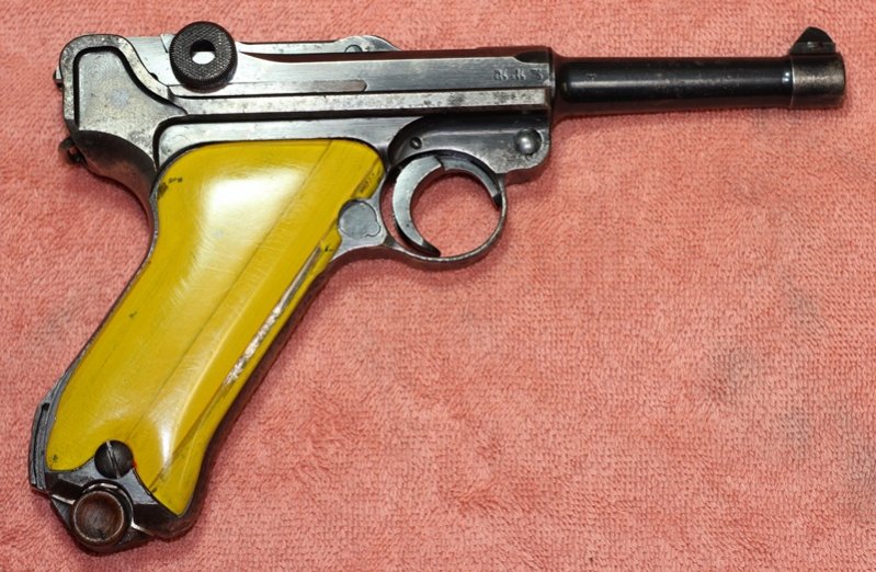

Interesting piece. I'd not change anything. The grips are likely GI made. Perhaps done in the field. Maybe even painted in the field. My father made a set of clear sweetheart grips for a WWI Izarra he picked up in France. After the war, in '48, he bought the Luger he always wanted (35 bucks including a box of ammo) and inspired by the first grips he made, he made grips for the Luger but used laminated strips of different colored Lucite. He painted the backside silver. It's just a shooter, though, as it's been polished a bit and reblued.

I agree with above that it is a shooter class Luger.....that is not a bad thing, as they are fun to shoot, and usually quite accurate. Use only std. velocity ammo like 115-124gr FMJ Winchester white box, PMC, etc. No +P+ or NATO 9mm.
If it were my Luger, I would spend no money for professional restoration, but I would purchase a good cold bluing solution, and cold blue the Luger. You can do it yourself, and the expense would be minimal, yet improve the overall looks. JMHO.

Hawk,
It doesn't look that bad to me.
Personally, I'd replace those "ugly" grips with something a little more "muted"; save them of course for any potential historic value.
Re-bluing, professional or cold, won't do anything much for the pitting- the rest isn't bad in my book.
I suggest you just live with it and shoot it as it is; if you want a pretty luger, you can always buy one to look at!

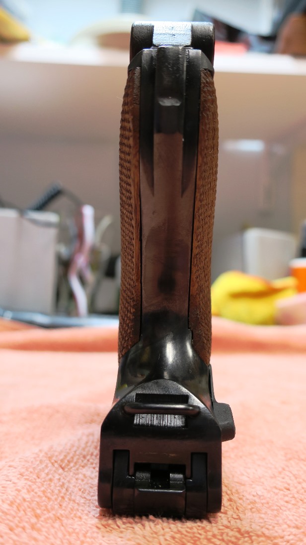

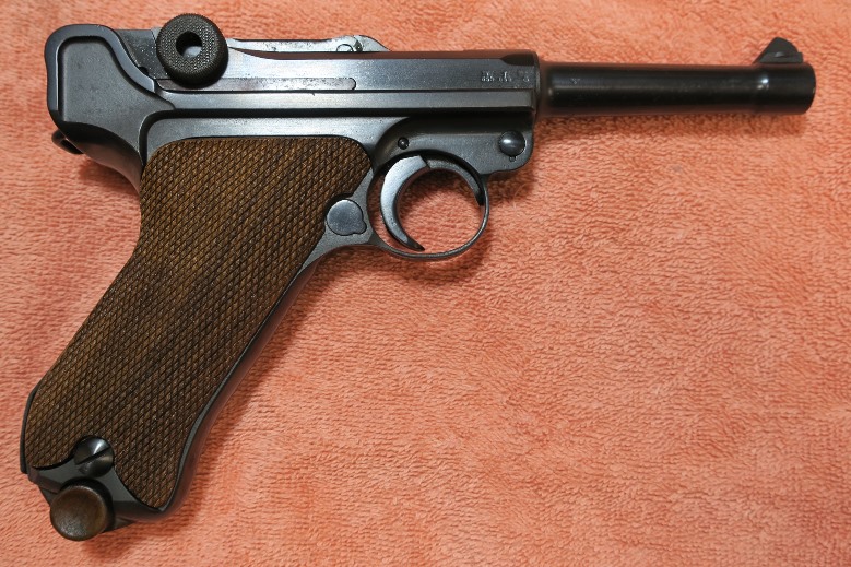

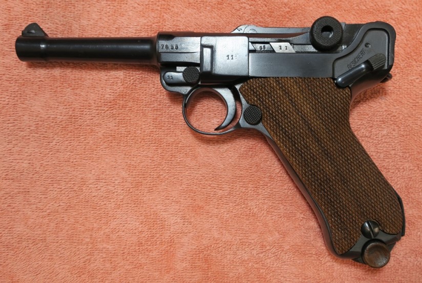

Unread 06-05-2016, 10:36 PM   #20
Hawk62
Hawk62's Avatar
Join Date: Dec 2015
Posts: 16
Thanks: 23
Several months ago, I decided to get the Luger re-blued and I just got it back this weekend. I am pleased with the result.
I know the purists may disagree and say I ruined the gun, but like I said, I am happy with the result.
Took it to the range and shot it for the first time in about 40 years. It shot great. Man, those rear sights are almost useless though.
Anyway, thought I'd share some "after" photos.
