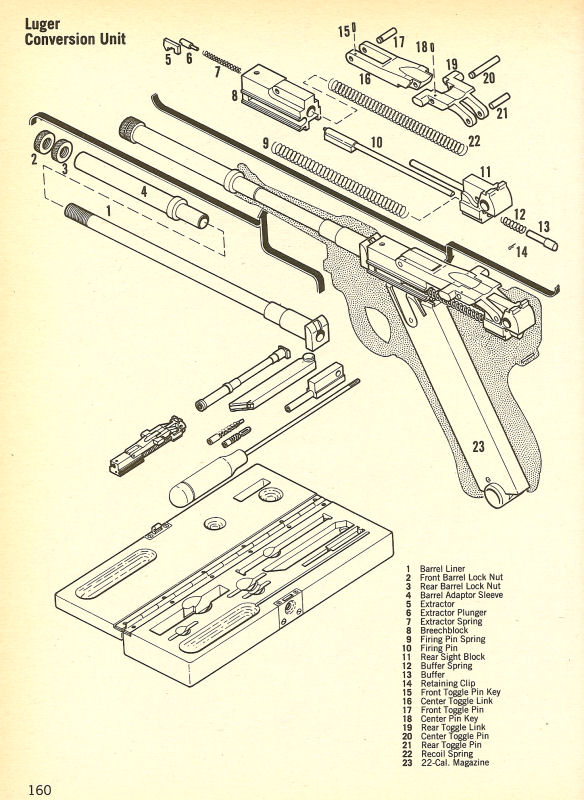

I found an illustration of what looks similar...Doesn't look too difficult to make...
But is the plunger and spring still in the breechblock??? The pic looks like it is...And I don't see anything to hold the extractor in place...Is there a hole for a retaining pin or something???
Also, Sturgess & Gortz show a purpose-barreled Luger with that conversion on a similar barrel...

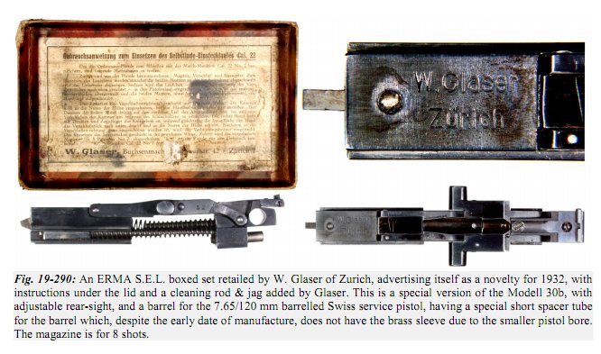

On another note, the conversion in the original post has the rather scarce (I think?) adjustable rear sight. Other than the one I own I have not seen any other examples. Does anyone have a feel for how common or scarce they are?
Unread 12-12-2015, 02:51 PM   #14
"...special version of the Modell 30b..."
How did we ever live without the Internet???

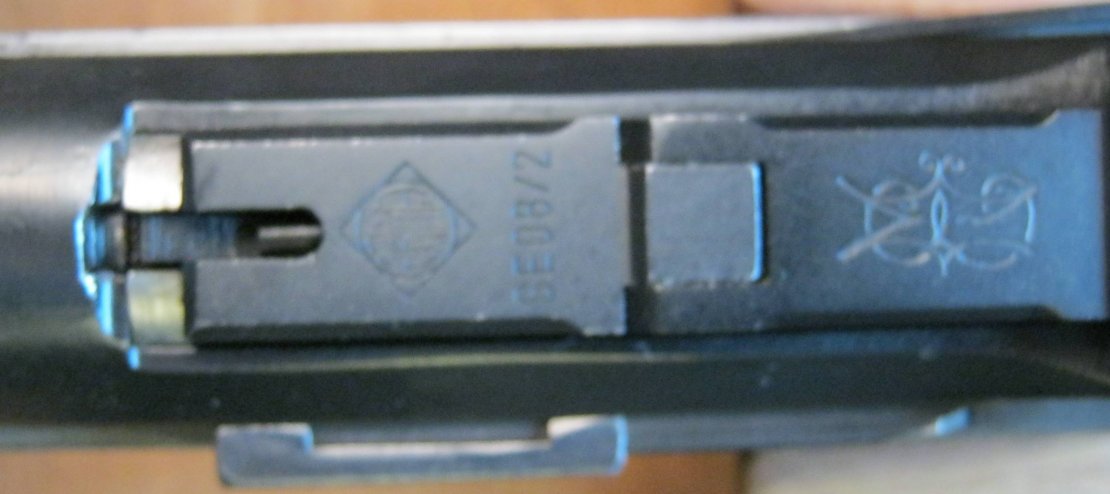

Ron, my friend happened to point it out to me (adjustable sight) -
I have only owned this one - this is a close up of the toggle that a friend worked on, the other above is my friends that I need an extractor for - sounds like having one made is the best bet?
