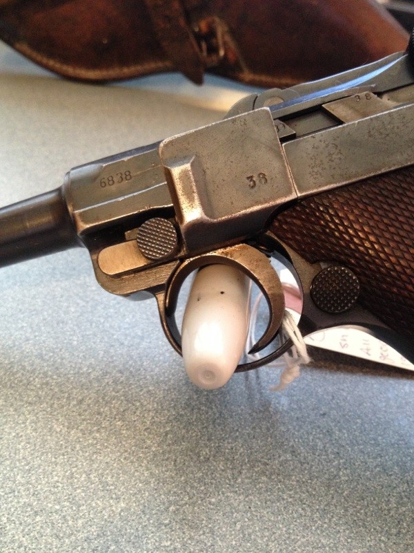

I did find this 1918 Erfurt on GB yesterday, crown does not seem to be broken, and it is a matching pistol.

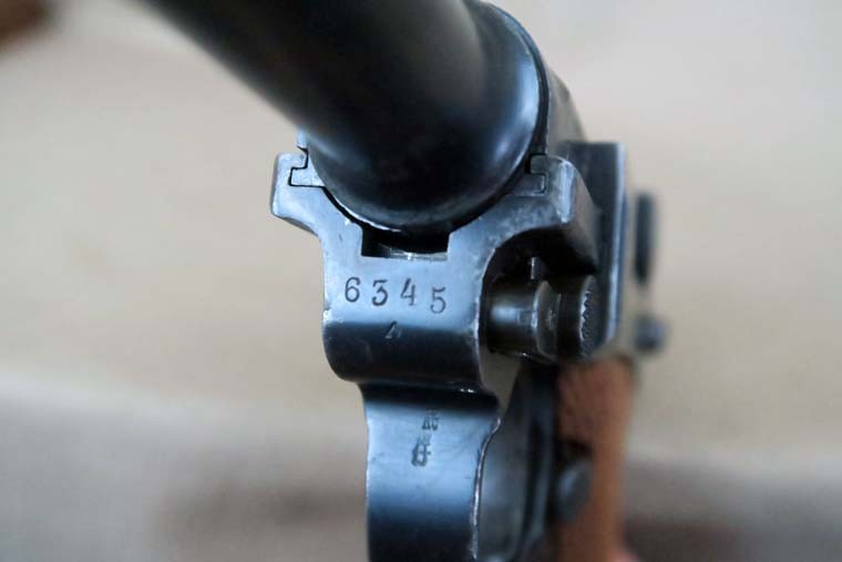

how about this one?
Pictures are not the best, grabbed from a GB auction.
