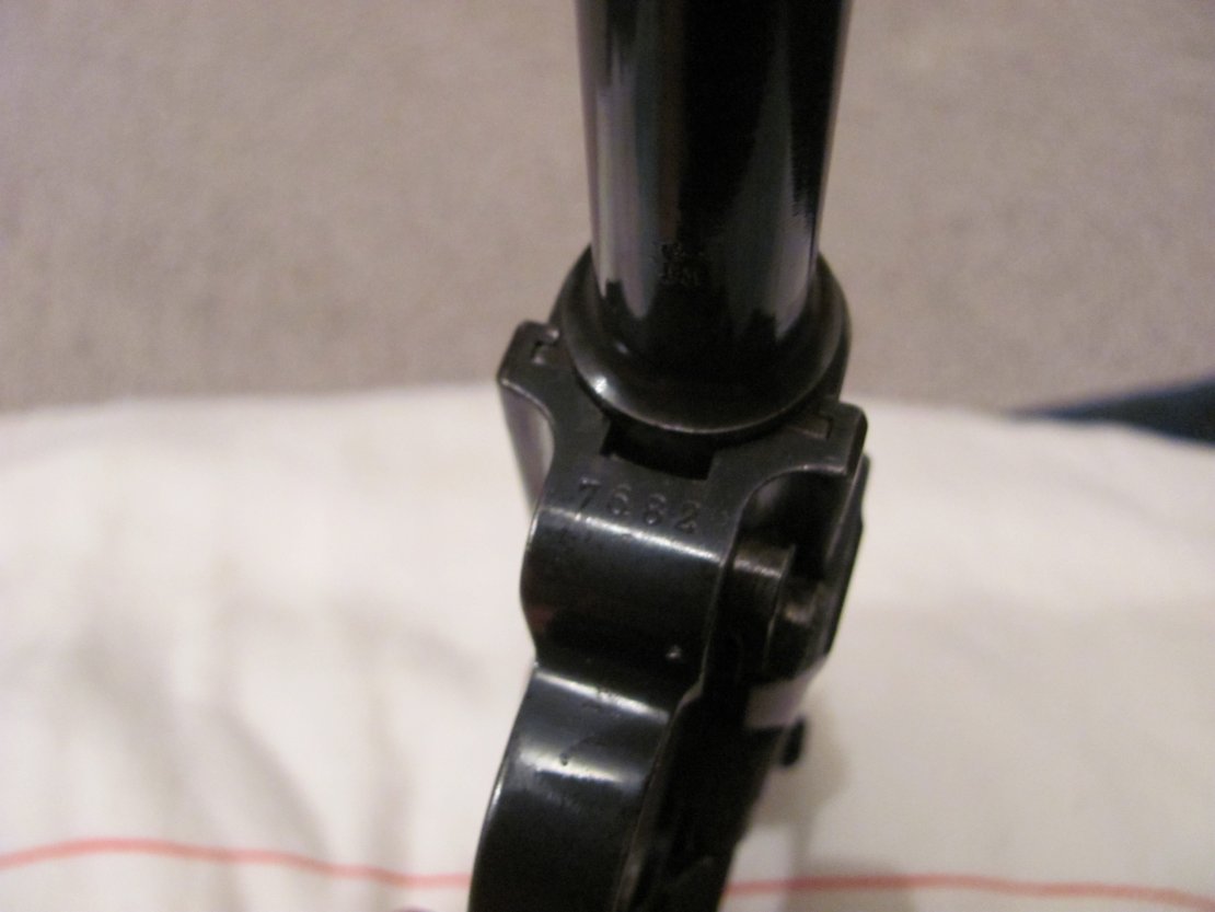

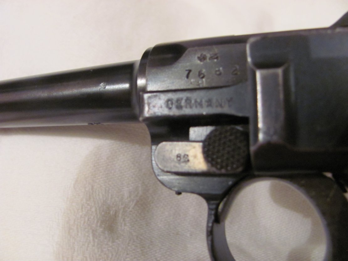

How can I tell if this is a 1906, 1908 or 1920 Navy Commercial? Serial number is 7682. Crown N under barrel. GERMANY stamped on left side below another a Crown N proof. DWM 1915 dated. Correct concentric circled wood bottom mag. that is unmarked.
Looks like three Crown proofs with an S maybe under each one and one Eagle with wings up.
Is the shoulder board legit too? What do the stampings mean?
Any ID would be most helpful!! Please check out the pics.
Any idea of the value would help too. It's all matching and the bore is exc+++

Observations: (1) apparently a short framed Navy which would make it a 1914 type originally, (2) no serial number under the barrel...replacement? (3) interesting C/S proofs on the right side of the frame seen on 1914 and early 1915 LP.08's, (4)lazy C/N proofs possibly indicating pre Weimar assembly. Questions: (1) is there a witness mark on the barrel at its attachment to the receiver? (2) any serial numbers on the stock iron?(3) any unit marks on the front or rear grip strap? (4) small or large rear toggle pin? (5) do you have a good view of the front/back of the holster? (6) frame well marking? Do you see an "N" or circled "N"? Need to know answers to these questions to better judge originality and value. It may have started out as a 1915 Navy, commercialized after WW1. Is it 9mm or 30 caliber?
Nothing that I can see. I'll add a pic.
No, none that I see.
No, none at all.
(3) small or large rear toggle pin?
Can't say as I have no field stripped it as yet.
(4) do you have a good view of the front/back of the holster?
Yes, what should I look for?
(5) frame well marking? Do you see an "N" or circled "N"?
Where should I look? There is a Crown N on the right side of the frame.
9MM form sure.

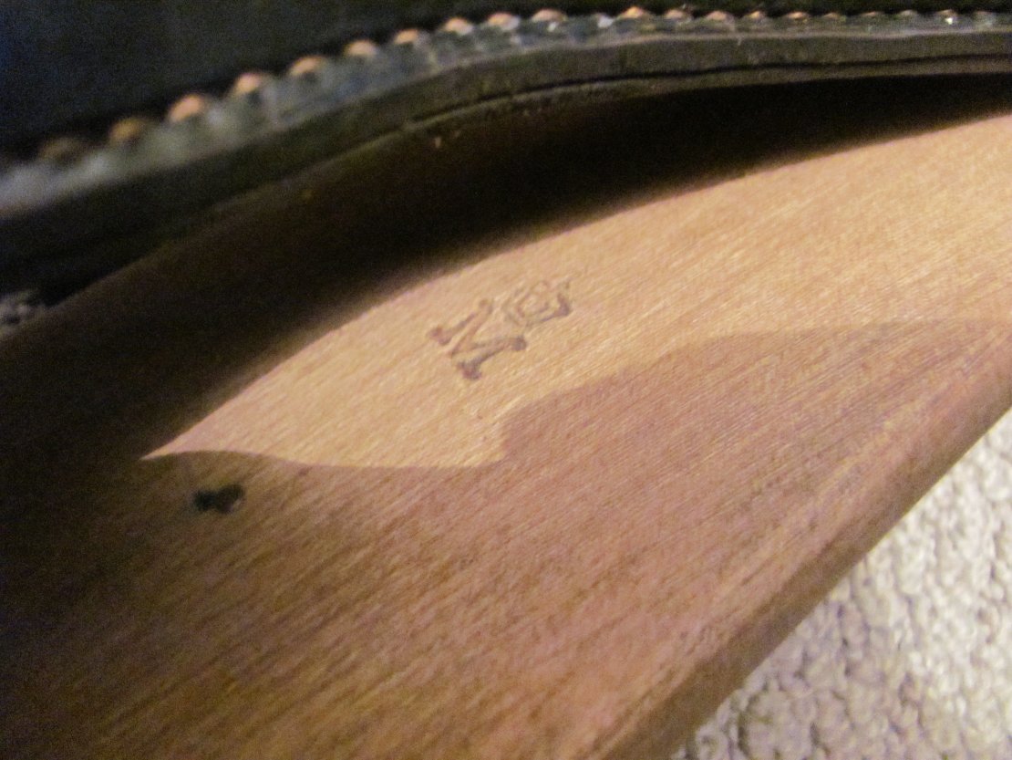

Stock and stock leather is fake. do you have a good view of the front/back of the holster? I can't see enough of it to say...
How long is the barrel?
Pics of the markings if any on the bottom of the magazine?
The proofs on the right receiver throw it out of Navy or commercial and no notch..it isn't or never was an Artillery..Yes, it's got commercial marked parts but Military too..I suspect a Pacific Arms import from the 20's.
Need to know answers to these questions to better judge originality and value. Originality is out the window. It's a mongrel. Made up of various parts.
Do you have any good photo's of the Navy sight?
I would like to see the holster. It MAY be more valuable than the pistol..I say MAY be..but I can tell you if you show it to me.

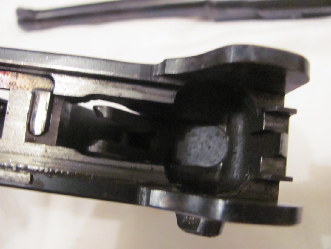

Tom, you obviously know how to post photos. Take apart this luger a take many photos of the inside of the frame, rear part of the receiver and also the inside of the grips. Better too many photos than not enough.
Old 09-07-2015, 10:32 PM   #9
MAUSER88
Join Date: Jun 2009
Location: NJ
Posts: 261
Thanked 60 Times in 32 Posts
OK, Does this help?
MAUSER88 is offline   Reply With Quote

Few more. Barrel is 6". There is an N stamped inside above the trigger. Also the "ejector" is fired blued with the guns serial number 82
No stamps on the grips that I can see.

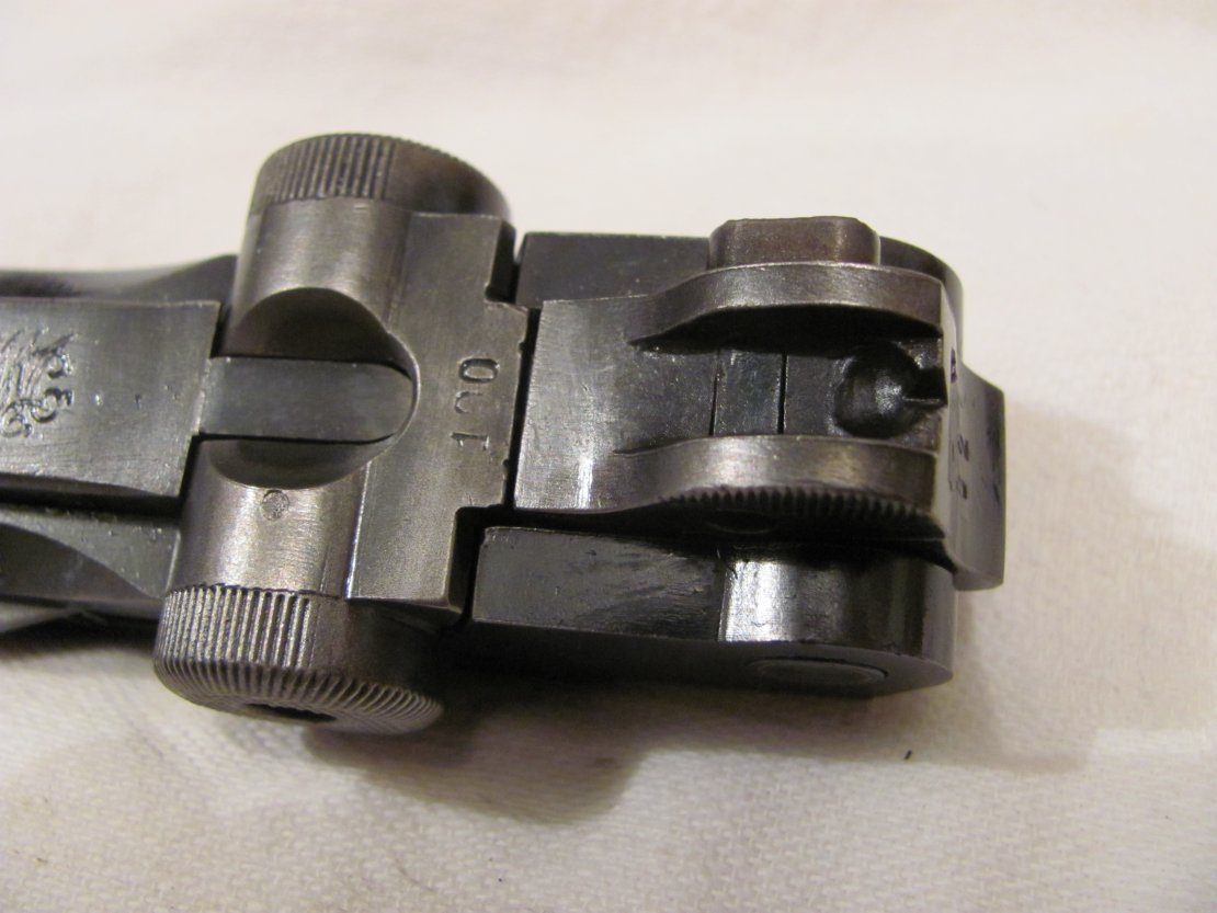

Rear sight.

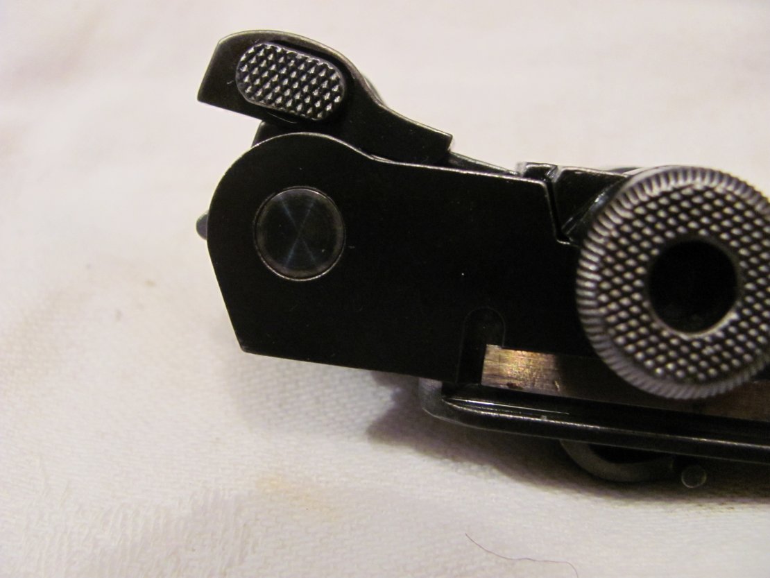

Tom, how about holster photos? The military proofs on the right side of the receiver tells us that this luger did not start out as a Navy. We need better photos of the rear Navy sight and the rear toggle pin which should be visible with the breech open and a picture taken of the left side of the luger. One cannot be certain yet what this luger is. It could be a totally made up fantasy piece but the requested pics certainly would help.

The new photos show the rear toggle pin is not original Navy. Taken together, this is a made up gun of various components to look like a Navy commercial. In any event, it should be a good shooter, especially if it is in 9mm. Value under $1K.

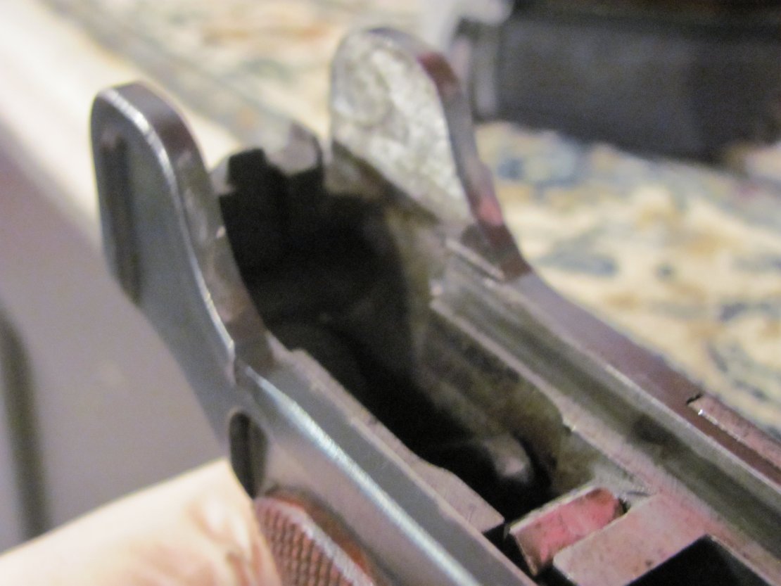

Tom, In post #9 second pic..there is an alarming photo! There appears to be terrible metal spalling..to the right of where the safety comes up through the rail and to the left of the L on the holdopen. Am I seeing what I think this is?

I am afraid I will have to be the bad guy here. In my opinion the gun is a 1915 army military with a replacement 6" barrel and a reproduction navy rear sight. It was placed into commercial sales after WWI but no later than 1920 as evidenced by the horizontal Crown/N proofs. The un-numbered replacement barrel and force matched navy toggle were installed at some unknown point.
Jerry, I see some roughness but no "terrible spall".
Old 09-07-2015, 11:35 PM   #17
Ron, I see some roughness . Are you looking at the same pic I am? #9 the second pic? That's some roughness? I have a bottle of rubber cement I have had on my leather bench for 20 years..it's hide looks smooth by comparison! That is some SERIOUS metal coming unglued! Those metal globs are the size of poppy seeds. I know I'm just a dumb country boy but I gotta say, I will have to agree to disagree on.. I see some roughness. I have cracked open my share of Luger's and I ain't NEVER seen any roughness even 1/10 as bad as that! DANGER Will Robinson, DANGER! Sumpin ain't right right there.
Unread 09-08-2015, 09:47 AM   #18
It looks like oil with micro debris in it. It has disappeared in the subsequent photos where the area was wiped down.

I see it, too. A sharper pic might help... it appears to me as if it could be beads of a liquid. Water in the oily corner? The mystery deepens. If a tiny chunk of harder steel got in there...

Is this what you are referring too?
