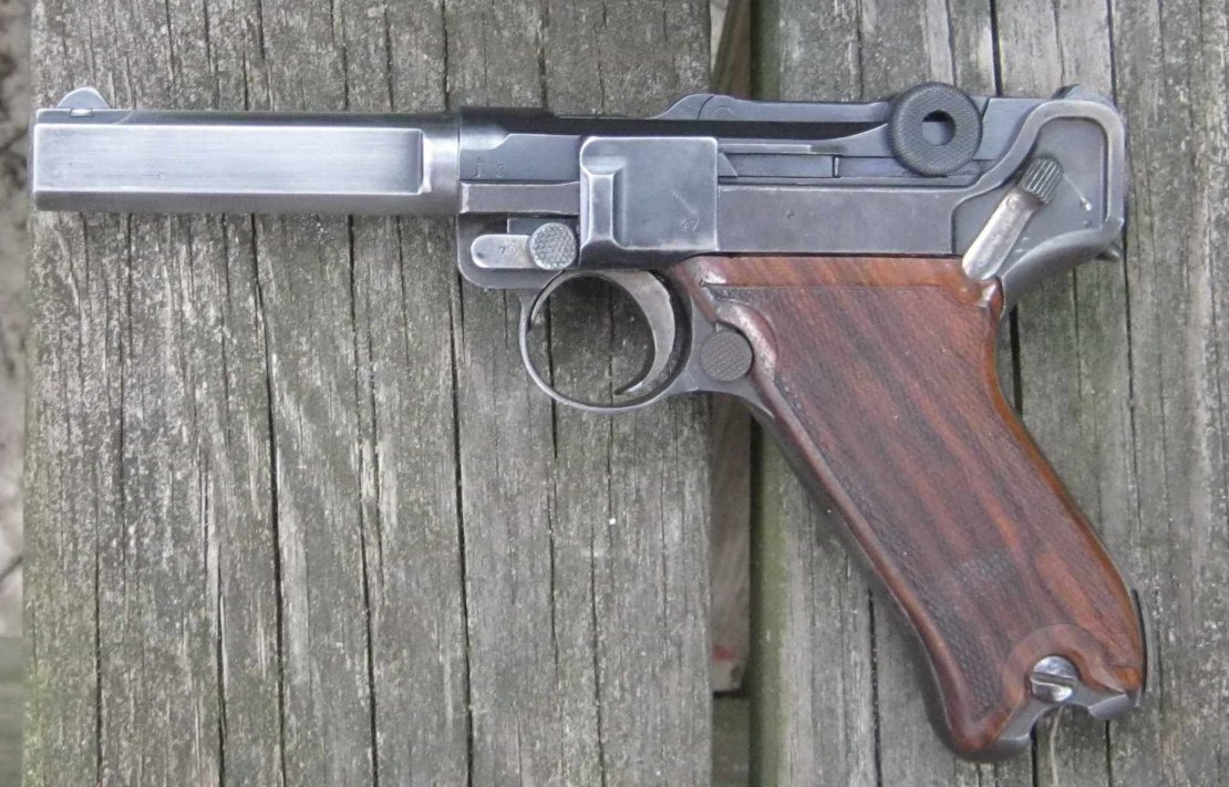

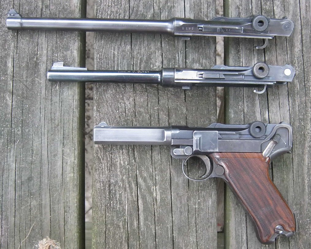

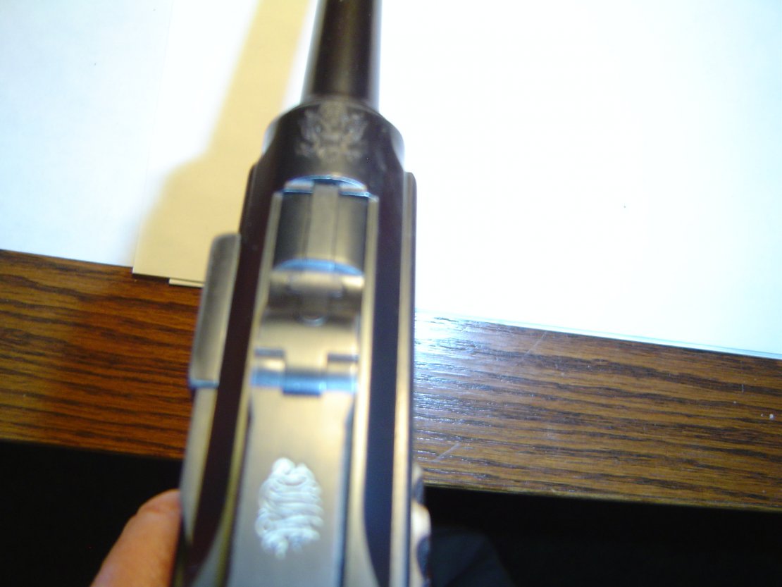

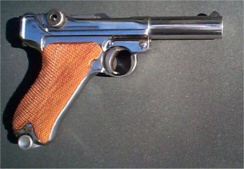

Many collectors on here will frown at 'modifications' (more so on Jan Stills forum, they are more 'staid' meaning dyed in the wool types, I mod at both).
I have always felt that different is okay
I had this done for me by GT Tomack
The top one is the one done by GT
the next are some long barrels (he put the barrels on) and the bottom was a nickle plated 4 inch bull barrel I used to own....

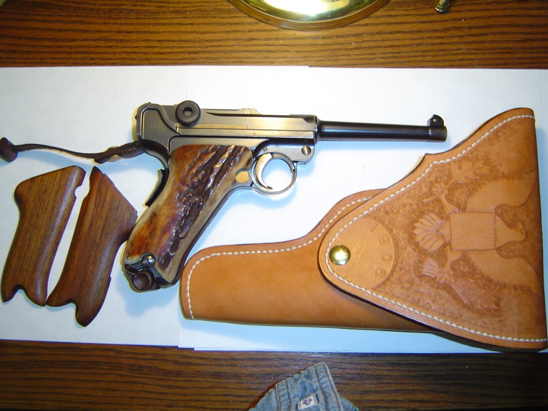

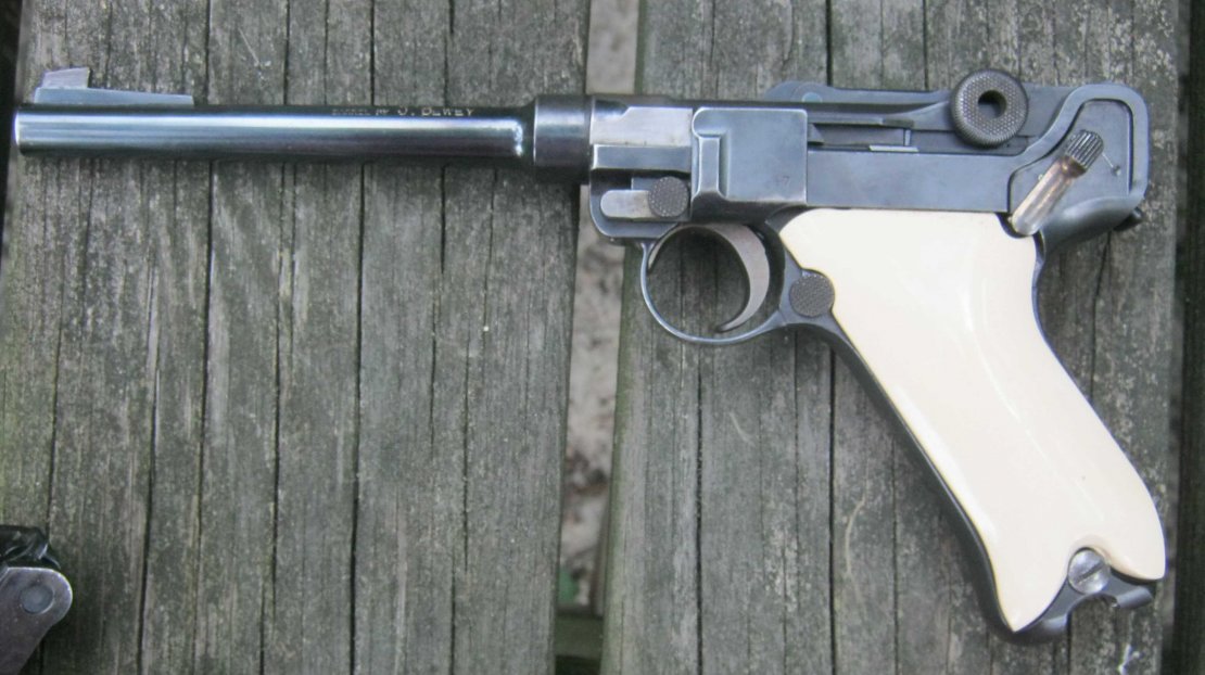

Here is my American Eagle with stag grips and a holster.
The grips did come from Ed.

Bill, those are great looking. I forgot that they were 1906 grip safety style.

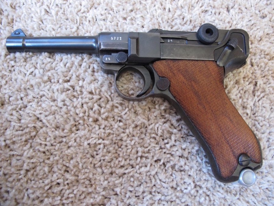

I'm not sure if this qualifies as 'pimpin' a Luger, but it certainly has been messed with.
When I got it: 1938 frame and receiver and attached parts (mostly) matched, replacement toggle marked DWM, firing pin un-numbered, left grip un-numbered (and significantly lighter in color than the original right grip), barrel an unnumbered e/135 Mauser-proofed replacement, marred receiver from the re-barrel, side plate was a non-matching Mauser part with the raised portion buffed to a soft and shiny blob, MecGar mag.
The barrel is near mint, which I like and therefore decided to put a little money into partially restoring (pimpin?) the pistol. Since I've had it I have changed the following:
1. The buffed non-matching Mauser side plate was swapped for an aftermarket side plate, then Charles Danner refinished the aftermarket plate with rust blue;
2. Significant marring on receiver from re-barrel mostly repaired by Charles, and entire receiver/barrel reblued w/rust blue.
3. Hugh Clark re-checkered both grips and repaired $1M chip on left grip.
4. Replica aluminum bottom added to mag by G.T.
The frame remains in its original salt blue finish, which is over 90%.
Here's the result, a partially restored shooter that is a mix of parts and a rust-blued upper, sitting on a salt-blued original finish lower. I wish I had 'before' pictures, because with the marring, filthy and worn grips and buffed side plate it had a sad-Luger look to it. That rust blue and salt blue finishes are mixed is probably the major factor in my claim that the pistol has been subjected to "pimpin" by its owner, although under most conditions it is very hard to tell any color difference.

I really enjoy shooters like this one! Sideplate came out great..... I'll bet it works good to.... Looks nice, best to you Greg, til...lat'r...GT.....

Yes it functions perfectly, thanks to you G.T. and is the most accurate pistol I have fired. Not bad for a "pimpin" pistol.

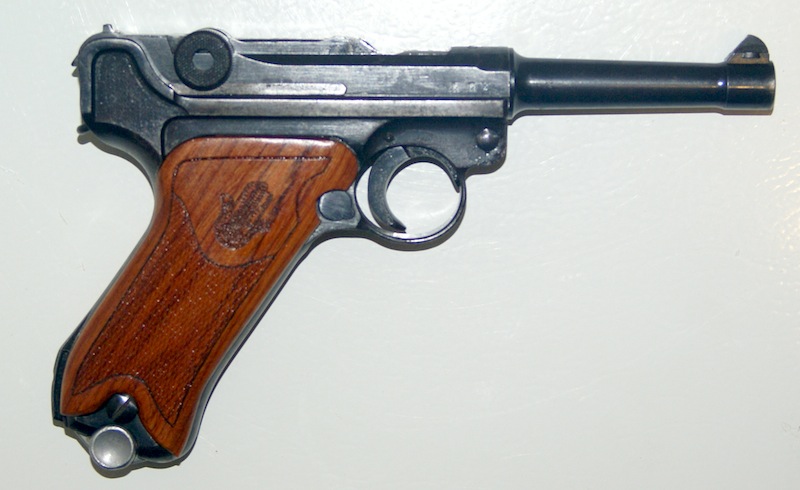

From my "new grips" thread:
Beautiful grips by our own Jim Solomon. I'm in the process of oiling them - pix to be posted once I'm done but they're looking GREAT so far!

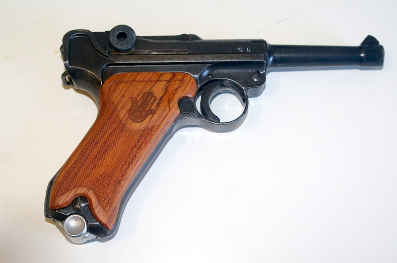

Some Tru-Oil and outlining work and these look even better - picture doesn't do them justice!

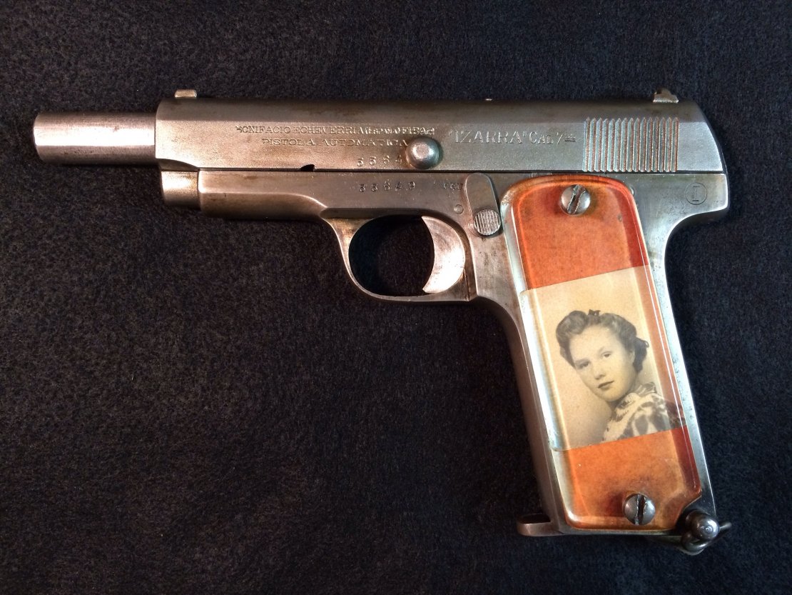

Nothing significant, I'm sure. It's been joked before that it's a gay pride gun, and my father was living in San Francisco when he bought it in '48, but I believe it's just the colors that were available at the time and I'm sure my father just thought they looked good. He also made a small jewelry box for his girlfriend at the time. She became his wife, my mother, and 11 other siblings followed.
I think he just got carried away with the idea of "sweetheart grips". He made a set of sweetheart grips earlier while in France during WWII. They were for a WWI Spanish Izarra he picked up over there.
FYI, he kept and I have the original grips for both guns.

I have seen the clear grips for many guns used this same way. The story I always hear was that plexiglass from bombers was used. Do you know anything about that being the material?
