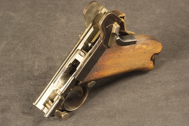

Did the 1900's even come with the hold open?
Unread 08-21-2015, 11:27 PM   #6
Yes they did. This one a Swiss M1900:

All 1900 Lugers came with a hold open. It didn't go away until the 1908 Army contract.
