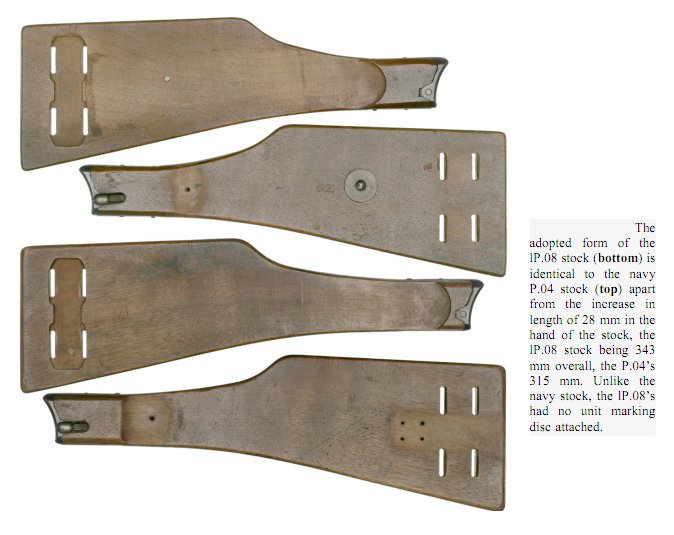

A while back someone listed the exact specs showing the difference between the Artillery and the Navy shoulder stocks. If you have this post handy, please point me in the right direction. Thank you, Hugh

Navy is shorter and has a medallion. Only legal on navy pistols...
Unread 07-21-2015, 04:05 AM   #5
I don't know for sure about medallions, but I know that they differ in size for about 2 centimetres.

This is what I have been able to find out about the Navy shoulder stock:
This exemption applies only to the listed Naval
Luger pistols if mated to the Naval Luger stock and will not apply if
the Naval Luger pistol is mated to the Artillery stock. The Naval stock
has an overall dimension of 12-3/4", a rear width of 4-5/8",
a front width of 1-1/2", a rear thickness of 9/16", and a front
thickness of l-3/16".
Now if I can get the same information for the Artillery?

IIRC, Eric posted this some time back...There were dimensions posted too but I only saved the pic...

Navy stock with Navy luger;
Art'y stock with Art'y luger;
not to be mixed up, i.e. mated with the other type stock/pistol.
Like to Like.
Each stock must be similar to the original in construction; in other words you can't just make a stock, or use a mauser or high power stock.
Numbers do not enter into it, some are and never were numbered.

No..It cannot be done. Stocks are dished out for specific holsters. 6 inch for Navy and 8 inch for Artillery. You can modify either end but you will NEVER make one into the other. Yes, it can be very technical but the average G man doesn't know enough about the subject to even ask intelligent questions.
