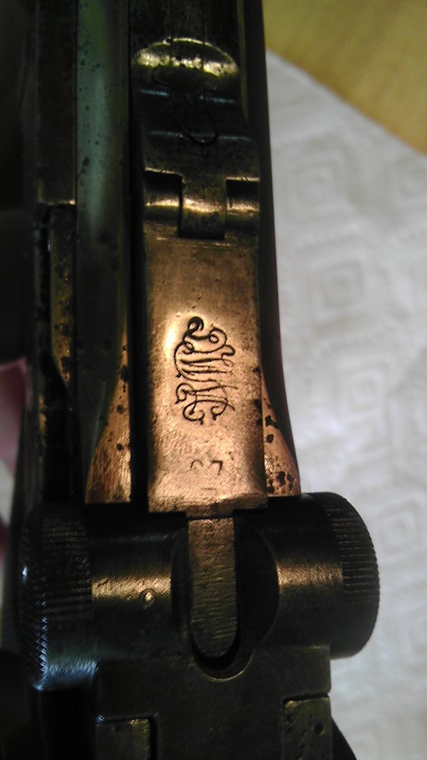

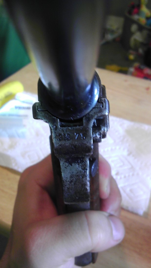

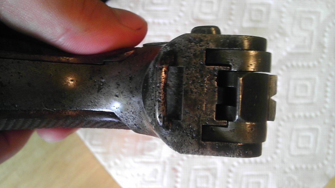

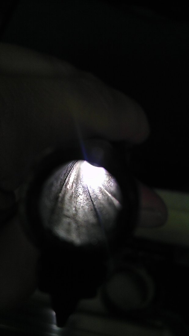

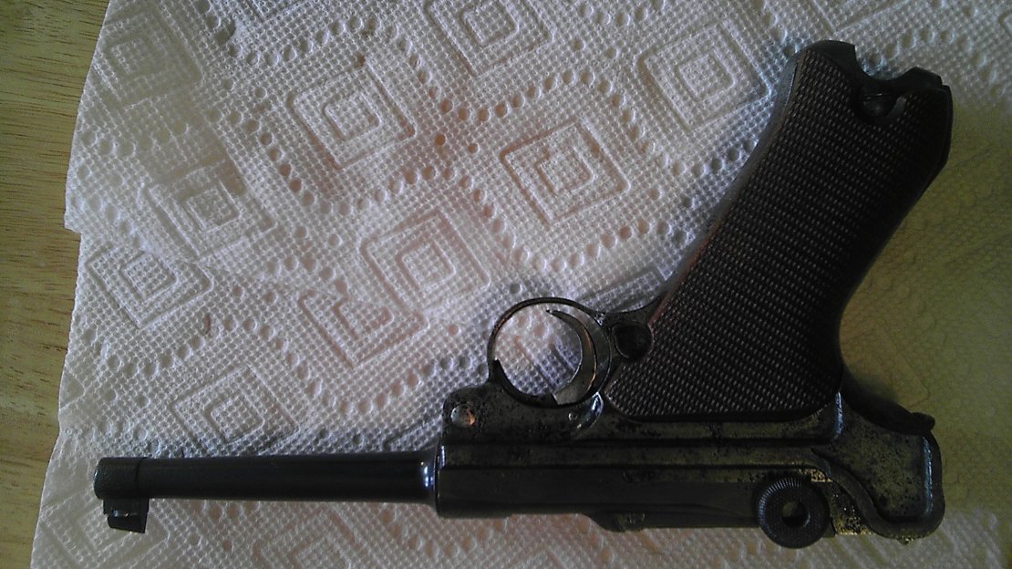

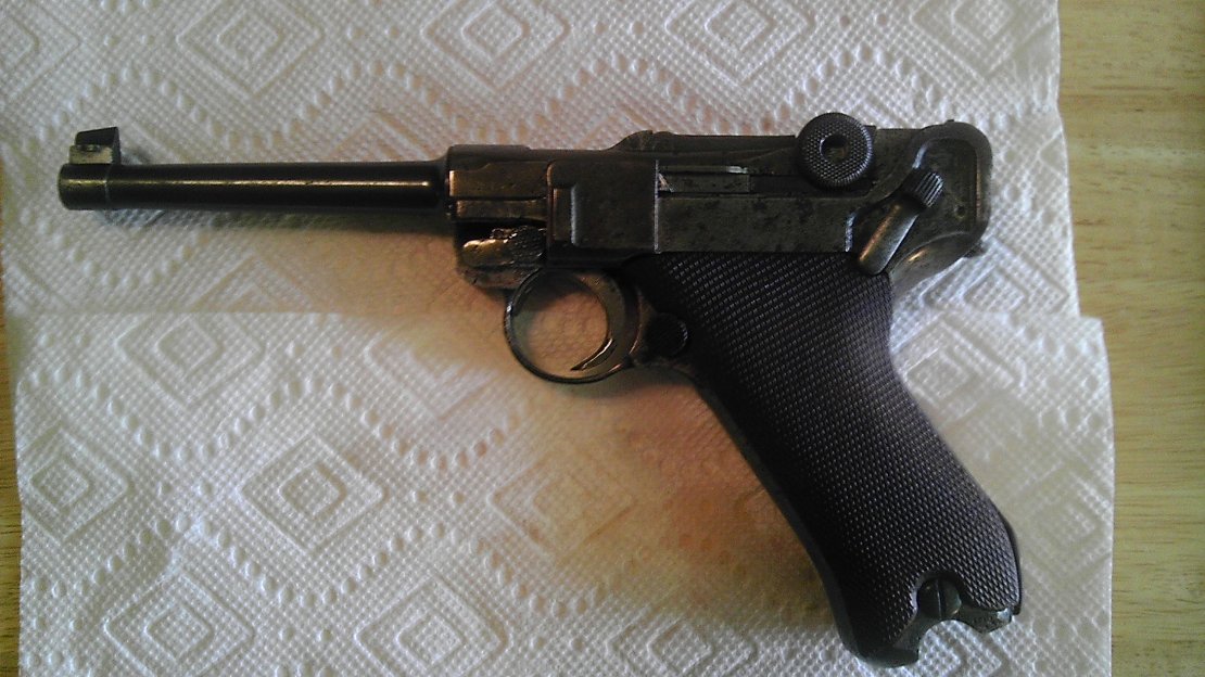

Ok, Thanks everyone for the input. I guess i should have been more clear in my original post, but I have been researching Lugers for quite some time, including books and online, the the message was received nonetheless.
Attached are several pics of the Luger in question. I apologize if the quality is not good enough. I was trying to mimic other photos on the sight but was having difficulties. If you all need better photos, I will have someone give me a hand the next time.
From what I can tell, almost everything matches except for the 2 halves of the toggle, the grips and the mag. the finish is pretty rough and the bore shows some pitting but the lands/grooves are still crisp (hard to see from the picture). also, based on the lack of proof marks, i'm assuming this is a commercial model?
Thanks for the help.

Even German commercial model should have proof marks. But for this one, you cannot be too serious. It should be a WWI gun or a 1920 gun with stock lug grounded off. A replacement pencil barrel installed on it.
I would say bypass this one. I know it's cheap. But there are many good ones also cheap showing up from time to time. Just need to wait.
Unread 06-22-2015, 08:54 AM   #11
This one definitely falls to the low end of the shooter category. If I may be blunt: Have you bought it, and if not, what is the asking price?
Unread 06-22-2015, 09:22 AM   #12
This is not an example I would proudly pull out to show friends "my Luger".
The condition may preclude safety issues, as well. Be patient until something better comes along.

Thanks for the pictures! Just getting that far and uploading photos is a challenge! Already, we can see the overall condition of the gun is very poor, the extension lug on the grip has been ground off, and the barrel appears to be a replacement.
I should have pointed out that the primary FAQ link is in the top menu. It's a post with a link to a PDF file you download. Also, there is a another FAQ with photos under "General Information", on the left column. It has a link back to the main FAQ post, too. Both are worth reading.
Under the "New Collectors" topics, you will find some hints on photo tips, too. You can upload a wide variety of photo file types:
Valid file extensions: bmp doc gif jpe jpeg jpg pdf png psd txt zip
Take you photos in a room with bright light from at least two different directions. Don't bother using a flash. Outdoor lighting usually works really well. Cell phone cameras work amazingly well.
Areas of particular attention should be each side, as you did, with a close up of all the proof marks and serials numbers, the toggle and the chamber. The next important spot you got was the full serial number on the front of the frame, but there will be another serial number under the barrel (it probably won't match, because your barrel appears to be a replacement).

From what I can see in the photos, this Luger would have to be very cheap before I would consider it. A "tired" old girl with a lot of changes. It could be a shooter, or a parts gun.

What follows may not interest the serious collectors...but I think this pistol is sort of fun. C'mon, its a Luger! I would never be ashamed to let it be an example, if only of a harrrd life. It actually is a fine example of several things that should not be done to them...and discovering and cataloging its deficits as an example, can itself be kind of fascinating. If you can get this cheap enough, none of these discoveries would be a disappointment--merely another nuance in its character.
It does appear to be a mix-master, buffed, ground off, re-blued, front sight challenged, pitted, heartbreak. (Wow, a list this long is somewhat of an event!) Pistols like this are like a trip to the SPCA. This poor thing could be compared to a person who has to sneak up on a glass of water.
So here we are, in the $300 range, give or take--preferably take. Consider that the owner of this one would be able to shoot it anxiety-free with absolutely no worry about breaking any part, serialized or not. It may be a good gun for learning about the care and feeding aspects, as well as an example for exploring the mechanics and unique systems of the Parabellum. And I've also heard tell they are fun to shoot.
The proof of the pudding is ultimately in the shooting. If it is your desire to do so, someone qualified should assess its structural integrity--in hand-- and render judgment as to whether shooting is even feasible. It is frequent to see a gun look like this on the exterior, but find it to be clean and sound internally, so there's hope. If its action and major components can be given a clean bill of health, who cares if it had acne as a teenager? And it matters not, for a shooter, that it carries parts from disparate cousins!
In the meantime, do you think you could provide shots of it field stripped? We may be able to save you that trip to a local expert.

It does look, in one pic, as though the frame may have the Mauser hump...And the barrel appears to be a 30 cal 120mm barrel...But it might be a 9mm Tikkakoski 120mm; they are quite similar (especially the distinctive 'squared' front sight blade & base/band)...
Worth quite a bit more that $200...in parts...
Good eye, Rich, and probably memory, too. I thought I recognized the profile of that front sight...
