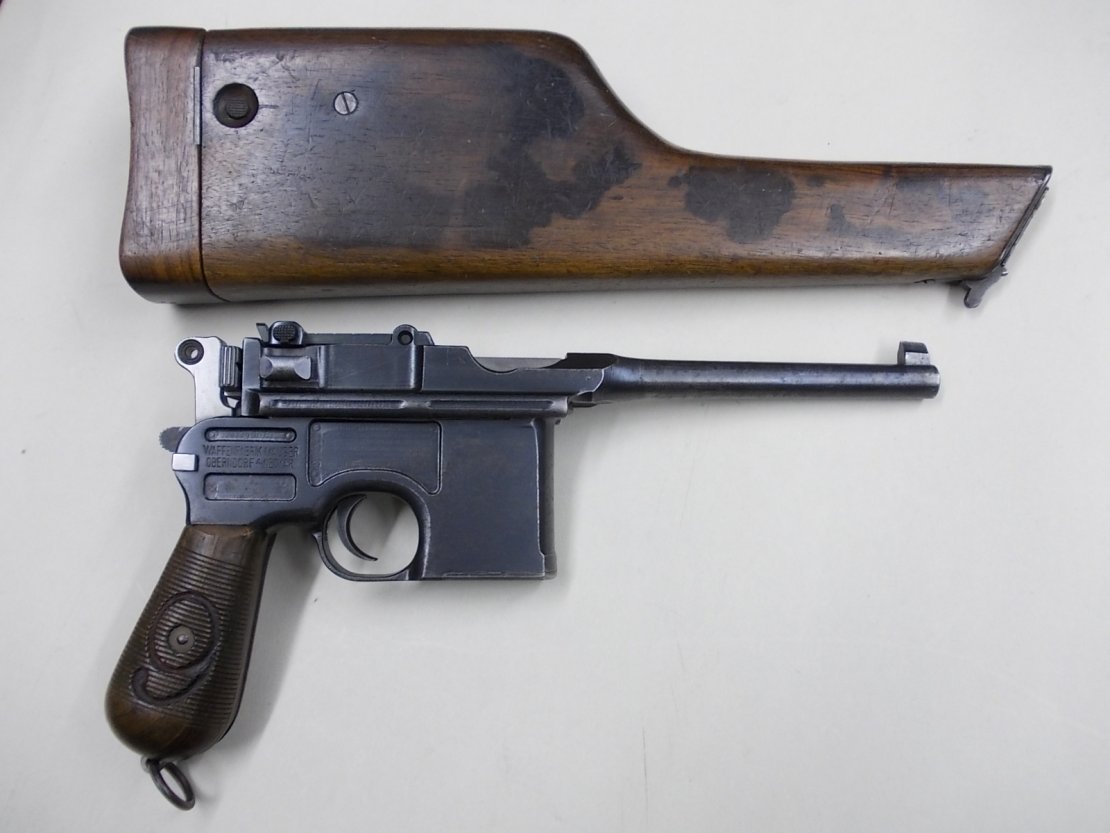

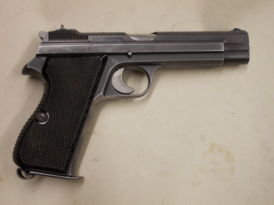

... I would add that now I don't think that I'll ever buy another gun rechambered 9X21 IMI however well kept, as here they cost too much and don't have much real collectible value.
The C96 "Red 9" of which at least 135,000 were made between 1916 and 1918 (so not really scarce) rechambered 9x21 IMI here is being sold for over USD 2400.00 wich to me it's absolutely mad.
Sergio
Unread 12-26-2014, 05:40 AM   #17
The C96 "Red 9" of which at least 135,000 were made between 1916 and 1918 (so not really scarce) rechambered 9x21 IMI here is being sold for over USD 2400.00 and the SIG P 210 rechambered as well would cost over usd 1800.00 wich to me it's absolutely mad.
