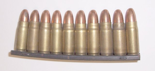

All three of these work fine. I'd just like them to look better. Here's a stripper clip full from 20+ years ago I keep for display. I could spin-clean them with Nevr-Dull and then use automotive paste wax to preserve the shine...I'm just looking for a better way to tumble them and get an acceptable 'matte' finish...An LGS some distance away has some that look like I want (done by a local reloader) but he won't tell me how (or who)...
Removing the tarnish is what my goal is. All three medias I have on hand work well to remove dirt/grime/powder residue, I'd just like some glitter...

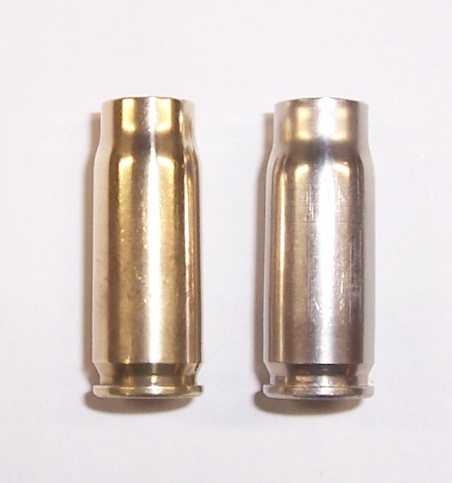

I don't know what the corn cob is (been in a bucket for years) but the crushed walnut shells is '24 Grit Fine Soft Abrasive' according to the box...I used it a couple times for blasting, but it wasn't as good as the glass beads [for blasting]...IIRC, the glass beads were expensive...
Edit: I was curious as to whether cutting/resizing/bottlenecking would flake the plating off...It didn't...
