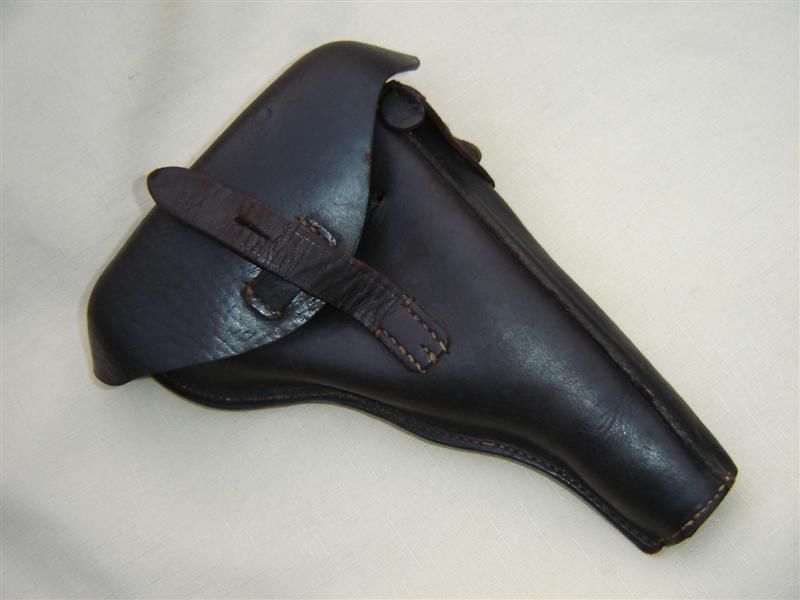

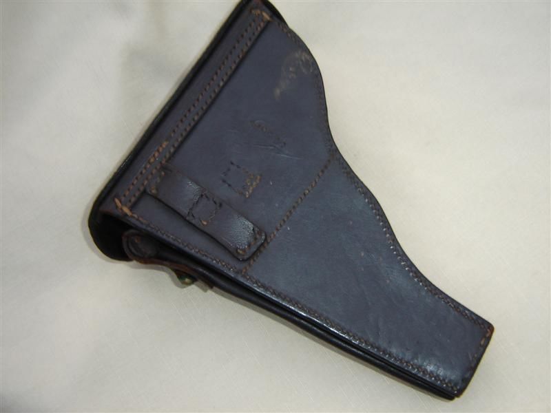

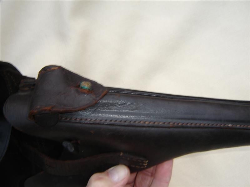

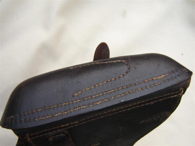

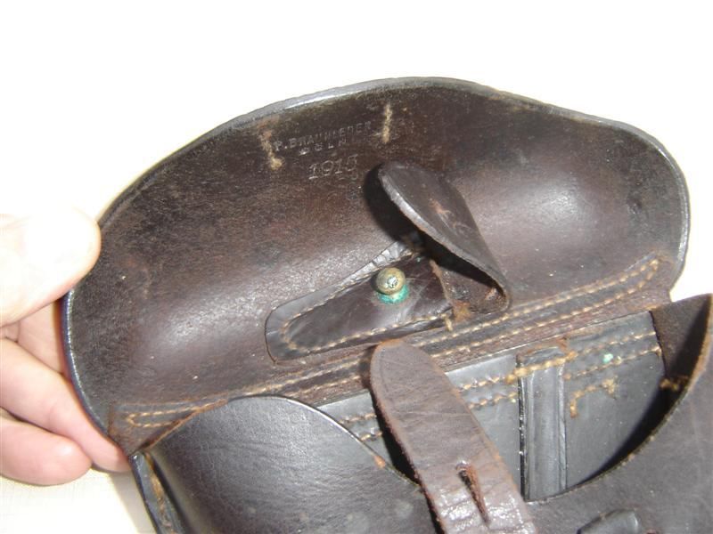

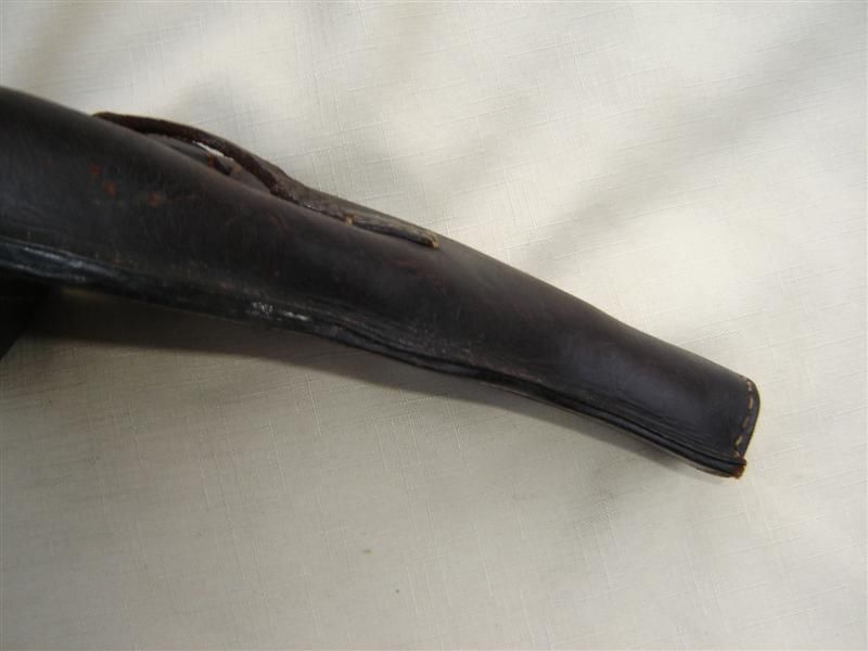

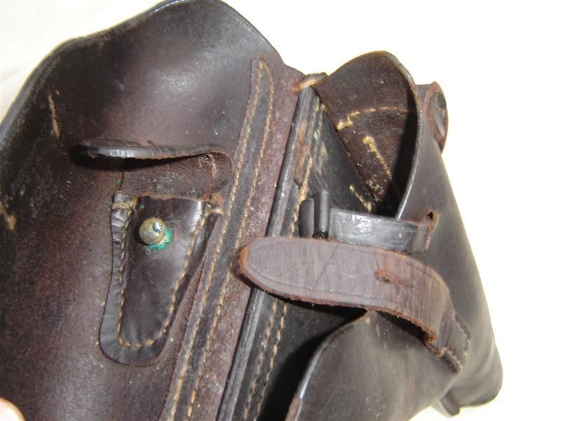

Question 1915 Luger Artillery Holster Converted to Military Standard Luger
Assuming that this was a Artillery Luger that was shortened, would this be an appropriate holster?
