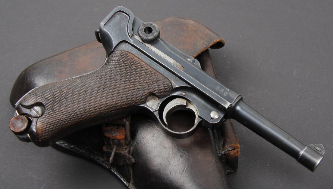

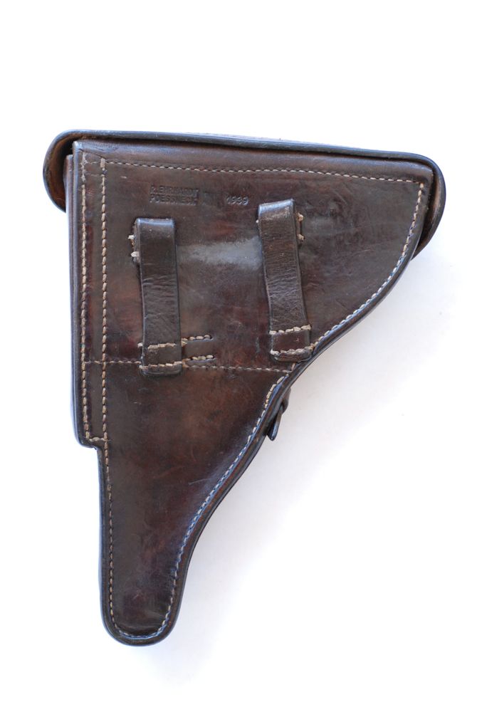

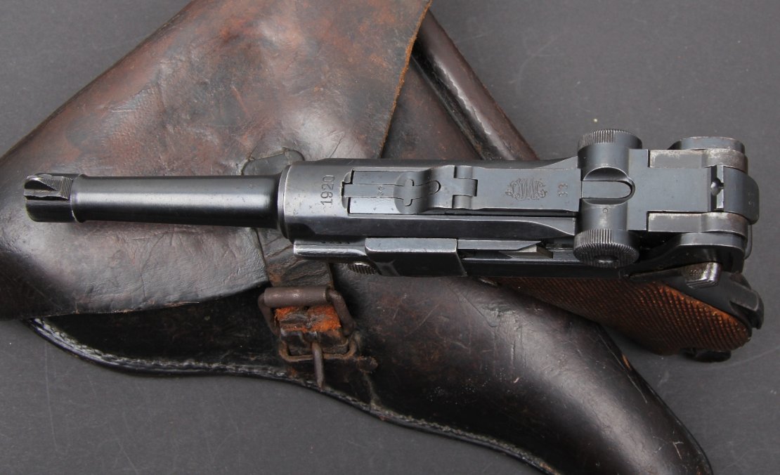

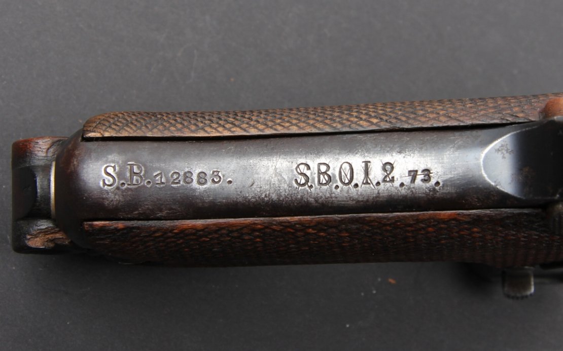

I don't pretend to be a holster expert but I believe that Luger holsters from the mid-1920s are relatively rare. Pictured below is one owned by Dr. Richard Preuss of Germany. It was with a 1920-dated DWM with Berlin Schupo markings that he wished to discuss with me. Since I thought the holster might be relatively rare, I asked and received permission to post his photos.
It is not possible to determine from the photos or by direct examination whether the manufacture date is 1925 or 1926 but, since the holster is of the "new" pattern introduced in 1926, it must be 1926. This would make it one of the first produced in the new pattern. I don't believe I have seen this maker mark before.

I don't pretend to be a holster expert but I believe that Luger holsters from the mid-1920s are relatively rare. Yes, I don't pretend to be either but I know they are!
Very nice photo's and pretty much helps to establish the 1925-6 changeover from the old to new pattern. Thanks Don!

Hi Don and Jerry, I'm a little surprised to see that this holster doesn't have the horizontal row of stitches that secures the inner liner to the back, a feature of the "new pattern" holster.

Norm, Yes..you would think so..This stitching line that secures the inner liner to the back was used on Artillery holsters so it was not unknown. The maker of this holster Don shows is not a large well known maker. It could be the design change was in the development stage and not all of it was incorporated yet..or this maker just didn't get the memo on it.
One other thing of note on this..At one time it had the Police cleaning rod holder apparatus installed in the top. It would be interesting to know if it was original to the holster or installed later..

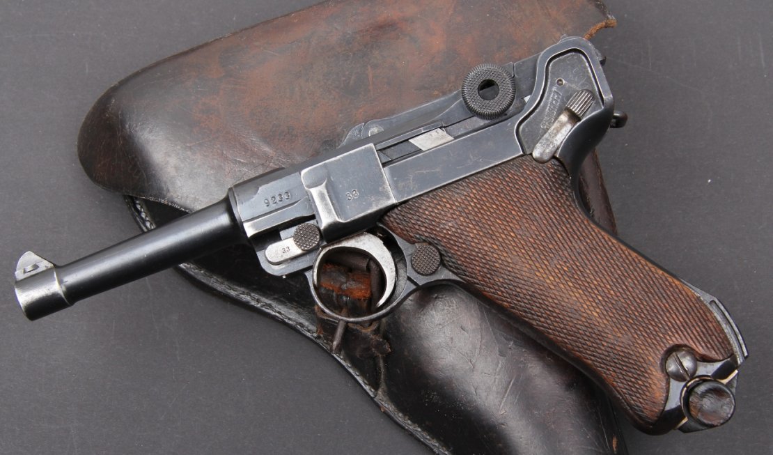

I also thought that I have a Reichswehrholster with later removed pouch of the cleaning rod.
The holster came together with a police marked P.08 - but the pistol leaved the police before the introduction of the Schiwy safety - and went to the Reichswehr - where, may be, it was married with the holster

Doug..I am missing what you are saying? I don't doubt it but please explain? The tool pouch is sewn in a little weird, from the inside it appears to be sewn under the edge of the hinge but from the outside not so much.
One other interesting facet I just noticed..This holster was made as a Police for sure. Take a good look at the shape of the loading tool pouch top. See how short and round it is? This is typical of a Police tool pouch top. The Army type was slightly more elongated and pointed. Enough that you can easily notice this slight variation in shape.

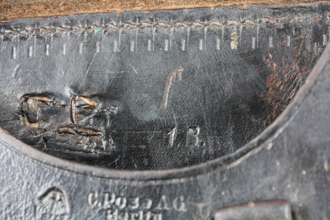

I add one pic showing a marking inside of it: 1.B.
( 1. Bataillon ??)
may be, It's also of interest....
