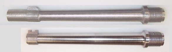

Default 1900 style .30 luger barrel--so far...
Here is a pic of what has been done to the standard configuration barrel so far. I found a local machinist who worked to my specs and a 4 3/4" barrel on the upper of my other '06AE--and VERY reasonably. He also milled me a set of tool steel bars from which to slice individual extractor blanks for the Erma KGP68a.
Ed or Hugh, I cannot for the life of me find the pic of this barrel as it was passed on to me. If either of you still has it, could you please post it here, for comparison? Thanks in advance.

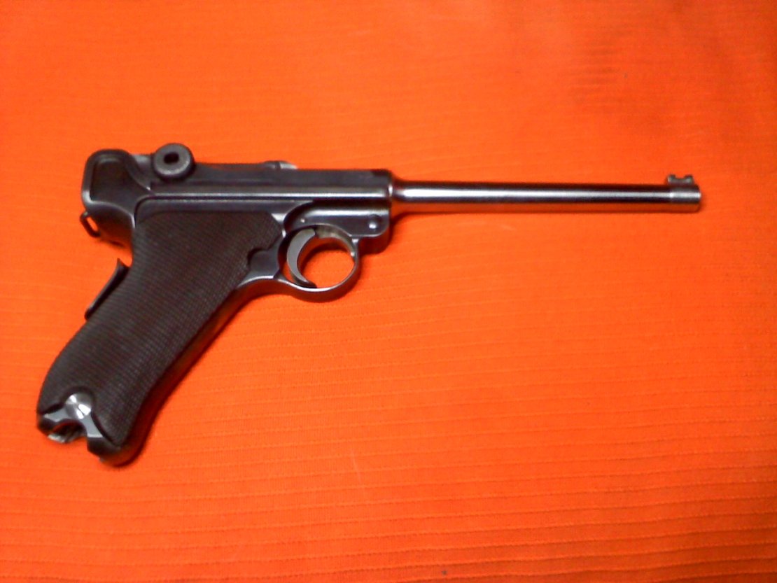

Unread 01-31-2014, 11:28 AM   #16
Dave -
I lost track of this thread...Have you mounted the barrel yet??? Any pics???
How/where did your machinist get a small enough dovetail cutter??? (Or did you use the existing dovetail?)
Unread 01-31-2014, 11:41 AM   #17
Posts: 3,403
Thanks: 7,569
Here ya go, Rich. I posted this pic a while ago but darned if I remember which thread it's in. This was taken before I fit the sight blade, but you get the idea...
The sight block's original dovetail was preserved. I gave my guy dimensions taken from a 4 5/8" pencil barrel on my other A.E. I had him reduce the diameters of the barrel, barrel band. Also removed the ramp at the rear of the sight block to yield the same squared style and dimensions of a 1900/06 sight block. Was it Michaelangelo who said his sculptures were inside the quarry blocks, all he had to do was chip away the excess? This project was like this, an early style barrel was within a standard configuration barrel--we just removed the excess! This is now my favorite shooter; I really like the way .30 Luger feels when shooting.

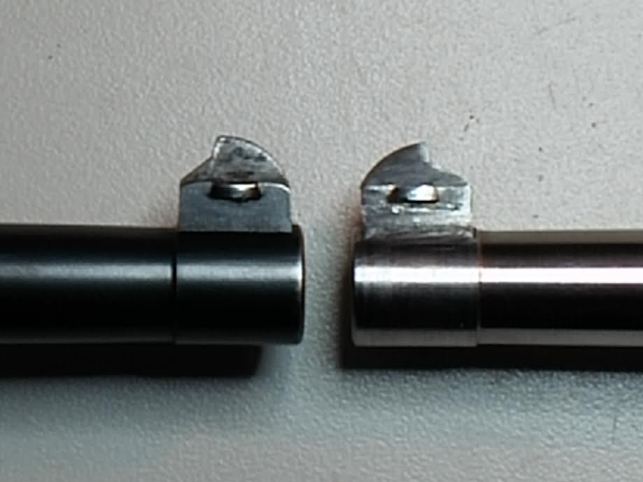

Unread 02-01-2014, 02:08 AM   #19
Posts: 3,403
Thanks: 7,569
OK, on the left is the muzzle of my '06 A.E. long frame with 4 5/8" pencil barrel and proper style sight blade. On the right, we have the 6' pencil barrel in question. The sight blocks on these stick up higher from the barrel band because the early barrel bands aren't as big around as the later barrels. The distance from the center of the bore is, I contend, the same to the top of either sight block! The dovetail area of the modified barrel is undisturbed. Still needs a little cleanup...
Since earlier posts, I've decided not to worry about trying further to make it mimic a Navy-- turns out I'm happy enough with a 6" American Eagle.
