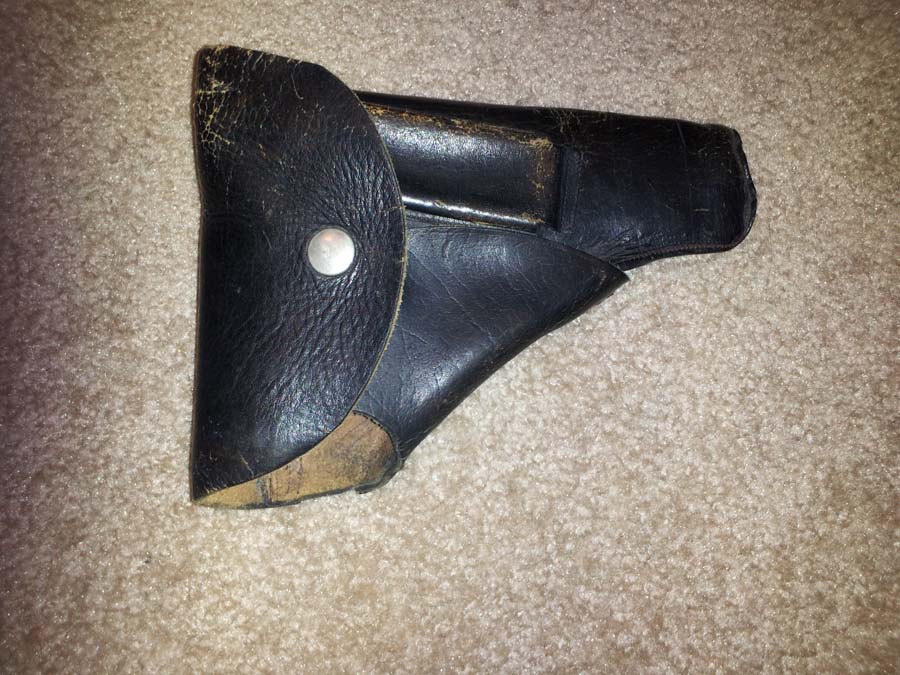

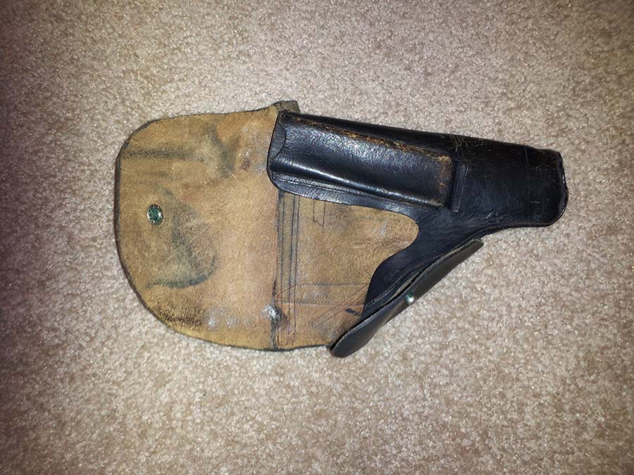

Below are the pics of the holster that came with it, nothing special but cool they even made the effort to make those for it.
