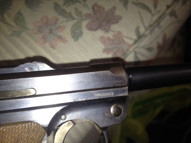

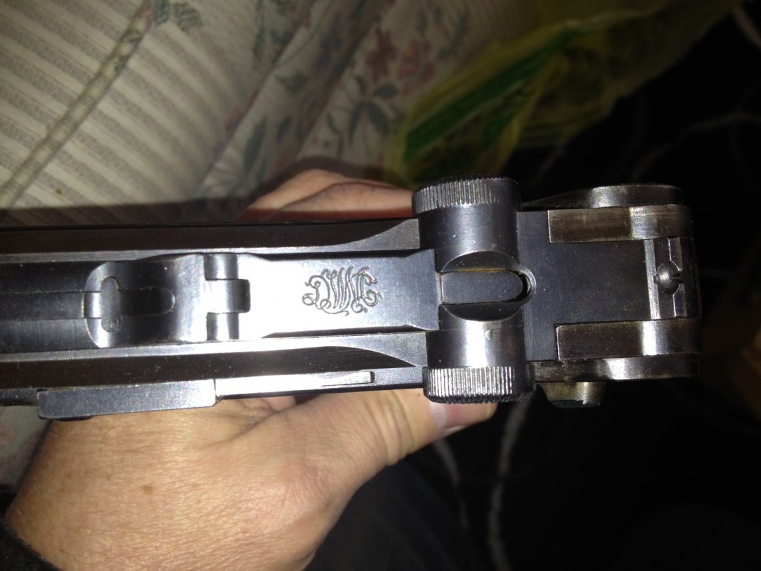

I am a little confused as how to ask a question on this site. My Grandfather was a merchant marine (US) in the 1920's. The past is a bit shaky as some of the Family was from Austria prior to WW1. His Luger is now in the hands of my parents with the intent to hand it down to me. Funny thing is he Spoke German and was fluent in it but had No accent when he spoke English having spent most of his life (if not all) in England and the US. He actually spent 1 year in prison in London as a suspect for the Lusitania sinking! Anyway the Luger has the DWM marking as well as a small crown with a N under it on the barrel with a 747 under that with a mark that looks like a 7 jammed next to a backwards S. it is a 9mm, the piece has the original wooden tabbed clip and seems in really great shape. My dad fired it for a clip or 2 and it is in perfect firing condition. Any help getting the age of it would be appreciated. I am trying to get and estimate of value for insurance purposes as i am not planning on selling it.

You Grandpas Luger is what is called "Alphabet Luger", a commercial model. It means it is a Luger produced by DWM (Deutsche Waffen und Munitionfabriken) after 1921/22. Until that date, serial numbers for Commercial pistols were consecutive and, by then, were at the 92,000 range. After that date, they changed to the military numering system of 10,000 guns blocks followed by a letter suffix - this is your Luger.
Yours bears the "GERMANY" stamp and that means that this gun was already made for the US marked. Commercial pistols chambered for 9mm Luger are uncommon, as most were chambered for .30 Luger (a.k.a. 7,65 mm Luger). Your pistols seems to be in original condition, with a good amount of bluing and strawing.
I'm sure others can add more and a precise evaluation.

As stated by Douglas, your grandfathers Luger is a DWM Alphabet commercial (formerly known as a 1920 commercial). According to Jan Still's Weimar Lugers, it was made in the second half of 1924. The letter under the serial # is an 'n'. It is a suffix and is part of the S#. The full S# is 747n.
Very nice family heirloom.

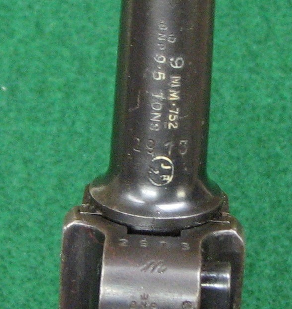

It is my understanding that if purchased in the UK it would have the UK firing proof on it...IOW, somewhere on the barrel it would have stampings like the attached pic...If it was purchased legally...

Gun Collector's Digest #5 had an article on British commercial proof. Those long text of how many TONS etc on barrel was post 1955. The BNP stamp was introduced in 1955 as well. Before 1955, they used other text.
The 1955 rule is copied here:
-- NOT ENGLISH MAKE was eliminated
-- The viewmarks were eliminated
-- Birmingham proof and nitro proof combined into BNP
-- Caliber, cartridge case length, pressure added
