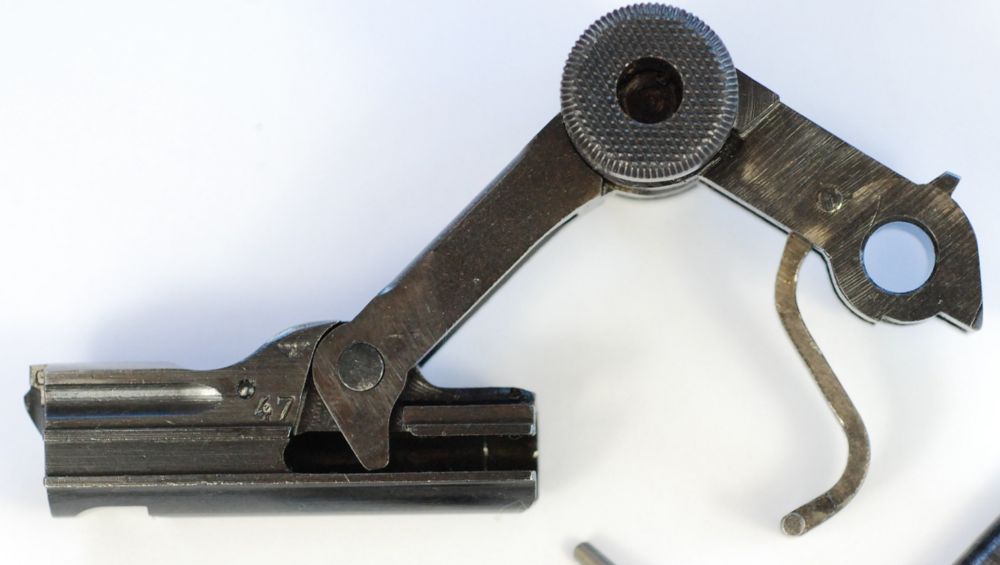

Unread 07-26-2011, 02:45 PM   #13
Hi Ronnie, Is the breech block (front toggle) numbered to the gun? It's numbered on it's left side, as shown in the photo. If it is, while not exactly the Louisiana purchase, I think this gun a bargain at $650.00. Regards, Norm

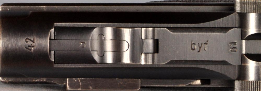

Unread 07-25-2011, 04:48 PM   #14
Can anybody also chime in on whether the extractor should be numbered to the gun at this late production date?
Unread 07-25-2011, 05:08 PM   #15
Hi Doug, My 42 byf has a numbered extractor, but it also has the same clumsily finished side-plate as Ronnie's (see photo). With the exception of that front sight blade, I think the gun is OK and well worth $800.00.
Hi Ronnie, In your first photo I notice that the magazine is not fully inserted. Was it this way when the gun did not hold open? Regards, Norm

Unread 07-26-2011, 07:51 AM   #19
Front sight looks vaguely Finnish...Are there any markings on the barrel???
Unread 07-26-2011, 11:20 AM   #20
AMBROLA
Join Date: Jul 2011
Posts: 23
I took the gun apart this morning and the hold open is not even there?
The markings on the barrell are serial #6558. Should I look for anything else? I have to do something today.
Here, I just snapped some pics???
