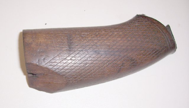

My Gasser grip has a chip out of it; it chipped with the grain, pretty much in one plane...
I'm wondering how to graft a piece of wood in to repair it...
Sand/rout it flat and glue a piece on with as little glueline as possible showing??? Shape the new piece to fit the existing contour and let the glueline be what it wants to be??? Dovetail a new piece in???
What kind of adhesive??? Glue??? Epoxy??? Polyester resin???
Shaping it afterward should be pretty straightforward...and it will always look 'fixed'...so what would a period armorer/smith have done to repair it???
I've seen gunstocks with some elaborate wood repairs [Enfields]...
How would an Austrian or German have repaired a chipped grip???

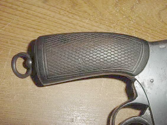

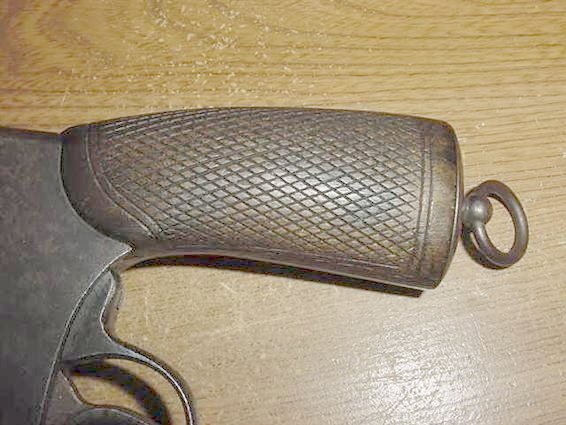

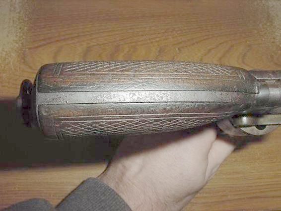

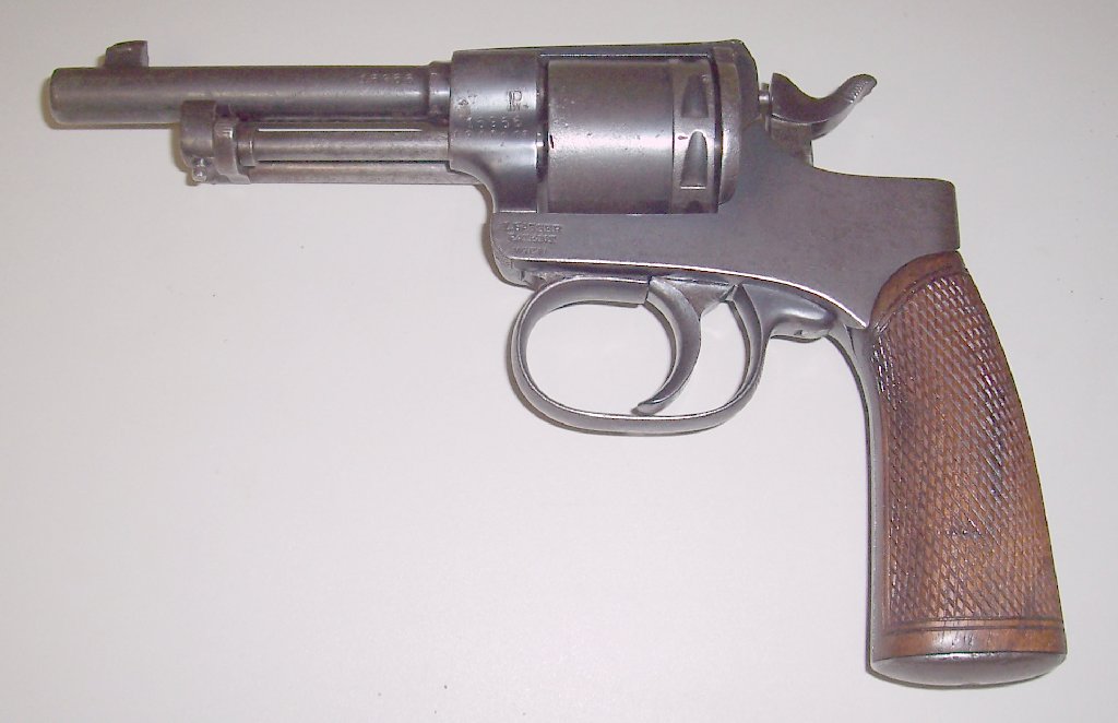

Thanks for your comments! No, I haven't tried 'fixing' it yet...
I established, from various pictures of excellent condition Gassers, that the 'checkering' was more like 'lining'...the checks are flat topped, not pointed, and the 'checkering' was lines cut into the grip...and the checks were double-bordered...
I could never even begin to touch up that type of checkering...So I was thinking of maybe perhaps asking you if you would be interested in giving the grips a look and seeing if you could re-trace the original 'checkering'...(and fix any chips, too)...
Here's a couple pics of a good condition grip to illustrate...
(BTW: Gasser grips are not symmetrical)

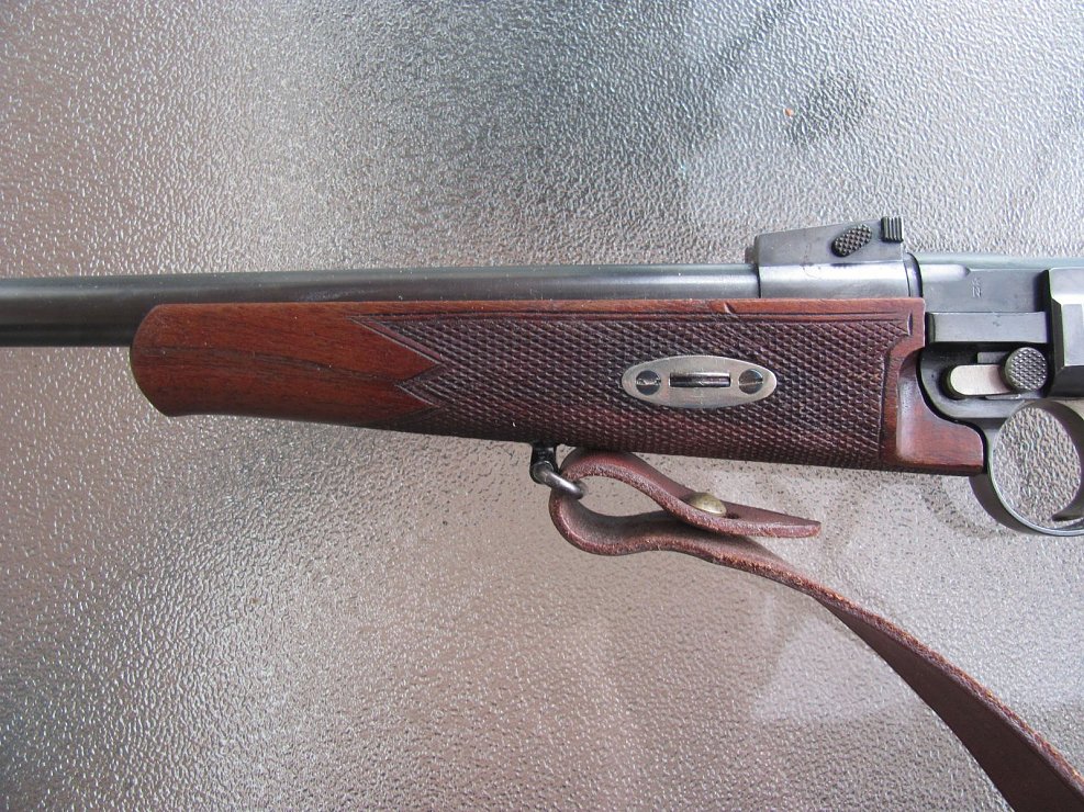

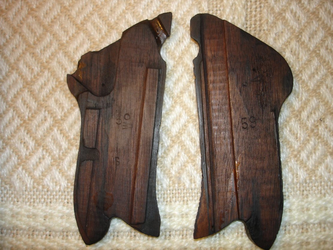

Gerry turned me on to Hugh who repaired a chip in my luger carbine grip, Perfect, can't even tell there was a repair. Super reasonalble~~
Unread 07-04-2011, 03:57 PM   #13
suum cuique
suum cuique's Avatar
Join Date: Aug 2009
Posts: 497
Thanks: 108
Thanked 47 Times in 35 Posts
Hugh repaired my Luger grips which had two pieces of wood chipped off and recheckered them. After they came back they looked like new!
Hugh did an outstanding job!
I can highly recommend him
Regards, Andy

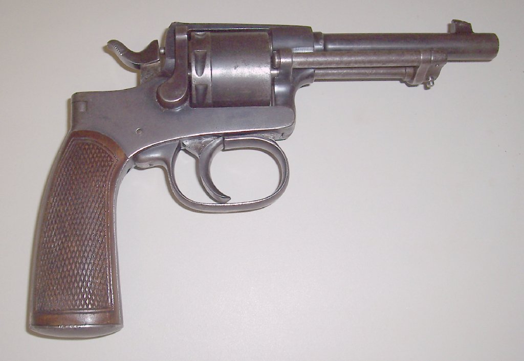

Got my grips back from Hugh today...Checkering/lining looks excellent; chip repair is unnoticeable...
I'll let you guys judge...
