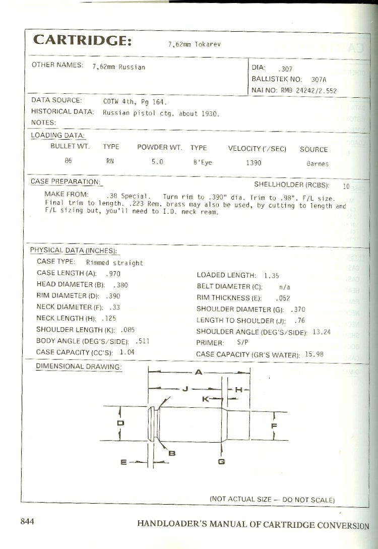

A comparison on paper of the two.

FWIW, you could post the same measurements from 2 different Tokarevs, or 2 different Mausers, or 2 different 9mm Parabellums and get the same kinds of variation due to different manufacturing tolerances.
Dimensionally, the Tokarev and Mauser rounds are basically identical and inter-changeable.

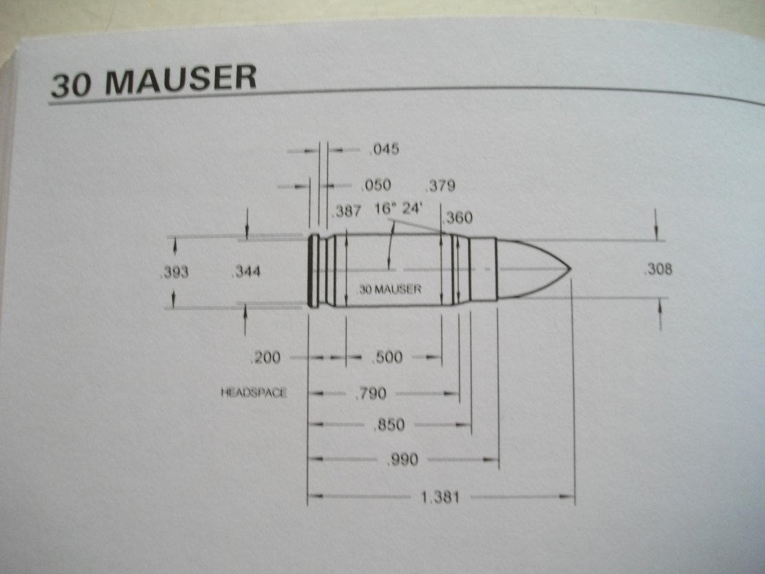

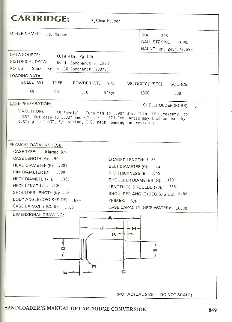

Jon & Patronen -
I get all my measurements from The Handloaders Manual Of Cartridge Conversions, by John Donnelly. Donnelly did not measure or inspect all the cartridges he lists (one per page, 1054 pages), he copied reports from various sources, the principle one being Cartridges Of The World, which is where data on all three 30 cal cartridges commented on here were taken. The data in this book concerns the shell, not the load or bullet.
Personally, I believe the cartridge manufacturers and reamer manufacturers/distributors have, over the years, combined differently named cartridges that have dimensions within manufacturing tolerances under one name. (Or, conversely, mark the same reamer/cartridge with different marks).
A good example is that 24 minute angle addition to the 16º neck angle shown on that diagram. I seriously doubt that any manufacturer is going to hold to that exact dimension...

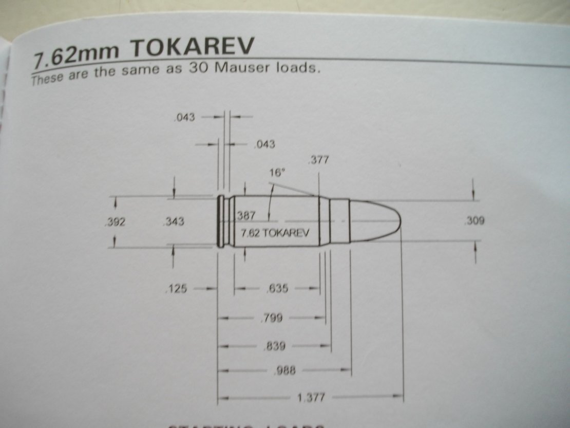

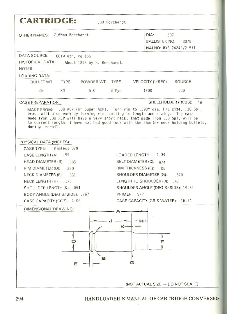

jonnyc, my manual shows the Mannlicher cartridge case being straight, not bottlenecked...
Here's the other three; data taken from Frank Barnes' Cartridges Of The World 4th Ed [1980] for all three...
There are some differences; whether actual or typos, I don't know...Caveat emptor...

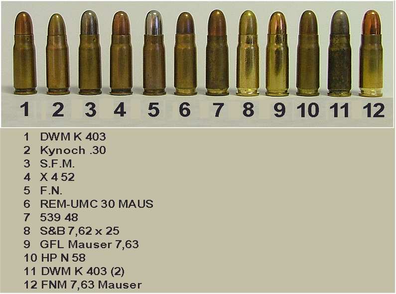

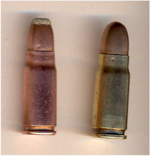

Here is a little line up I did a few years ago, listing the usual suspects
And a scan of a possible Borchardt round, next to a DWM 7.63 Mauser round.
