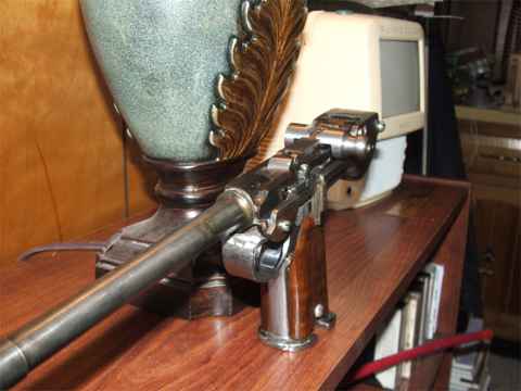

I have spent many hours searching the net for info on the Borchardt, to help me with my building. Came across some pics on the web, HK94.com, of one supposedly captured by 'Coalition Forces'. Anyone have any info surrounding this? Curious if it was actually a shooter. Looks like it would make a great story! Bill

Photos of the Borchardt that was found in Iraq was posted on one of the forums a while back, but I don't recall when or where it was posted. It was in less than pristine condition but was still functional. I don't know if it was successfully removed from country or if it ended up destroyed (I doubt it...GIs are pretty resourceful!)

It was on the HK94.com site. What's been driving me nuts is trying to figure the construction, mounting, etc. of the extractor! There was a pic showing it( the Iraq model), which appears straight compared to the early luger extractor. I wanted to build something to shoot! Obviously, whoever found it had some idea what it was. I almost bought one 15 yrs ago or so from Shattuck. Unfortunately, lost 2 grand 'cause I couldn;t come up with the balance.......another $2000! So, it was out to the shop..

Unfortunately the drawings don't show any detail on the breechblock/extractor that I can tell anything from. I have copies of the instructions, plates of the parts, etc., but, the extractor is so small can't make anything out. I've even been looking for 'parts', thinking an early luger extractor would give me an idea. The one missing link.....! The breechblock also has 2 holes on each side of the extractor......have no clue what these were for. Wish someone would write the book on the Borchardt! Bill

The original thread appeared on a subgun forum, but that link (I found it) is dead now.
Luckily the photos are still there:

Vlim, those same group of pics show the best close-up of the extractor. I know it's rectangular but don't know if it's pinned from the side, mortised partially in from the front...or what!

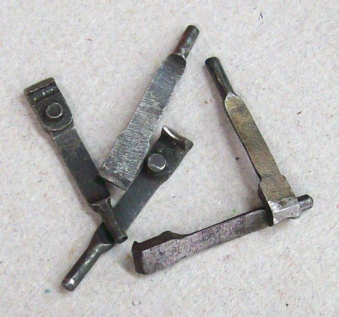

Bill,
The Borchardt extractor is made just like the 1900 Luger extractor...one piece spring steel that inserts into the hinge part of the breechblock and is retained by a lug on the bottom. It is just a bit longer than the Luger extractor.

Like this?

Yep.
