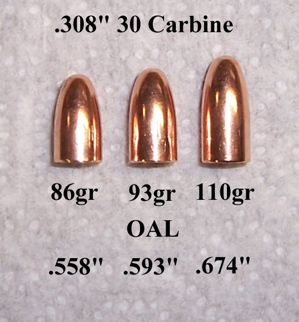

I thought it was in this thread, but I don't see it...Anyway, someone commented on milling the bullets instead of drilling them...I couldn't do that with the drill fixture (holes are too deep) so I made a new fixture...
Two strips of 3/8" aluminum drilled & pinned and then top & bottom milled flat. Four 5/16" holes drilled with a .022" plastic strip as spacer between them, to allow for clamping.
Fixture with four .110" dia M1 Carbine bullets clamped in position. I milled every .020" and weighed between cuts. The final measurement was .115" to get a ~86gr bullet.
Final weighing before starting run. 86.2grs...Close enough!
Comparison of 85gr Tokarev bullet, my shaved 86gr carbine bullet, and 110gr carbine bullet.
I chamfered the bottom edge with a file to ease loading, but I think I will make a 'cap' that will press a round edge on the bottom...
I also want to make a run of 95gr cut-down carbine bullets...

Ran some more Midway .308" dia 30 Carbine FMJ bullets through the mill today...Made these ~93gr, for the Luger...
I'll call these milled bullets 'shavetails'...
First two are 'shavetails', last is OEM Midway 30 Carbine...
For more comparison, a Sierra .308"/85gr was .536" OAL, and a Tokarev 'pull' was .307"/85gr and .542" OAL...
I thought I had a 5/16" radiused edge end mill, but I can't find it, so I'll have to make do with a chamfered-by-file base on my 'shavetails'...
