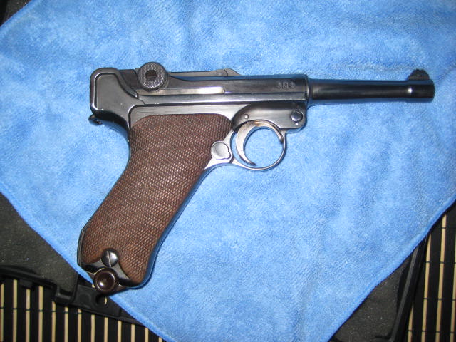

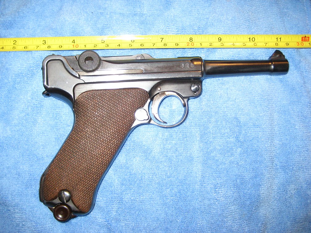

Hello all, I received this Luger from my dad a few months ago and have a few questions.
It is 9mm
I know the drop down lever is wrong, a gunsmith said it may be off a Stoeger of the same era...or re-made.

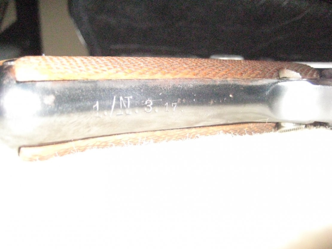

Also, I don't have a pic, but I would really like to know the meaning of the numbers on the metal frame between the grip, below the trigger. Mine shows: 1./N.3.17.
Any insight to my gun, history, etc...much appreciated! Thanks, Phil

Hi! Welcome! Can you provide a clear picture of the unit markings you are asking about on the front gripstrap?

That is a tough pic to get! See below...Phil

Also, here is the best pic I could get of the numbers on the inside handle frame , below the trigger. What does this represent?

the takedown/locking lever looks really well done and I suspect it is one of a kind
does the takedown show any signs of the exterior lever having been welded or
perhaps threaded/pinned to the inside cylindrical portion of the takedown part ?
exterior part of the takedown may be from a donor non-luger gun safety / locking part
closeup of the right side area on slide proof marks near the barrel mount would help identify luger
my guess would be early post WWI police issue , and has had a reblue at some later time
thanks for sharing !!!

As Clark mentioned, the markings you asked about are most likely unit markings.
Your Luger is a mix of parts from several guns. The forward toggle has DWM in script.
In 1921, DWM was only permitted to manufacture commercial lugers (for private sale, or police departments).
A very small number of Military proofed Lugers with the 1921 date were manufactured by DWM.
You need to re-photograph your Luger without using a flash, and in indirect diffuse light.
Use a tripod, and set the camera for closeup photography.
Clearer sharper pictures will help.
On the bottom of the barrel, get a picture of any numbering. Same thing on the front of the frame above the trigger guard, including any suffix letter that may be there. Is there an "a" or "b" suffix letter on the front of the frame under the numeric portion of the serial number?
I do think you have a particularly nice Wiemar era Luger!

The grip strap marking is a Reichswehr unit mark from the Weimar period post 1922. It indicates 3rd Kompagnie, 1st Nachrichten-Abteilung, Waffe 17...an intelligence organization.

It is a DWM made gun new in 1921, not a refurbished one (see the Weimar acceptance markings) that went to an Recihswehr (army weimar era) unit as George put it; 3rd Kompagnie, 1st Nachrichten-Abteilung, Waffe 17...an intelligence organization.
At some point it was either very well worn or had some pitting and it was reblued, most likely in the USA.

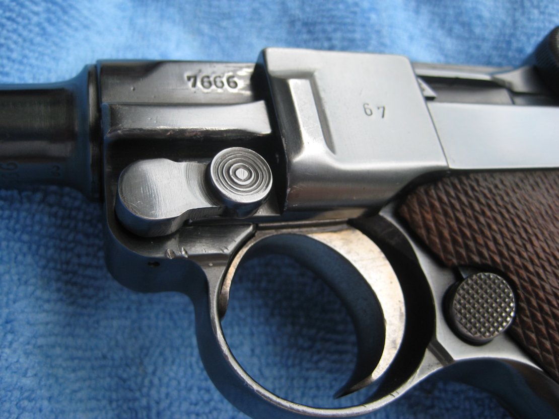

I think the takedown lever is a very well gunsmith or machinist made replacement... or repair of a takedown lever that was damaged.

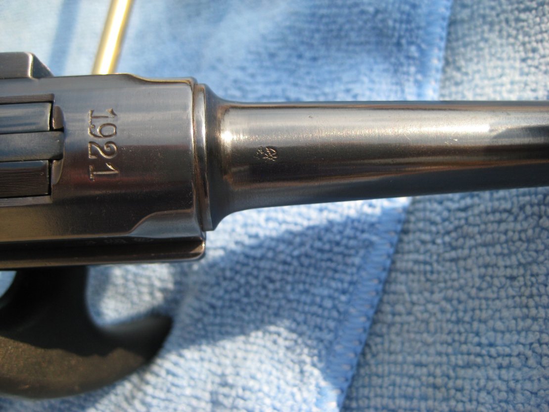

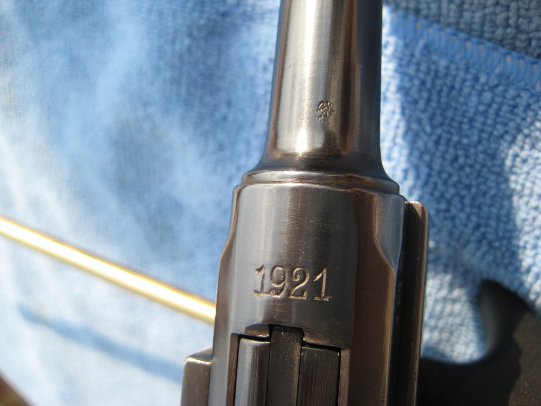

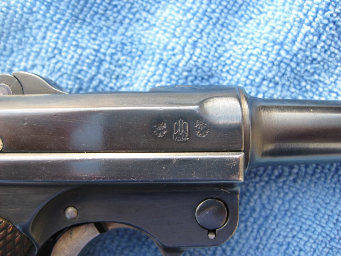

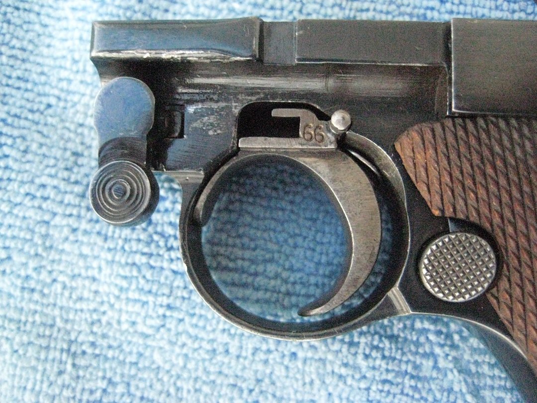

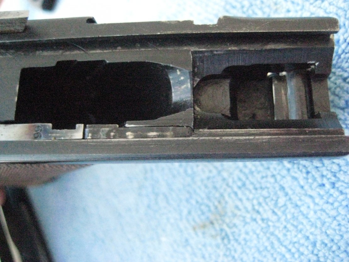

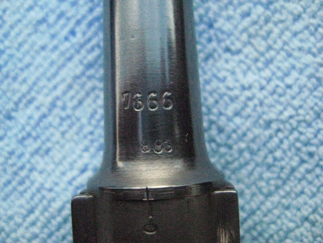

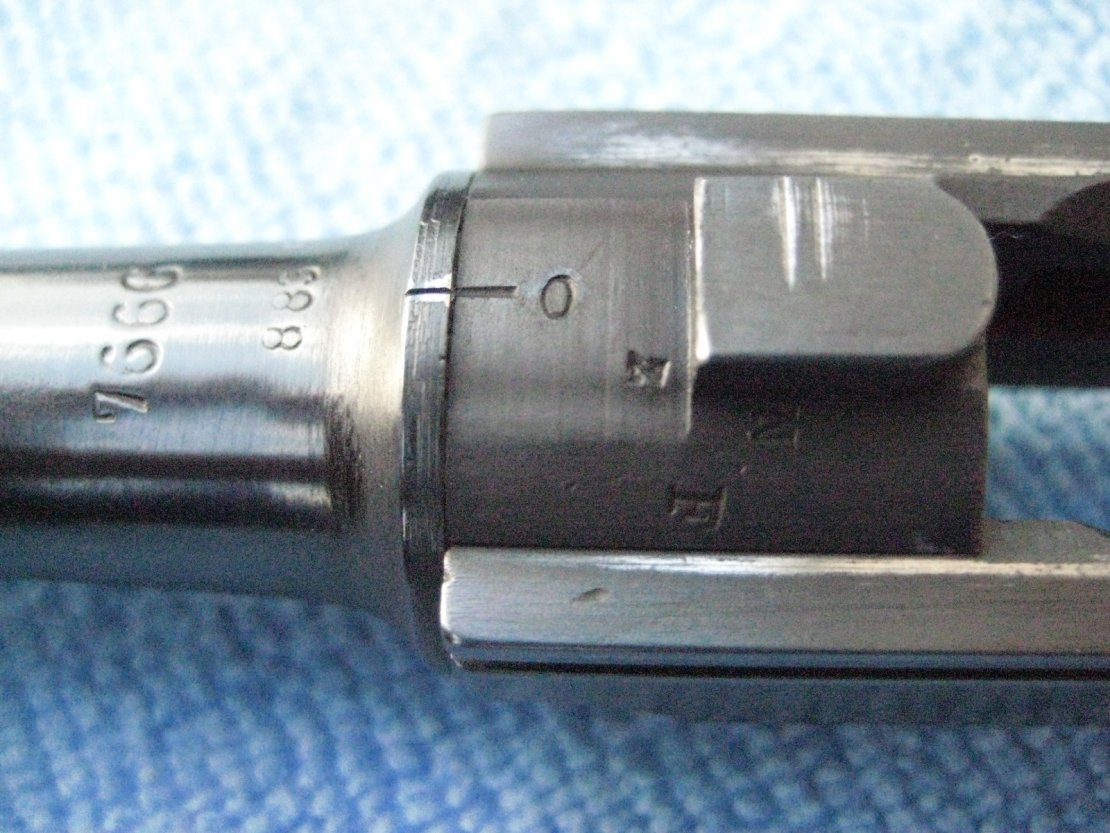

Here are some better pics I took after I got back from the range...it fired like a champ! Any additional information on the markings shown would be greatly appreciated...the info on the "unit markings" on the grip metal was fantastic..Thanks...Phil

Hi Phil,
The "8.83" on the barrel is the barrel gauge - 8.83mm from land to land.
It looks like it has been refinished using the "salt" bluing process then buffed. Your gun would have originally been "rust blued" at the factory.
The markings on the right of the receiver are the proof marks applied as the pistol completed major stages of testing and acceptance. "WaA4" refers to a weapons inspection office. This gun is of the period of the Wiemar Republic.
Your much better pictures are much more helpful...

Phil,,can we get year specific ( I thought the 1921 wasn't a manufacture date)? Just curious...
You might be confusing the 1920 German property mark, 1920 is NOT a date. 1921 IS the manufacture date on your pistol.
Marc says in his previous posting..A very small number of Military proofed Lugers with the 1921 date were manufactured by DWM.
Ed says in a previous post..It is a DWM made gun new in 1921, not a refurbished one

Yes, as you can see, I'm new to this gun and forum. I have received some conflicting info and am just trying to sort it out!!! No hard feelings! Below is a reply on "The High Road" I got a few weeks ago:
The 1920/1921 dates don't necessarily mean refinished guns or ones made from parts. In 1920, the Weimar republic passed a law banning private ownership of military weapons; guns that were surrendered in compliance with the law were marked with the date received, thus showing legal ownership by the state. Later, those guns were issued to the military or police like any other guns.
Many thousands of military pistols were refurbished and converted to 7.65mm (because making pistols in 9mm for commercial sale was also illegal) for sale on the world market to obtain desperately needed hard currency. But those have all receiver ring markings removed and are not dated. They are, incidentally, good pistols and the ".30 Luger" is a dream to shoot.
phil.luger is offline   Reply With Quote

No way to tell the year the gun was made, since the original date has apparently been removed. (It was not made in 1921; that date is explained above.)
It probably dates to the years of the first World War, but it could be any year from 1908 to 1918.
Unread 09-23-2010, 12:22 AM   #18
Phil, Whoever told you this poppycock is misinformed.
It probably dates to the years of the first World War, but it could be any year from 1908 to 1918. This idiotic statement can be easily refuted by looking at the proofs shown on the right side of the reciever/top slide rail.
If it were 1908 or 1918 these proofs would be intirely different than they are or in the case of 1908..on the left side.
guns that were surrendered in compliance with the law were marked with the date received. Not true. Guns that were under state control were marked 1920 as a property mark.
Hard feelings? None here, we are mind numbed robots.

Thanks for the reply...as I've said, I'm just learning! I tried to take the best pics of the drop down (inside and out) to help you experts figure out how, why and what, got it on this gun...a gunsmith thinks it may be off a Stoeger of the same era...I have not been able to find a pic of a similar representation...or if it was machined...when? who knows!
Again, thanks...I'm attempting to put together the best history of this particular luger, as accurately I can...shoot it every month or so and pass it along in no worse condition! Phil
