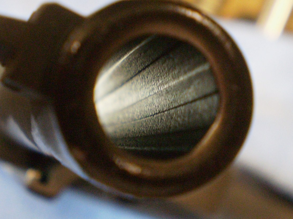

My 7803 seems to be a "Shooter" having had a makeover in its past. Any way to correct the indescretion or are we commited to crossing the "River Styx".
I'll post a couple of bore photos for critique if you don't mind to
discuss its condition. Bye the way I have appreciated all the responses. Very Interesting! I seem to have a 100 year old piece of history that I will cherish for a long time.

RE bore: I've seen worse that shoot pretty well. Clean and brush it from the breech with your favorite cleaner. Then do as if you're breaking in a new barrel. Shoot one, swab, shoot one, swab. After 7-8 shots run the brush again, and then a patch. Repeat. Then standard cleaning when you get done.

The bore is in reasonably good shape for its age and the fact that it has been used and not a safe queen... I would bet it would shoot great.

The bore is "frosted", with sharp lands and grooves. I've seen bores in much, much worse condition that shot like new. I doubt that you could ever tell the difference.
