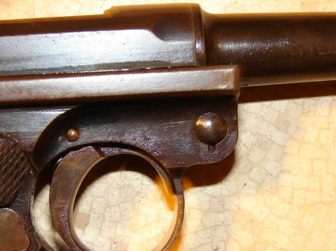

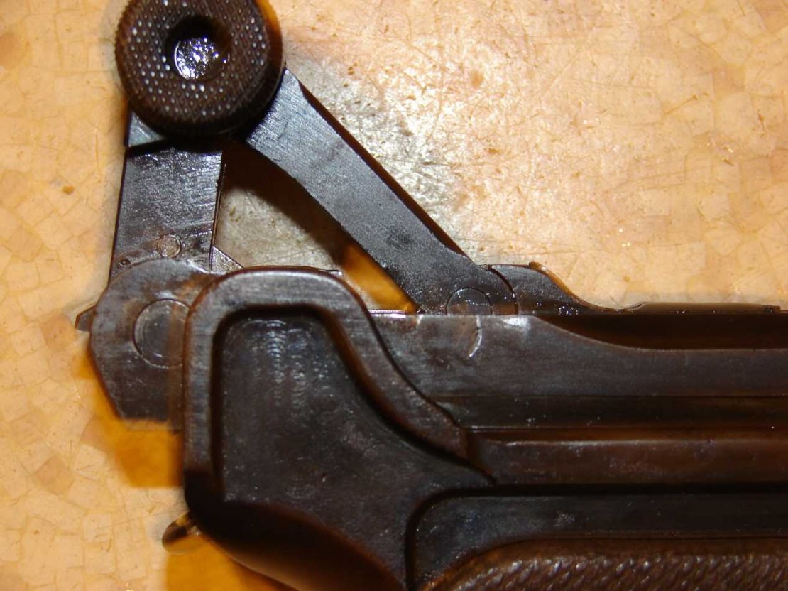

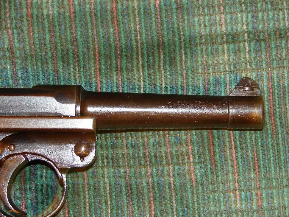

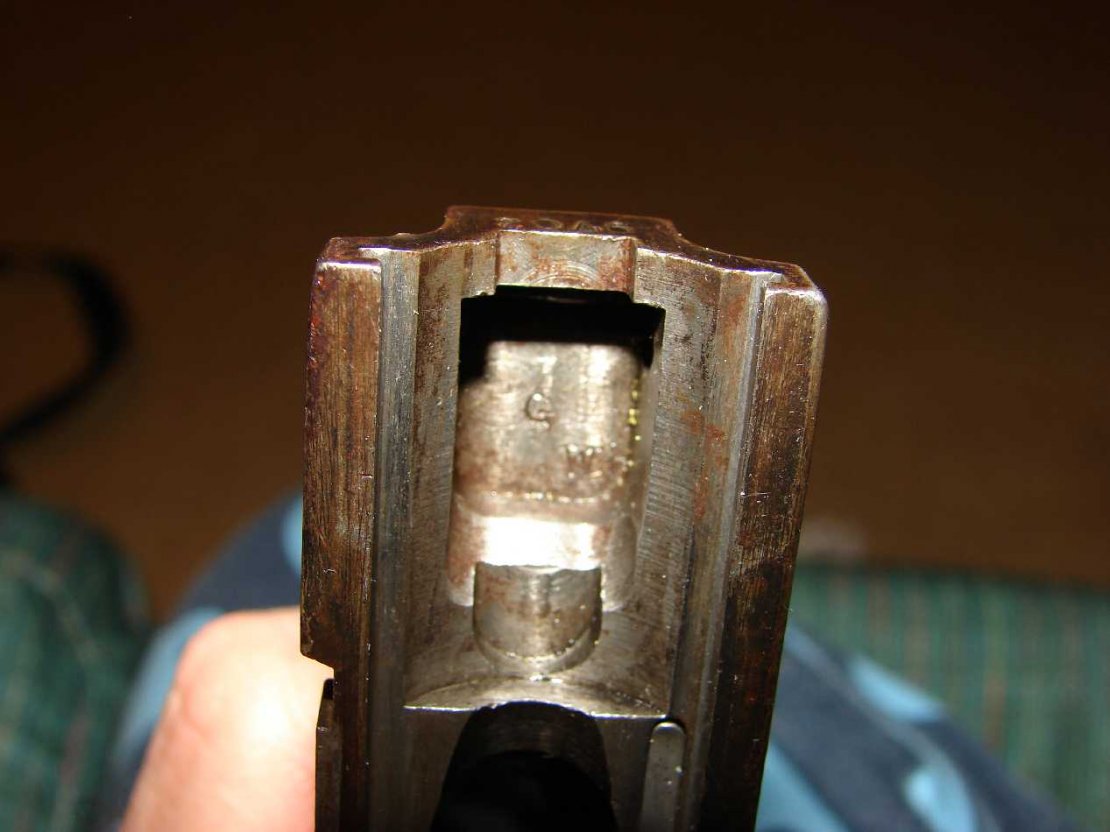

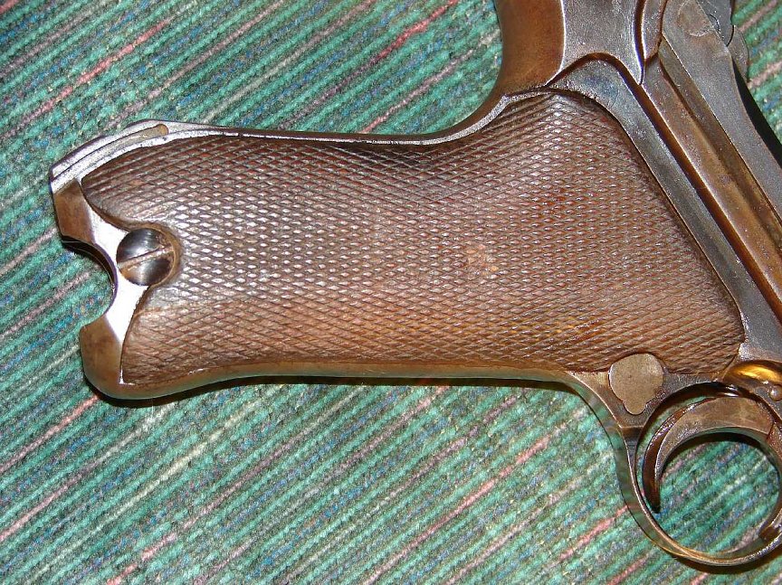

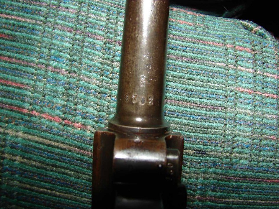

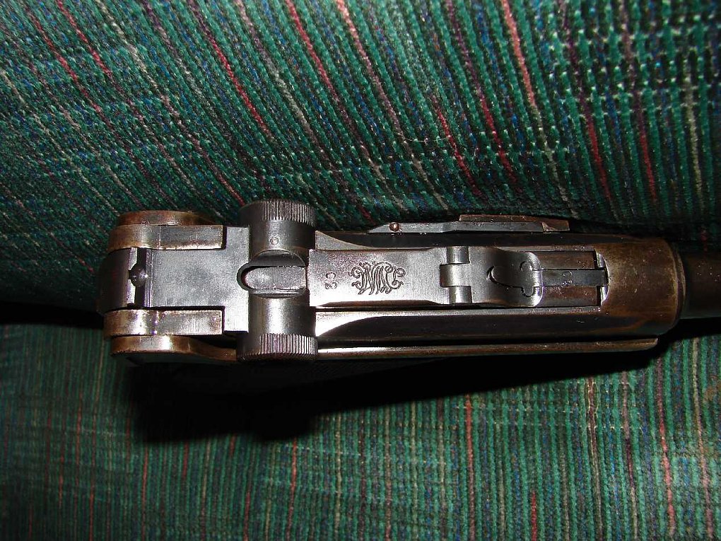

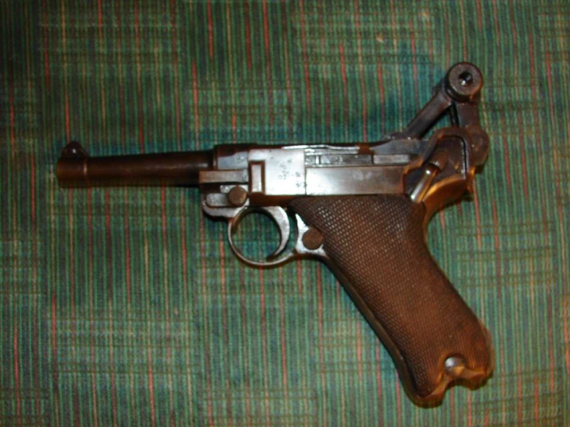

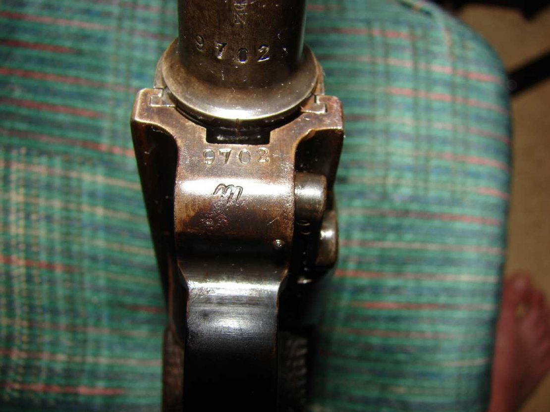

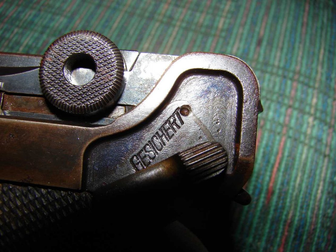

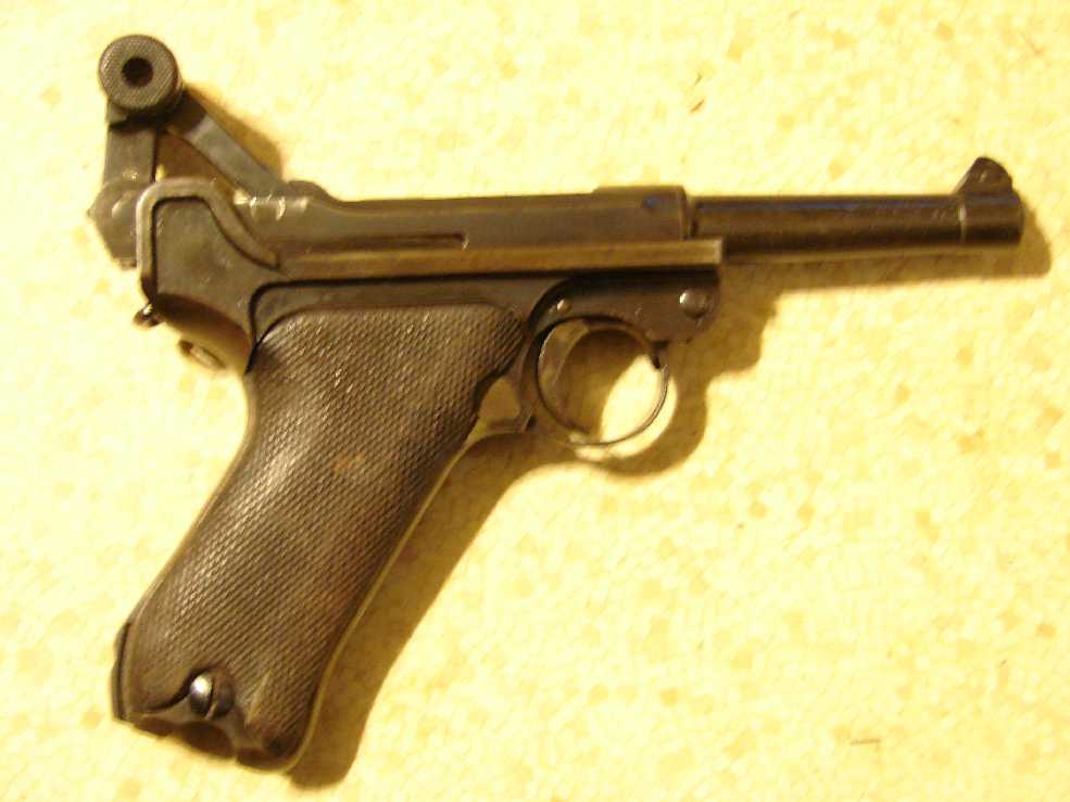

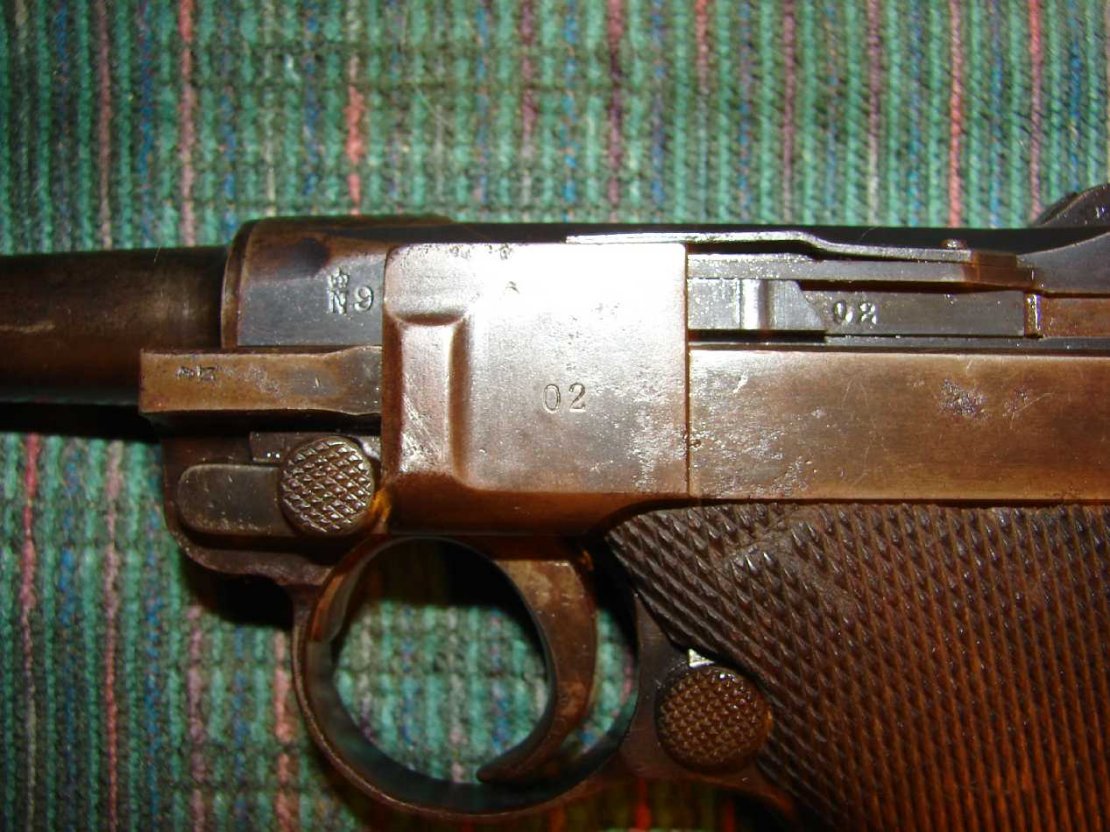

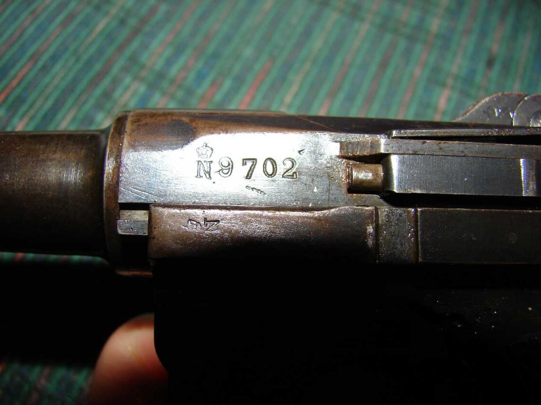

Here are some pictures. I hope they are good enough to tell me something about this gun.

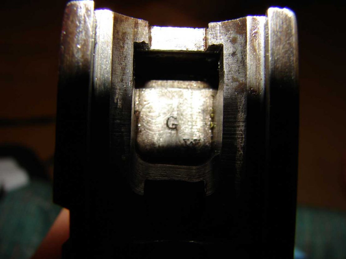

A few more that may help.
Thanks in advance for any help dating this piece and hopefully finding out what it is worth.
All parts match the 02 of the 9702 serial number except that I can't find any numbers on the grips. Neither of the mags match.
The guy who brought this gun home used an engraving pen on the underside of the bolt and on one of the mags.
I also wonder if some of the parts have been 'touched up' on the blueing.

Yes, It appears to be the alphabet series. The whole serial no. is 9702m. This was made from the last quarter of 1923 til the start of 'n' series in mid 1924. Your's would have been towards the end of the series, so probably spring of 1924.
I have one just like it, 200 numbers lower. Mine is a 7.65mm aka .30cal Luger. To check this see if a wooden pencil, the eraser end, will go down the muzzle. If a 9mm, it will pass easily. If 7.65 it will be tight or not go at all.

Mech..An honest valuation of the pistol in this condition would be perhaps $500-600 at the most. You don't show the magazine if any.

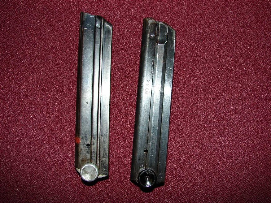

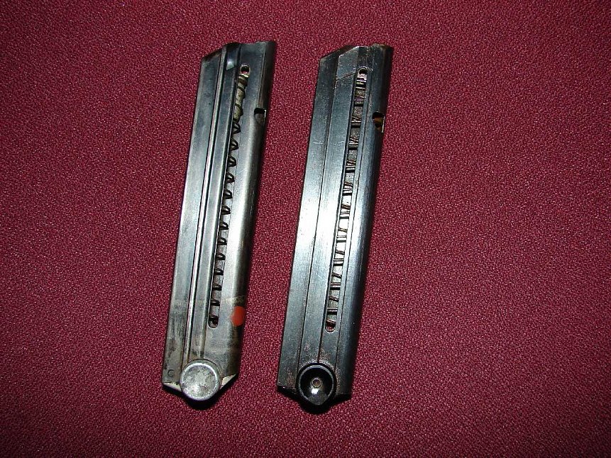

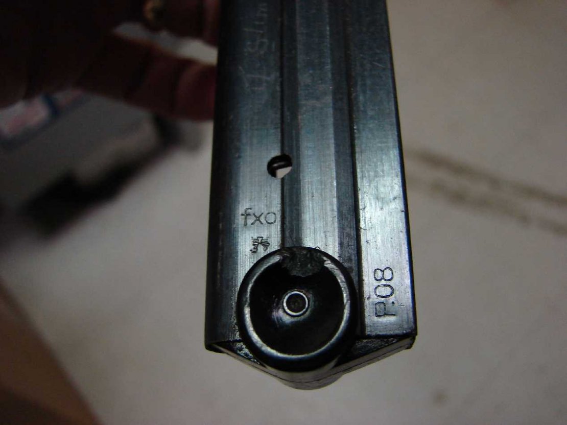

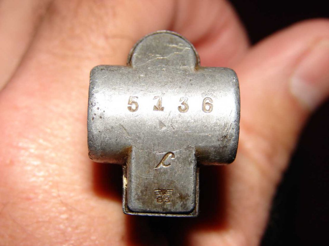

I'll put up some picts of the two magazines that came with it this evening. Both are missing the follower button. One has a black bakelite base. The other is aluminium wit a number that doesn't match the gun.

It is definately 9mm. I've fired it.
The number is actually 9702. Now I understand what the 'alphabet' reference means.
Thanks.
Any guess as to a rough value?

It has seen a lot of hard use. C heck with the dealers: Here's one. They refer to it using the older nomenclature, 1920 commercial. Take off about 25-30% for the business mark-up.

Police sear safety.....is the front grip strap stamped ?

Nothing stamped on the front of the grip.
What do you mean by 'police sear safety'?
mechdriver is offline   Reply With Quote
Unread 09-29-2009, 09:29 AM   #15
You will find a spring steel bar riveted to the upper receiver above the sideplate. This was a police requirement that prevented the gun from firing once disassembled.
(Lugers can actually be fired when apart by pressing in the sear bar with your fingers)

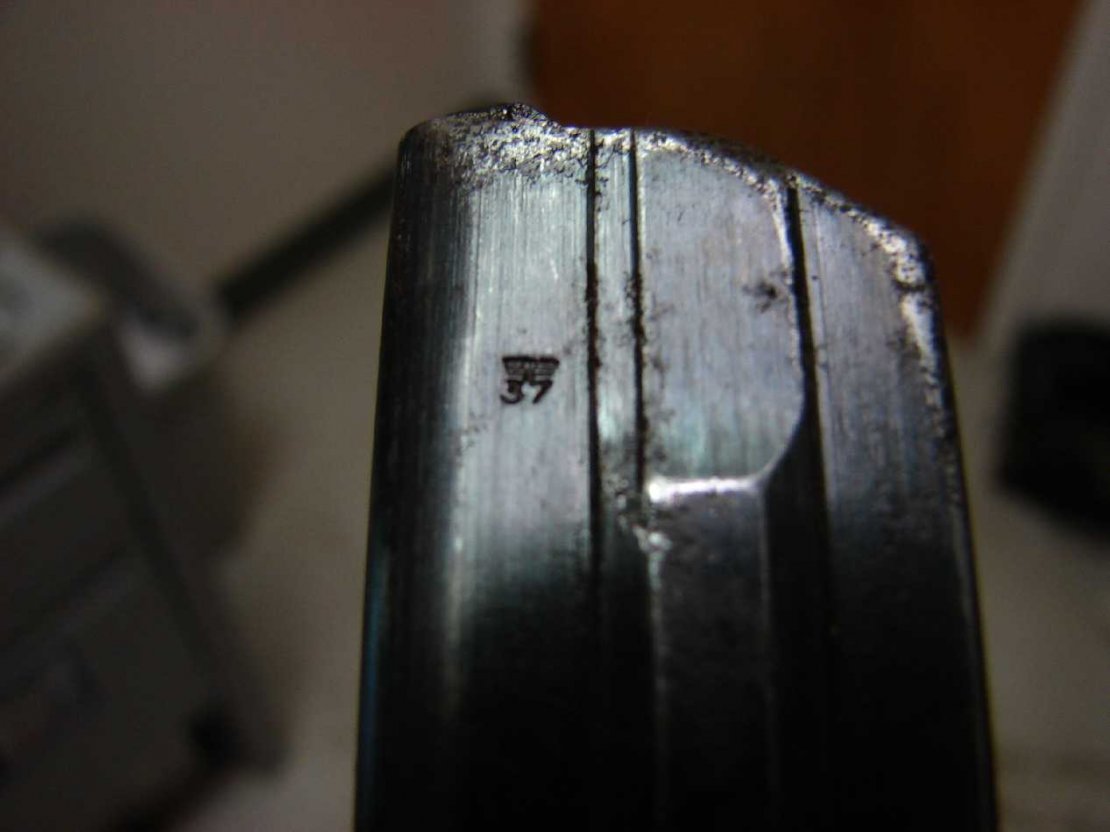

Default Magazines that came with my DWM
Didn't get them on here yesterday.
They are both missing the follower buttons and I am going to get GT to take care of that.
What else can you guys tell me about these mags?
Also, do all grips fit loose on lugers?

In regard to your question: "Also, do all grips fit loose on lugers?"
No, they do not all fit loosely. But it does seem that a lot of them do, even on the expensive ones.
One solution is to put a very small rubber "O" ring under the grip screws. Sometimes this works.
