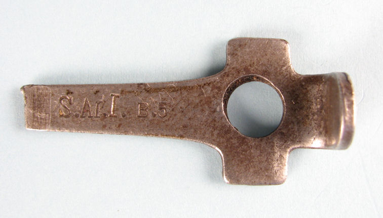

Here is my tool that I have;

Don, I was wondering too, then realize he stated "a 1920 DWM".....
I was reading an article entitled "The Luger (Parabellum) Schraubenzieher from 1900 to 1946", and in that it states:
"Tools for the Schutzpolizei Arnsberg were produced in a separate batch and have unique measurements".
It is a nice addition to any collection.
Richard

Ed, the marking on your tool is an earlier Type 1 marking probably from the Schupo command at Dortmund. It is listed in Table 7-10 of HWIS.
