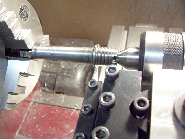

Unread 12-25-2009, 09:40 AM   #20
I was wondering if anyone had a picture to share of a "setback tool" for use with new Luger barrel installations.
Yes; mine is shown below...
Is this tool meant to be used manually or in a machine?
I prefer the pocket-sized carry-around model...
You're certainly feeling frisky this Christmas morning...Kids get you up early???
