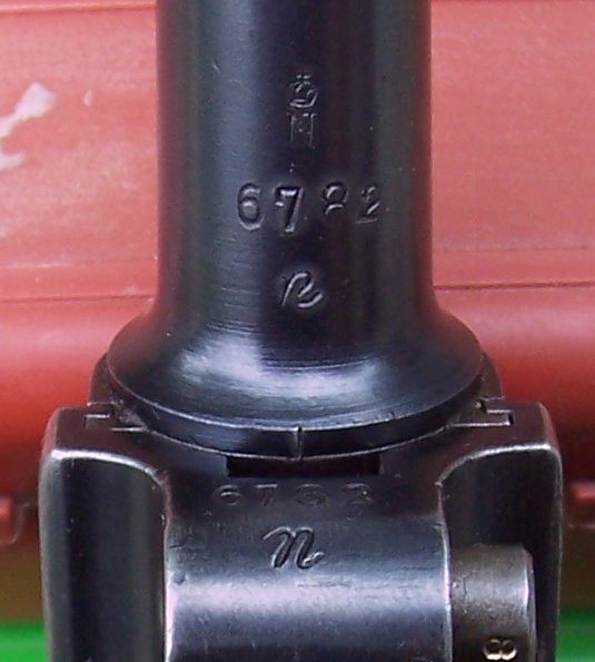

And since it *is* the first two of my ser #, that would seem to indicate that it is "original" and not force match...

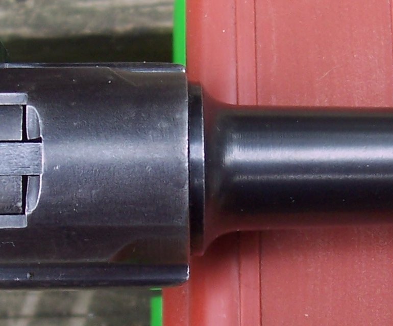

However, after reading several threads here, the witness marks on barrel/grip frame are quite obviously two different strikes, and the font of the "n" is different, both indicating a re-barrel...

Doesn't look like it's been rebarreled to me.
Unread 06-28-2009, 10:53 AM   #8
I think so. Here are my clues to this -
1. Front sight blade not quite right length (too long)
2. Fonts different barrel-to-frame
3. Bluing different barrel/frame
4. Witness marks don't line up
5. Witness strikes at different angles - two separate strikes
Witness marks, front sight blade can be seen above - bluing & fonts below...
Also - Chamber end of barrel is raw steel; my other Luger (S/42) has blued chamber end of barrel...

Rich,
The barrel crown should be in the white on all rust blue variations. Your S/42 must be made after mid 1937, which is when they started to salt blue everything... small parts which were previously strawed, internals and barrel crown.
I've noticed the font difference on all of the 'n' suffix Alphabet commercials. I don't know why.
Mike C.

I still assume the barrel of this gun was replaced. Witness mark is questionable, and that's not alone. The color of the barrel and receiver is so unbalanced. The quality of the job was super, indeed, probably a "reconditioned" Luger done in the factory. I don't know how German installing barrels. It must be installed using a special tool which US gunsmith do not have -- they could install it once without leaving marks (original gun), then they could install it twice or more times without leaving marks (reconditioned gun). Looks being a factory reworked gun.

Hello, about all that I can offer is that the serial # on the barrel appears to have halos (a GOOD thing). In the same photo the witness marks appear to be in alignment. Need a better shot of the witness marks. The mag is a MecGar (made in Italy cost ~ $30) , I have one in ALL my Lugers. Gotta say, those grips sure look nice. I'd upgrade from my Alphabet Commercial to this one if I could. .30 cal is a drag on the market as ammo can be priced at $1.00 a round (Fiocchi is ~1/2 that) unless you are a reloader. Old-timers say the .30 is more accurate and has more penetration than 9mm. I've had 9mm bullets stick in 1/2" plywood shot out of a 16" barrel at normal pistol ranges. Nice looking pistol, I'd give you $800-900 for it after an inspection. Best Regards!! JOE

Barrel is a darker black than the rest of the pistol...and the rear slant of the front sight isn't lined up in a straight line like my other Luger barrels...

Here's a shot of the witness marks. Also of the front sight, you can see where the "step" is.
