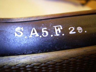

hi there,
got a 1921 dwm, s/n 8xxxx (5digits, no suffix) with an unit marking
S.A.5.F.28.
has anybody an idea about its meaning?
as far as i know during this time no unit markings should have been done during that time (new order in 1922 then).
its a bit dubious for me.
besides it is reblued, gun seems not to be a fake.
thanks
klaus

Without being able to see it. I think it is a Reichswehr marking for:
Sanit�¤ts Abteilung 5 Fahrpersonal weapon #28
Can you post some clear photos of the pistol?
What are the proof marks on the right side of the received?

I'm still not sure of which order you are refering to. I have six Reichswehr 1921 unit marked Lugers. Reichswehr unit marked Lugers are kind of scarce. Only approx. 8-10 thousand were procured by the Reichsheer.

the unit stamp

ron,
im reffering to the instruction from 1922.
your unit stamps showing all the "/" in their syntax
so it is correct.
company/regiment.weapon-nr
the stamp of my luger shows the unit stamp, how it is made during ww1:
regiment.company.weapon-nr
and this is, what i do not understand: the old syntax, which is used.
regards klaus

Not all Reichswehr (post WWI) unit marks have the /. Yours is correctly applied and is legitimate.
All of my 1921s have 4 digit serial numbers without a letter suffix or with an a or b suffix. Yours is one of the mysterious 5 digit S/Ns with the 8 added.
There have been discussions on this in the past. I think the general thought is that the 8 was added after some type of refurbishment or rebuild.
