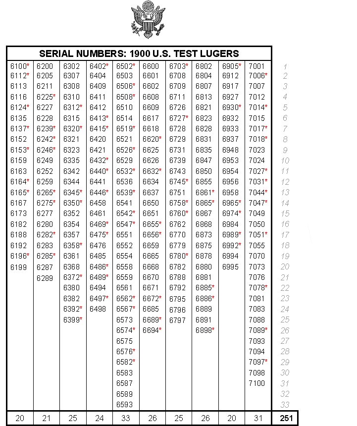

Test Eagle 6984 was for sale at Ralph Shattuck's table at the recent Reno show. Is this on Ron's list?

yes, here is Ron's "older" listing;

Thanks Pete and Ed, Happy Thanksgiving to you both (also Ron). What are the red asterisks for by some of the serial numbers?
Unread 11-24-2005, 02:41 PM   #10
Those were originally on the Bannermann sales list (I think M. Reese noted those as well on his List...).
Unread 11-24-2005, 03:27 PM   #11
Actually, they aren't the Bannerman purchase numbers but are the numbers originally listed by Mike Reese in his book as known surviving Test Lugers. That is the list that got me started recording surviving Test serial numbers and the list has expanded considerably since then!

Did the list of TE Reese listed in his 1st. edition book grow in number to the guns listed in his 2nd. edition book ? I do not have a copy of his 2nd. edition. He only lists 34 TE lugers in the 1st. edition.
I have the 1st. edition (hardback, special 1000 book issue, book # 6336) and wondered if more TE's were added to the Reese list at the 2nd. printing...your red *'s total to 85 or so...so I assume the Reese list in the 2nd. book did grow.
Unread 11-25-2005, 02:09 PM   #13
Pete,
I don't have any books with me, but I believe he eventually listed around 85 or so Test Eagles in his last printing.
Unread 11-25-2005, 02:23 PM   #14
He lists 90, but limits himself to a range between 6100-7097.
