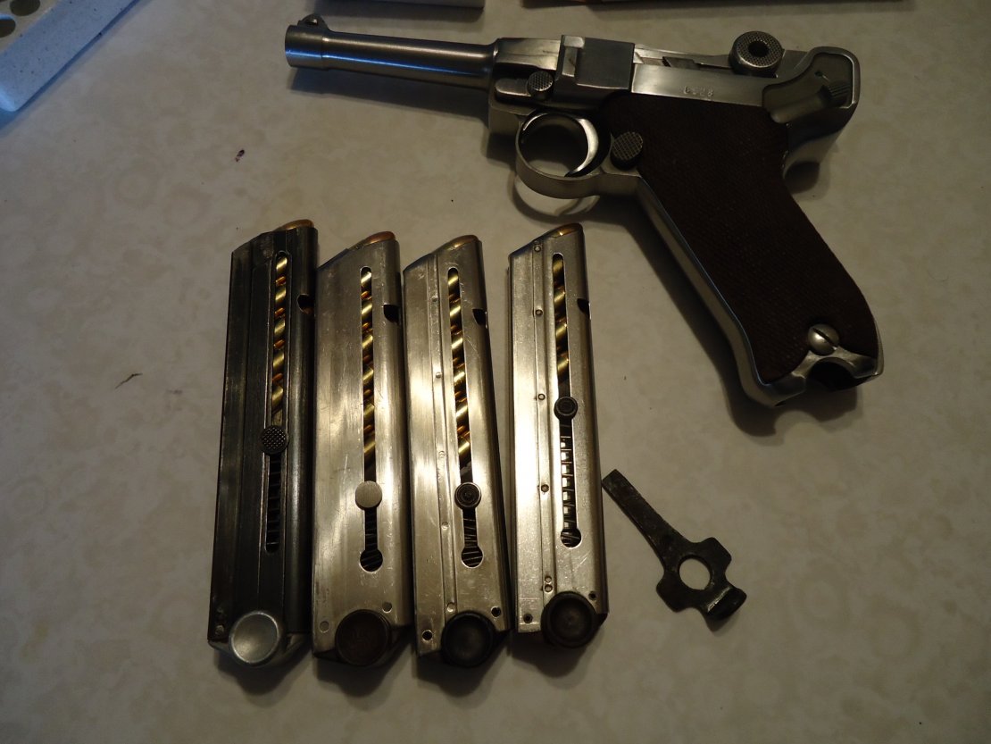

This is a 1993 Stainless Steel American eagle i had once owned a few years ago. Today reowned it/lol. Made by spm houston texas, ss and all numbers match/lol. before it seemed to be finicky and prone to various problems common to these pistols. After reowning it and some cleaning and tuning it has worked rather well in firing today only a few problems showed up. I do think this wil be a keeper this time around.

It was fired today using the winchester white box ammo and the factory mag plus two triple k mags and fxo world war two mag. There were no failure to feed or eject issues with any of the mags. only once did it fail to lock open on last round fired with the factory mag. so it does well with even the older p08 mags it seems. there was one issue with with the trigger not resetting once. All total eight mags were fired total without a feeding ,jam or failing to eject. I am starting to believe that someone may have tuned this pistol while it was with another owner. anyway it works and apears to shoot well now.

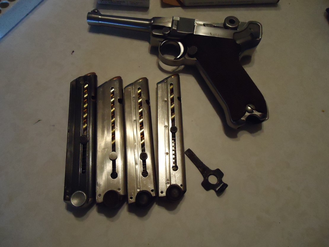

I am thinking i may have found a nice shooter . It sure does not act like the gun i owned a few years ago

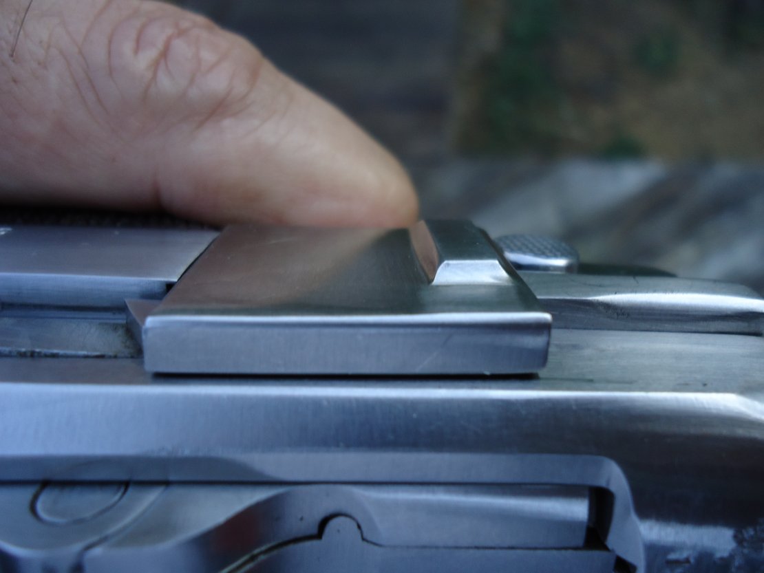

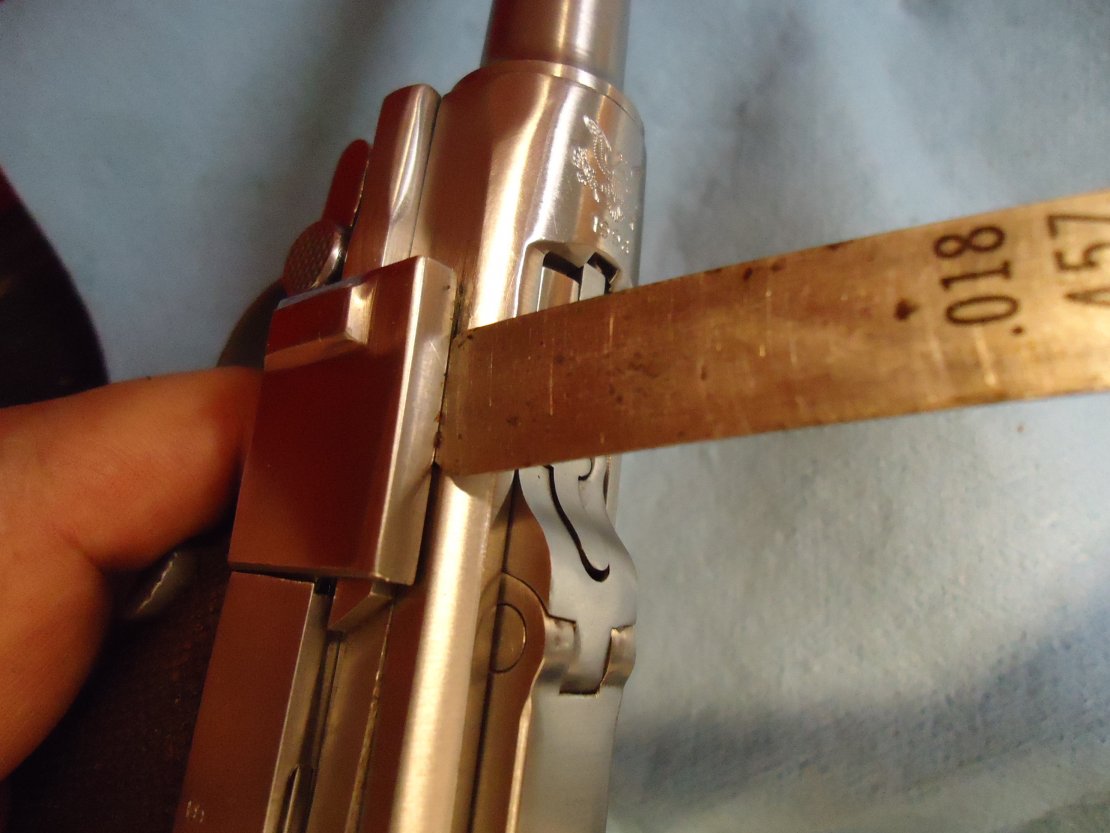

I do not think i have ever seen a side plate with this much movement or gap. The gap is .018, not really sure how to correct this, it seemed to work fine yesterday till it was fired over forty times .

thanks, thought about it. it is so tight now when the locking bolt is engaged you have to use the take down tool to desengage it. Without the upper installed there is very little movement. Like i said now you have to press on the side plate yo engage the trigger bar, now when the trigger is pulled the triger bar and spring wil start to bulge out.

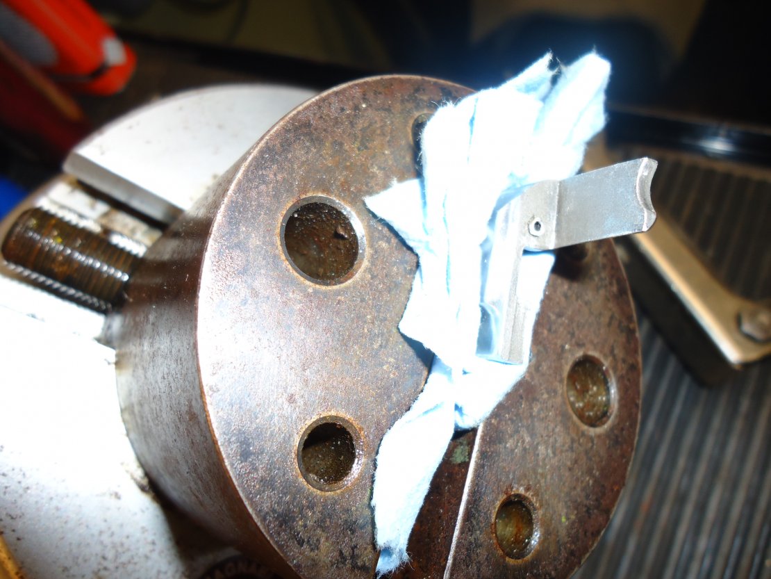

Support the body of the side plate in a padded vise with tang sticking up to receive the tapping (also with something non-marring). Tap the tang in the direction that would tweek the front end of it away from the frame. This works to take up the play in the side plate by leverage. The pivot point is the front edge of the side plate's body. Raising the front end of the tang makes the back end of the side plate rise more when the locking bolt is swiveled over to lock things down, snugging the small flange on the back end of the side plate body more firmly into its slot in the frame, directly behind the side plate.
Strictly speaking, your side plate will be .018 out of parallel with the frame; or it may actually end up exactly parallel, since you have adjusted it back to its original position. Regardless, you will have no looseness whatsoever when you are done. The disappearance and reappearance of the problem after shooting some rounds...? Sure, a gun heats up a little after 4-5 mags, one right after the other, but I can't see this affecting the side plate. If the issue goes away and comes back, unconnected with any adjustment, then I'm stumped. If so, perhaps there is some mechanical instability with the assembly that is not obvious--maybe something amiss with the fit of the side plate flange in its relieved area on the frame?
Don't worry about bending SS and breaking it. It is 'tougher" than carbon steel, not harder. It displays more "spring back" than carbon steel, and usually needs more displacement in bending to wind up in its new shape/angle/whatever. It will eventually stress break, but will generally endure back and forth bending significantly better than carbon steel. The slight bending of the material involved in these adjustments, coupled with the material's resiliency and the infrequency of bending applied, will reduce the likelihood of breakage to near nil.
I hope this is clearer...

I think these pictures will show pretty much the procedure for adjusting the sideplate. just clamp the side plate in a vise or in my case an engravers block and tap the tang, in my case outward away from the frame . this did the trick there is allmost no movement that i can tell in the sideplate, will try to fire it tommorow and see it anything changes. Like we have said over and over again the ss spm/aimco american eagle lugers are a different breed of luger. this one was made in 1993 and apears to havea low serial number. For now everything seems to be working ok on it. Not sure i would want to ever own another one, but i have owned this one twice/lol.
